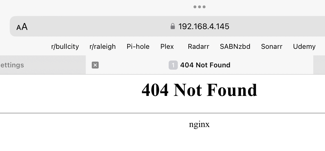

inspectornorse Posted January 5, 2023 Share Posted January 5, 2023 Greetings, In lieu of yesterday’s certificate server outage I noticed that I was also unable to access my Unraid server’s WebUI by its IP address. I can access my server via the URL now that the certificate server is back online, but I still cannot access it by IP (as it seems my peers on other Unraid servers, can). Attached the diagnostics and screen shot. Thank you deathstar-diagnostics-20230104-0946.zip Quote Link to comment
Solution ljm42 Posted January 5, 2023 Solution Share Posted January 5, 2023 Your system is in Strict mode, so https://ipaddress is not defined as that url is not valid for the myunraid.net certificate. You can use http://ipaddress (note http not https) to be redirected to the myunraid.net url. If there are DNS issues and the myunraid.net url is not available, see https://wiki.unraid.net/My_Servers#How_to_access_your_server_when_DNS_is_down Quote Link to comment
inspectornorse Posted January 5, 2023 Author Share Posted January 5, 2023 1 hour ago, ljm42 said: Your system is in Strict mode, so https://ipaddress is not defined as that url is not valid for the myunraid.net certificate. You can use http://ipaddress (note http not https) to be redirected to the myunraid.net url. If there are DNS issues and the myunraid.net url is not available, see https://wiki.unraid.net/My_Servers#How_to_access_your_server_when_DNS_is_down Thank you Quote Link to comment
