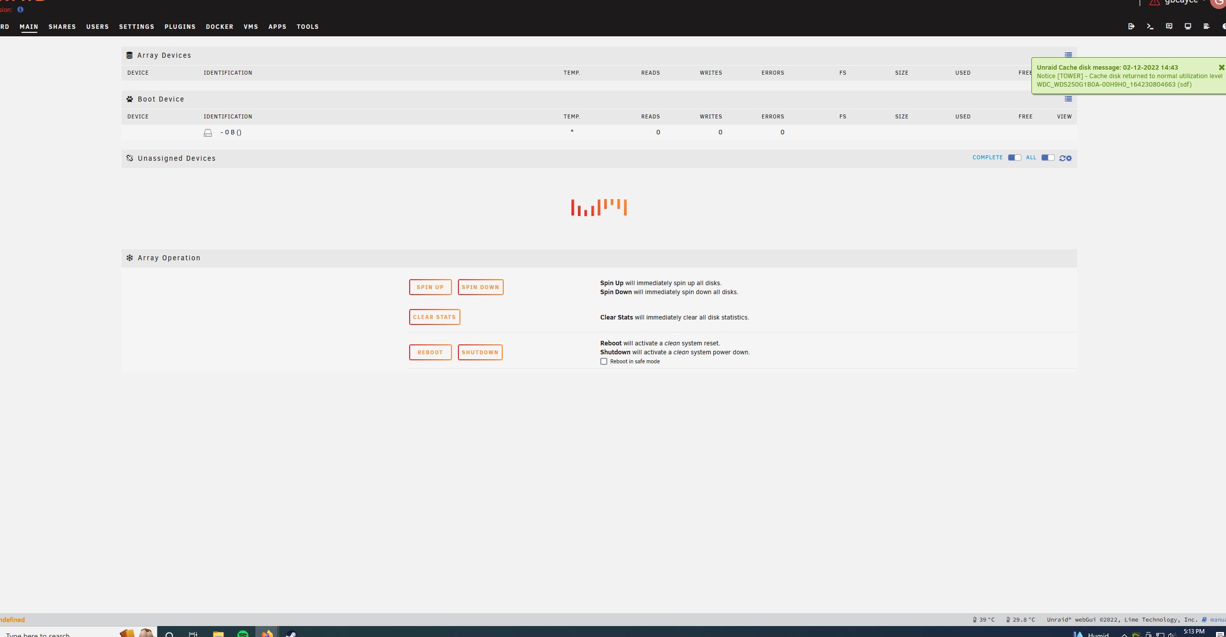

My server has been functionally going off line seemingly randomly.  it started with the server staying on and the web GUI still accessible, but all the shares disappear (see attached, error in corner says "array undefined".  to my knowledge no heavy reads or writes happen when this occurs.  when i go to reboot it hangs and i have to hard restart.  sometimes only my docker containers will go offline and the array will stay online.  now i just cant get half my docker containers to start.  any help or guidance is greatly appreciated! (server specs below)

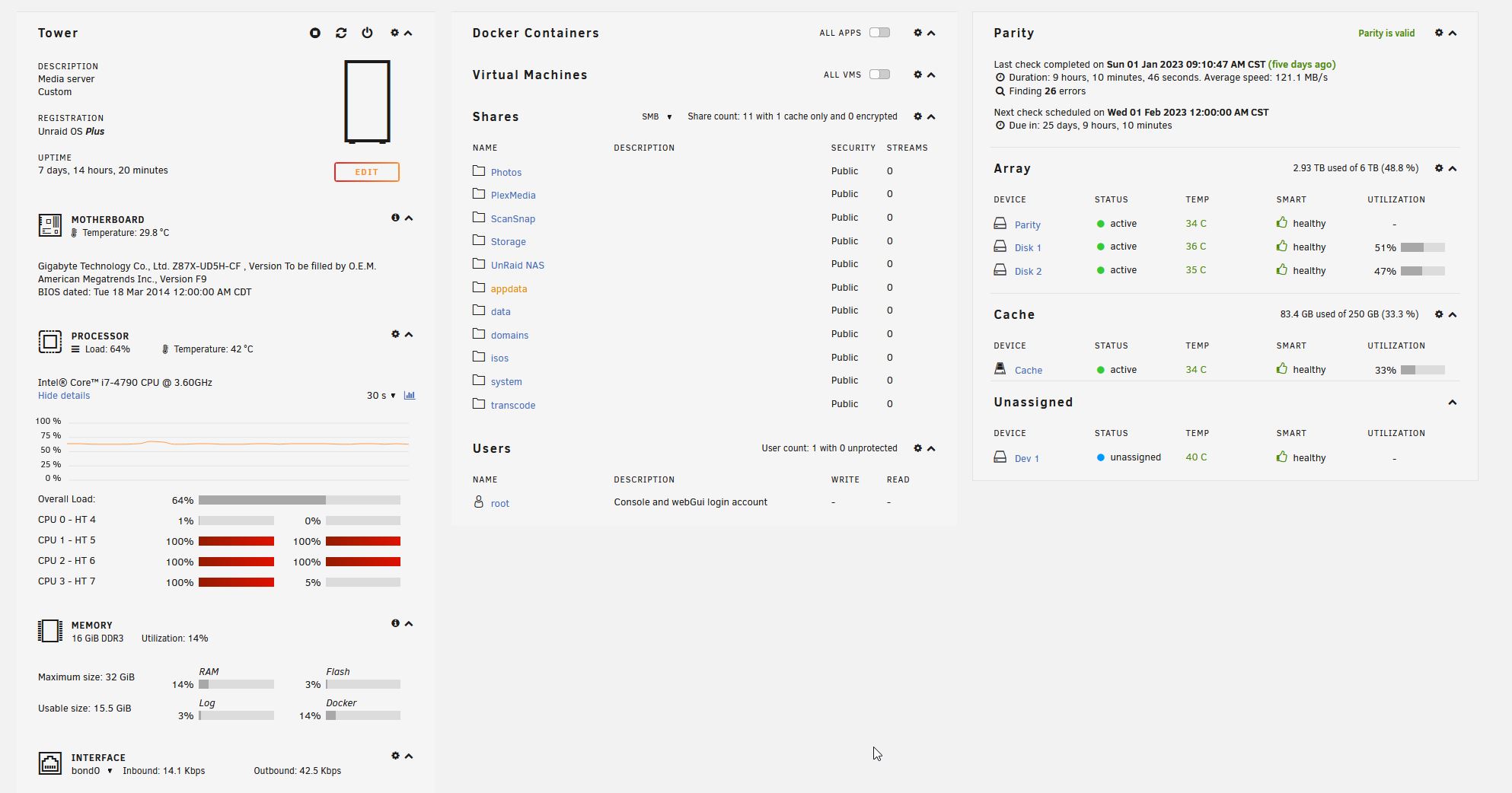

i just logged in to shut down the server and now i have this new weirdness....
the gui still is responsive, docker is frozen (nothing loads on that tab).  the containers are frozen (pihole will not load).  and the CPU on a number of cores is pegged.  attached are logs and screen grab.  before i shut this down is there anything i should look for?
uptime is at 7 days 14.5 hrs
418932969_2023-01-0614_49_24-Tower_DashboardMozillaFirefox.thumb.jpg.91b1ebd2f486a4c18a4d8ca30766d4e9.jpg
tower-diagnostics-20230106-1450.zip
also cant access the shares from windows explorer
Unraid driver crashed, you need to reboot, force it if needed, that also points to hardware problems.
