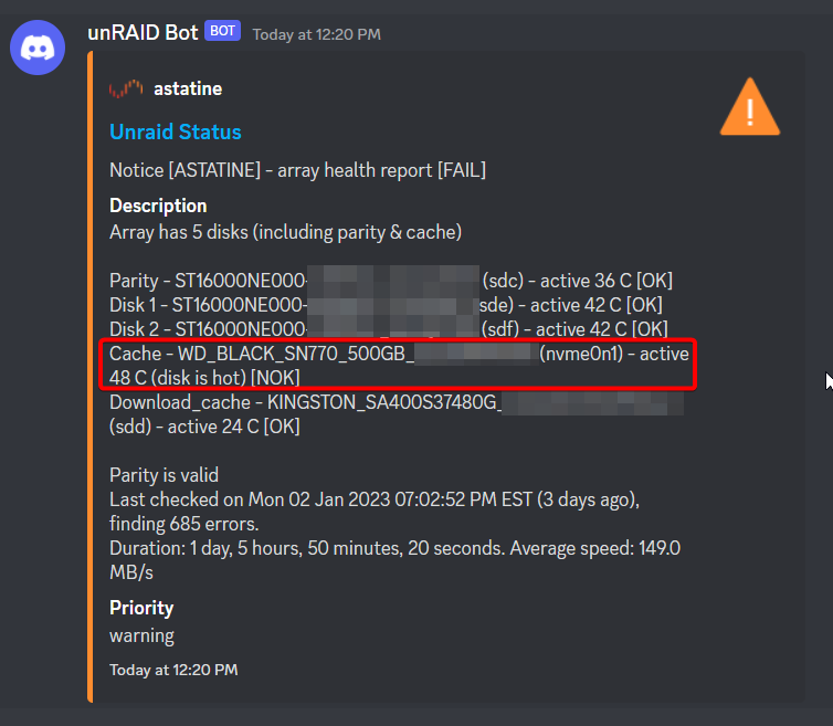

I have unRAID setup to send notifications to my discord channel. For the past 3 days, I am getting this error at 12:20PM.
I don't see anything in the WebUI that indicated 'Not OK' of the Cache drive.

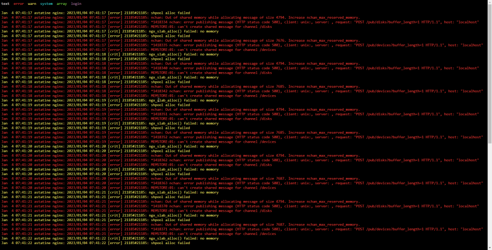

Along with this error, I've seen another error in the WebUI log panel a couple of times. Here's a screenshot of that.
I am new to unRAID and don't understand what's going on. Everything seems to work just fine but I am getting these errors.

10 hours ago, JorgeB said:
Set the NVMe temp to more than 45C.
That's all? Warning temp or Critical Temp?
I also have one SATA SSD as download cache. Should I put that above 45C too?
Edited by Astatine
Set both appropriately for SSDs, defaults are good gor HDDs only, I believe the array status only fails if critical temp is hit.
