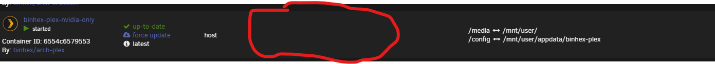

September 23, 20242 yr Hi there, I am experiencing a similar but different problem. My plex server (Binhex - plex) stopped working early this morning. When I checked unraid the docker had disappeared. The files were still in the AppData folder, so I went to the apps and reinstalled the container from the recent apps. All the setting looked good and the docker was running. When I tried to access the web UI, I got an error message, "This site can’t be reached" and "Connect refused." when I reexamined the docker container settings I noticed that under the docker allocations, the plex docker had three question marks "???", while all the other containers each have unique ports. Please refer to screen capture; Additionally, I noticed that under the dockers tab is no "port mapping"being displayed prior to this issue, please refer to screen capture ; I have attached the general diagnostic log, the plex server log, and a sample of the superord.log that references the crash. I hope that it helps with identifying the issue. If you have any suggestions on how I can fix this issue, I would greatly appreciate them. Thank you. tower-diagnostics-20240923-1144.zip Plex Crash Uploader.log 20240923 supevisord.log sample.txt Edited September 23, 20242 yr by brownsugar Needed to add additional information and an attachment that may clarify things for the reader.
