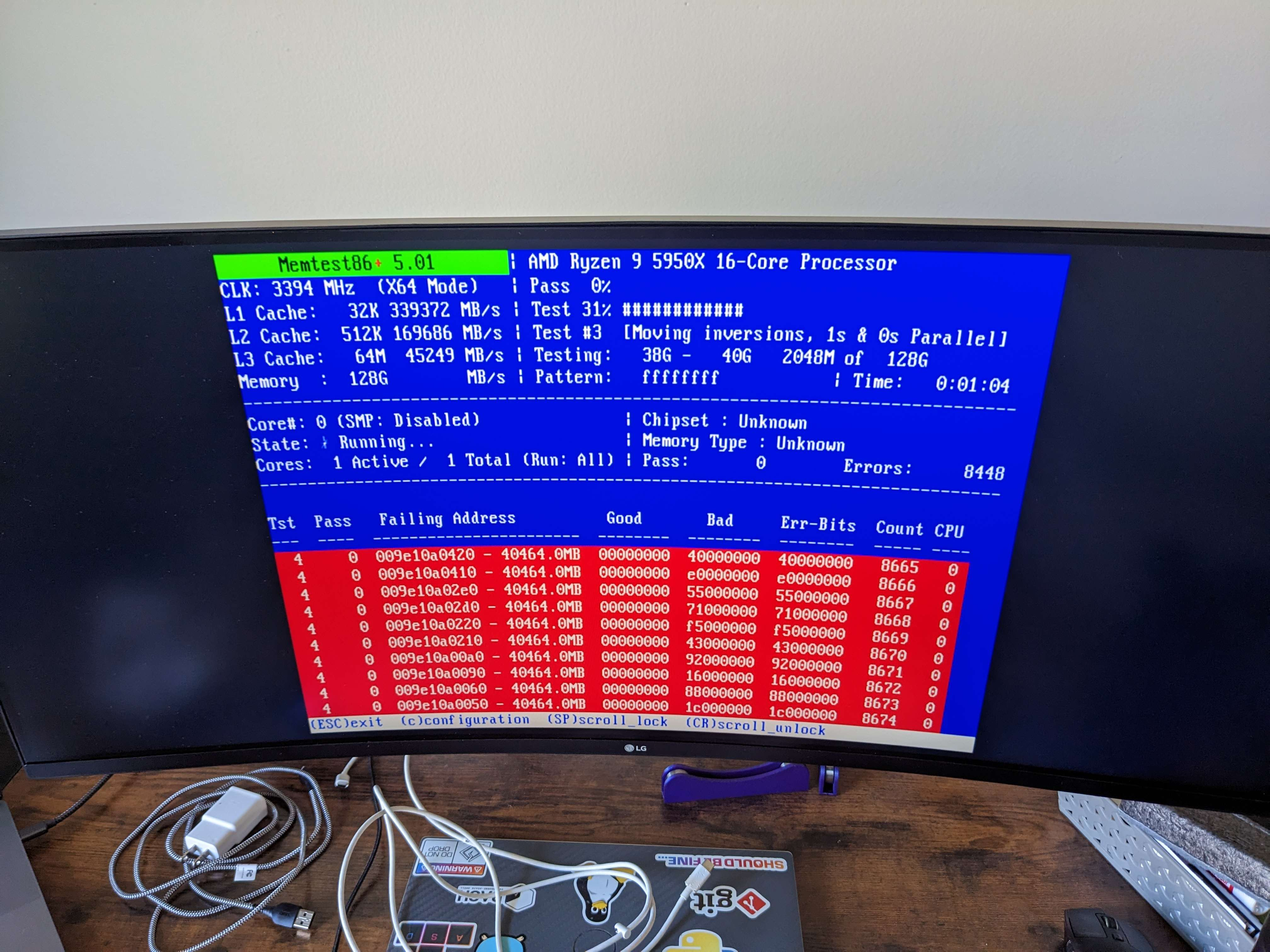

Okay there's something seriously wrong with my hardware.image.thumb.png.c7a0e2990b8afe06803d62e089ef7175.png
I let it get to about 200k errors before I pulled the plug. I'm going to first attempt to remove all the RAM and run memtest one stick at a time, hopefully this is as simple as some lose RAM. If that all fails then we'll try a re-seat of the CPU. If that doesn't work, do I have any other options other than some form of RMA?

I am aware of this, I just was hoping that I got lucky and that only one of my sticks was bad and the first one it tested happened to be the bad one, but obviously not now. I assume this is probably related to a bad seating of the CPU, however I'm going to try reseating the RAM first (and testing each stick individually) as that required less effort on my part initially.
