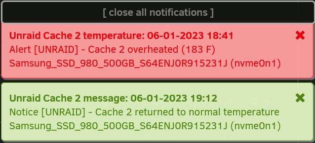

I upgraded from 6.9.2 to 6.11.5 last week. The only things that have changed are I installed the My Servers plugin and uninstalled plugins that are no longer supported. (CA Backup v2 and the Nerd Pack) Then installed CA Backup v3 (Kluth version) Since then I have been getting notifications multiple times a day that Cache 2 is at 183 degrees. ( I have no clue as to why...) Then about 20-30 mins. later it goes back to normal. This is not normal behavior for my server. Very rarely would I ever get a notification the either of my cache drives are hot. Cache 2 has a heat sink and there is a fan that blows across both Cache drive 1 and 2. Any ideas? Thanks!

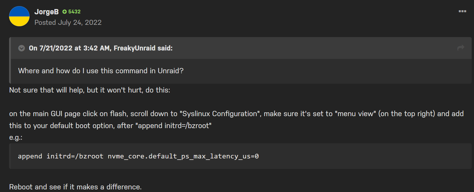

This is an issue with the Samsung 980 nvme. Search the forum and you will see a lot of similar posts, some will have more details on the why if you are interested.
Here is a link to a known solution to prevent the warnings (I'm posting what Jorge, or other mods would post 🙂 )
https://forums.unraid.net/bug-reports/stable-releases/6103-samsung-980-temp-warning-r2007/?do=findComment&comment=20180

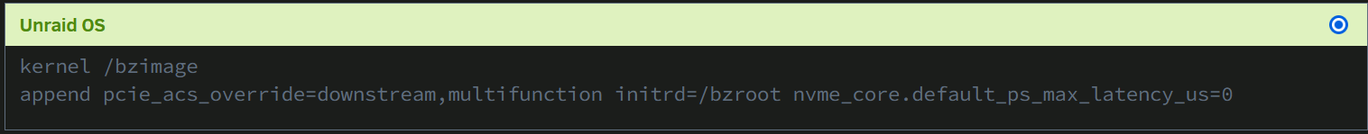

Thanks! I checked out the link. It looks like I need to add the following:
This is what I did. I just want to make sure its correct before I reboot. Thanks!
Yes, that looks correct!
Thanks! That did the trick.
