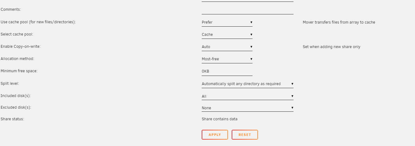

MAM59 Posted January 8, 2023 Share Posted January 8, 2023 (edited) The settings look ok to me, but your problem ist supposely that the vm is running all the time, so mover wont touch her. Stop VM Manager, start Mover and look into the protocol. It then should move over the VM files so the next time you restart the VM, it will run off cache. Update: do the same for Dockers too. Stop Dockers, set share to prefer, run Mover, start Dockers And optionally: once the files have been moved, change "prefer" to "only". This will ensure that corresponding files never are created offside of cachedrive Edited January 8, 2023 by MAM59 Quote Link to comment
trurl Posted January 8, 2023 Share Posted January 8, 2023 1 hour ago, Allesanddro said: more Information attach diagnostics to your NEXT post in this thread Quote Link to comment
Allesanddro Posted January 8, 2023 Author Share Posted January 8, 2023 tower-diagnostics-20230108-1941.zip 15 minutes ago, MAM59 said: The settings look ok to me, but your problem ist supposely that the vm is running all the time, so mover wont touch her. Stop VM Manager, start Mover and look into the protocol. It then should move over the VM files so the next time you restart the VM, it will run off cache. Update: do the same for Dockers too. Stop Dockers, set share to prefer, run Mover, start Dockers And optionally: once the files have been moved, change "prefer" to "only". This will ensure that corresponding files never are created offside of cachedrive will try Quote Link to comment

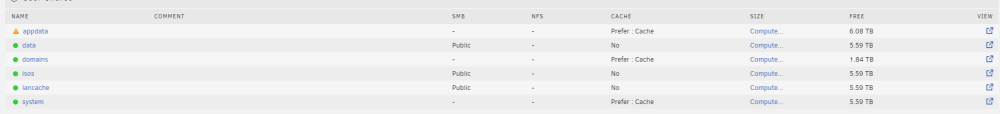

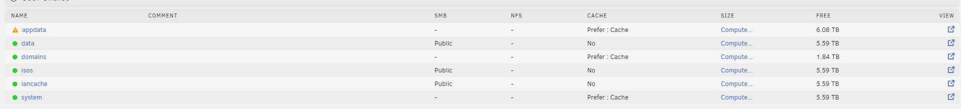

Solution trurl Posted January 8, 2023 Solution Share Posted January 8, 2023 Your screenshot above is missing a crucial detail. What is the name of that user share? Your appdata, domains, system shares all have files on the array. Ideally, these shares would all be on fast pool (cache) so Docker/VM performance isn't impacted by slower array, and so array disks can spin down since these files are always open. Set appdata, domains, system shares to cache:prefer so these can be moved to cache. Nothing can move open files, so you will have to go to Settings and disable Docker and VM Manager before these can be moved. Then run Mover. When mover completes, post new diagnostics. Why is your docker.img so large? Quote Link to comment
Allesanddro Posted January 8, 2023 Author Share Posted January 8, 2023 (edited) So this would be the correct config? tower-diagnostics-20230108-2004.zip Edited January 8, 2023 by Allesanddro Quote Link to comment
trurl Posted January 8, 2023 Share Posted January 8, 2023 That is the correct settings for those shares, but doesn't look like you have actually done anything about moving them yet. Any idea what these are about? Jan 8 11:04:13 Tower sshd[13330]: Failed password for invalid user telecomadmin from 152.89.198.211 port 10797 ssh2 Jan 8 11:04:13 Tower sshd[13330]: Received disconnect from 152.89.198.211 port 10797:11: Client disconnecting normally [preauth] Jan 8 11:04:13 Tower sshd[13330]: Disconnected from invalid user telecomadmin 152.89.198.211 port 10797 [preauth] https://www.abuseipdb.com/check/152.89.198.211 Have you put your server on the internet? Quote Link to comment
