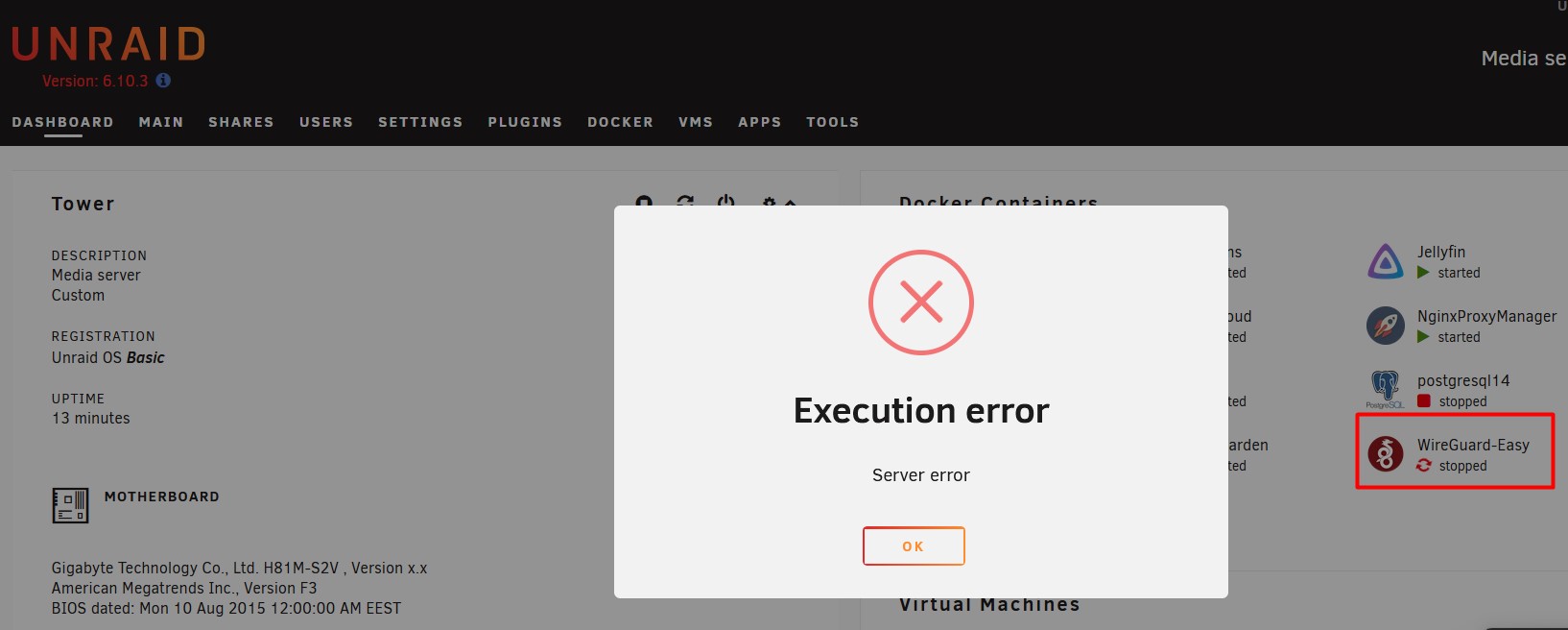

On another note, I am having troubles starting the Wireguard docker service. It gives me an execution / server error (scrn attached). Any ideas about what might be causing this?
Why not use the Wireguard included with Unraid?
Could you please send tutorial / instructions on setup?
