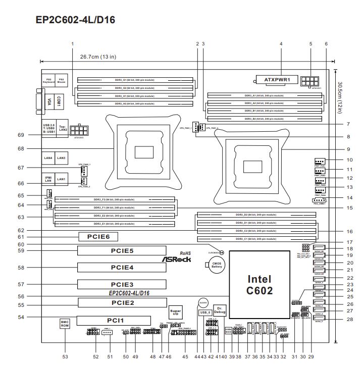

Thanks, will have a look in the bios as per:
Slight correction to yesterdays post as per:
The controller is in:
PCI Express 3.0 x16 Slot (PCIE2, Blue) from CPU_BSP1
The expander is in:
PCI Express 3.0 x 4 Slot (PCIE6, White) from CPU_BSP1
(As the expander only require's power)
With an Nvidia 1650 TI graphics card in:
PCI Express 3.0 x16 Slot (PCIE4, Blue) from CPU_BSP1
(As the graphics card takes up two slots, 3 & 4)
(PCI Express 3.0 x16 Slot (PCIE5, Blue) from CPU_AP1, cannot be used as Im not using a 2nd CPU currently.)

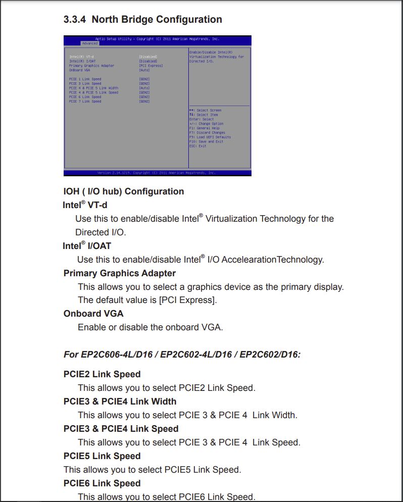

It makes me wonder if I should remove the graphics card, and put the controller in PCIE 4 as according to the BIOS, you can control both the link speed and width on:
PCIE3 & PCIE4 Link Width This allows you to select PCIE 3 & PCIE 4 Link Width.
PCIE3 & PCIE4 Link Speed This allows you to select PCIE 3 & PCIE 4 Link Speed.
