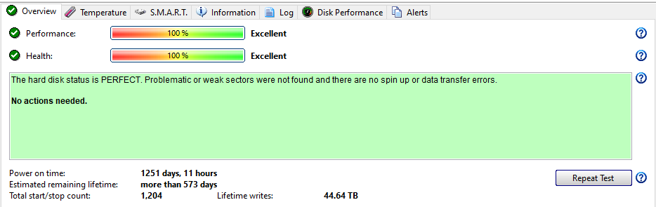

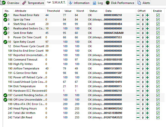

I have two drives that are claiming to get read errors (twice in the last month). I pulled the drives and ran an extended self test AND a full sector test (surface test) with hard disk check software (hard disk sentinel). All checks passed without any issue. I removed drive from the disk, restarted array (to clear it out), removed disk from historical devices, put the disk back into the array to have the contents full rebuilt on the drive. About 3 weeks, worked without issue and then boom, read error again. I even switched the drive bay in the physical server expecting that if it was a hardware issue the disk# would change that had the error. But, same disk had read errors again (even in the other slot).
My question is, what could keep causing read errors on same disk in different drive slots (different back planes, sas cables, power) when all tests keep passing on the disk outside of the array? Uploaded SMART report and other test results for reference.

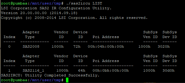

Is there a way to determine the exact model number of my sas controllers? I have an idea but don't want to be guessing.
I see these two lines for cm0 and cm1 -- so it appears I have 2 sas controllers but not sure how to ensure I select the right firmware based on LSISAS2008 and LSISAS2116
mpt2sas_cm0: LSISAS2008: FWVersion(19.00.00.00), ChipRevision(0x03), BiosVersion(07.24.01.00)
mpt2sas_cm1: LSISAS2116: FWVersion(17.00.01.00), ChipRevision(0x02), BiosVersion(07.24.01.00)

This is the last question I have for now -- If I can confirm my model numbers / firmware version (without ripping into the case) that would be fantastic. Any ideas on how to do that?
I was able to use sas2IRCU to list the two devices
Edited by srfnmnk
39 minutes ago, srfnmnk said:
Gotcha -- are you aware of firmware updates that can resolve power bumps?
It can resolve a disconnected, which was what happened, it could have been power/connection related but it could also have been other reasons.
37 minutes ago, srfnmnk said:
LSISAS2008
Look for 9211-8i
LSISAS2116
Look for 9201-16i
