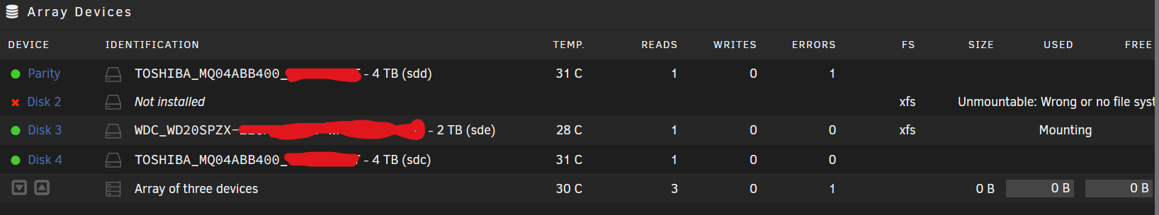

We then power the server up, all disks were present (bar the one that had been removed due to failing, data was being emulated), go to start the array as there was some important data we needed to access, only to be given a warning that the array has 1 drive with read errors. The Main tab looks like this

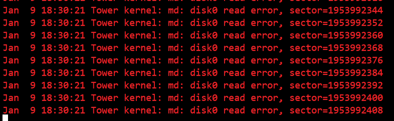

None of the other drives should have issues, though when veiwing the syslog, we are given these errors, one cpu core is also pinned at 100%, HTOP tells us that it's the syslog utilising the core (This snippet was taken at 9pm): image.png.5a2dbb85e177ba553394b52adce493bf.png
I've attached diagnostics taken when we found the errors/just after we started the array.

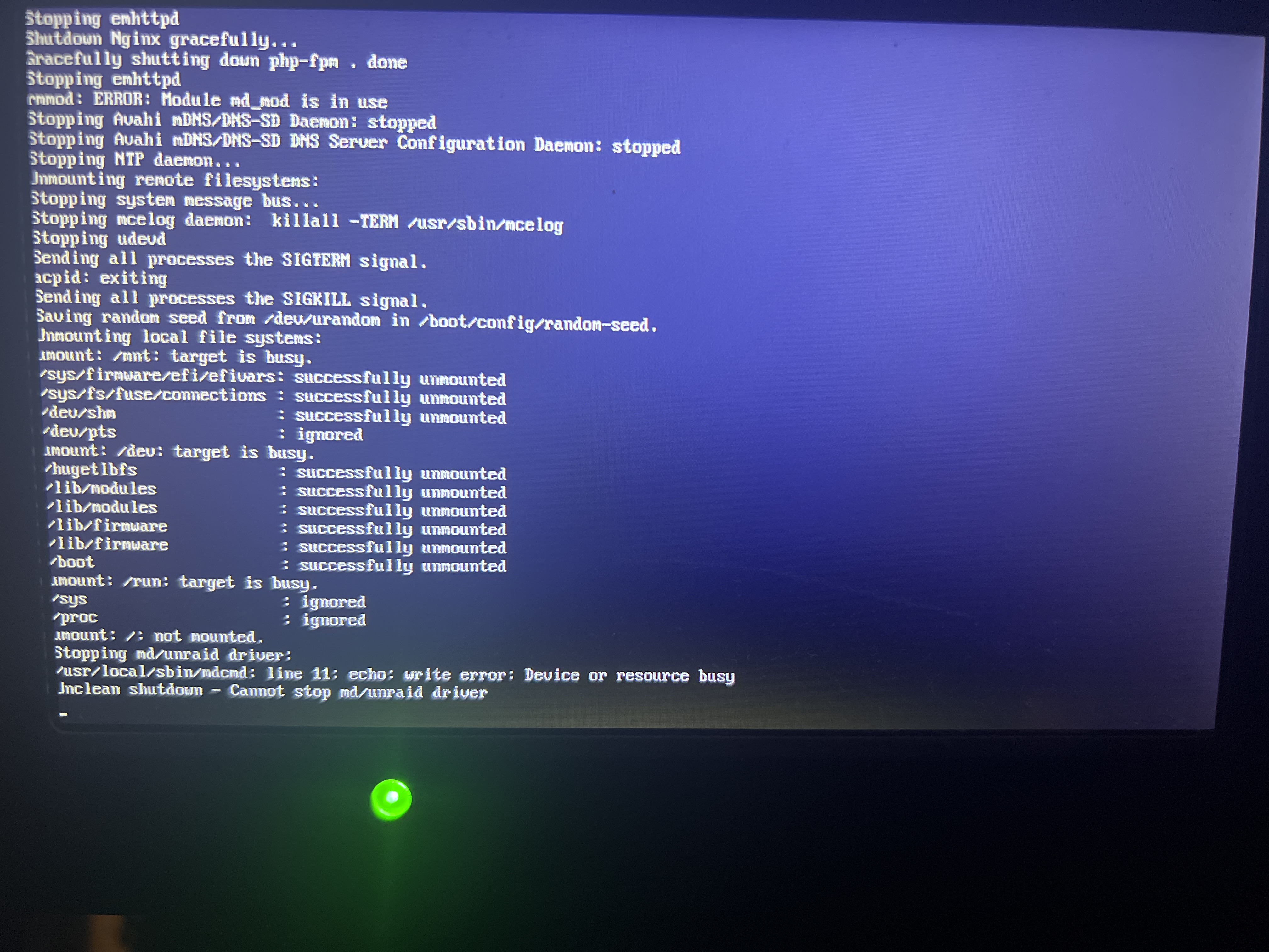

A small update, we tried to issue power down command via command line, as it had completely frozen, UI is inaccessible and on the screen connected to the server we have this.
Any advice is appreciated as always.
Thanks, myles
Make sure your current directory at the cli is not on one of the disks. pools, or user shares
Parity disconnected and reconnected as a different device, so it isn't part of the array currently. And so disk2 can't be emulated.
Check connections, SATA and power, both ends, including splitters.
Hi trurl,
thank you for the response, we checked connections and it was still having issues, I then switched the drives from a power splitter to sata plugs wires directly and parity was then detected properly, no read errors etc.
so we’ve gotten a new splitter to replace the previous one (a new psu is going to be ordered VERY soon) and all seems to be running as expected!
thank you for your response again

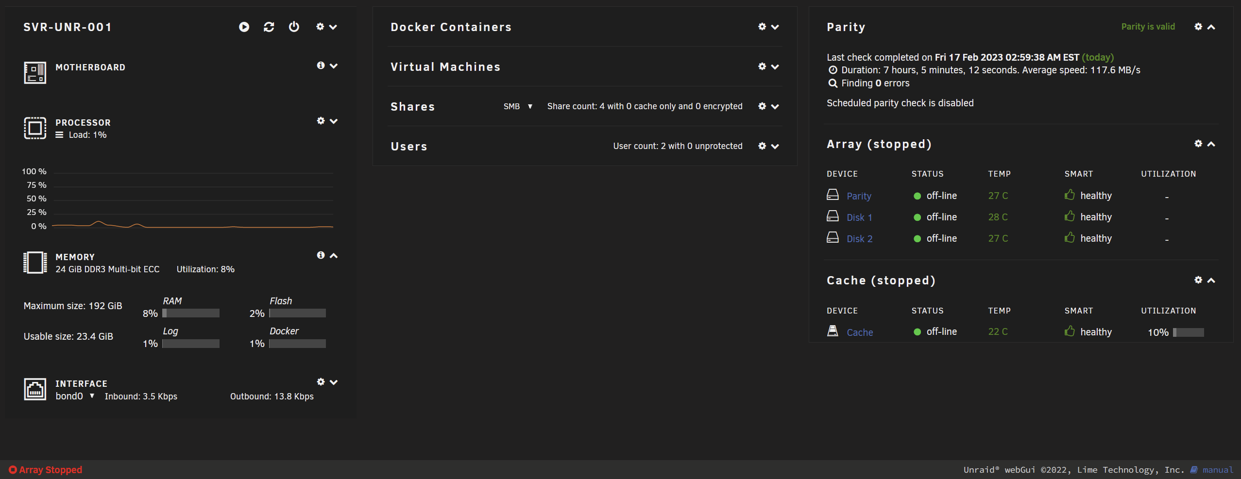

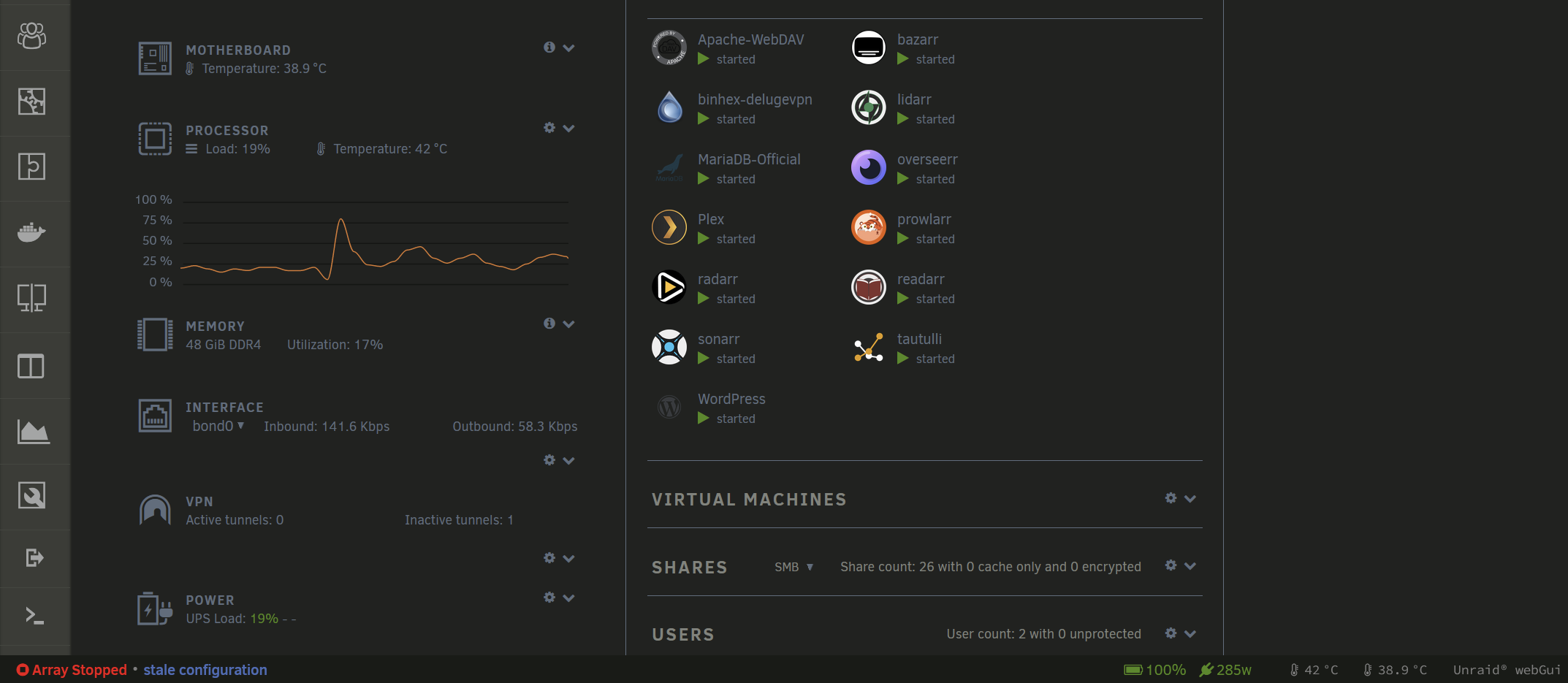

I got a similar situation on both of my servers. One of them is brand new from yesterday and when i start the arrays its telling me that it stopped but all my docker containers is still running. I don't understand I didn't change any of the config on my arrays.. I'm running 6.11.5 on both.
svr-unr-001-diagnostics-20230217-1009.zip
Do you have other tabs or browsers accessing your Unraid webUI, including other devices?
None of your disks mounted except for cache
Feb 16 19:54:20 SVR-UNR-001  emhttpd: /mnt/disk1 mount error: Unsupported partition layout
Feb 16 19:54:20 SVR-UNR-001  emhttpd: /mnt/disk2 mount error: Unsupported partition layout
08:00.0 RAID bus controller [0104]: Broadcom / LSI MegaRAID SAS 2008 [Falcon] [1000:0073] (rev 03)
RAID controllers NOT recommended for many reasons
