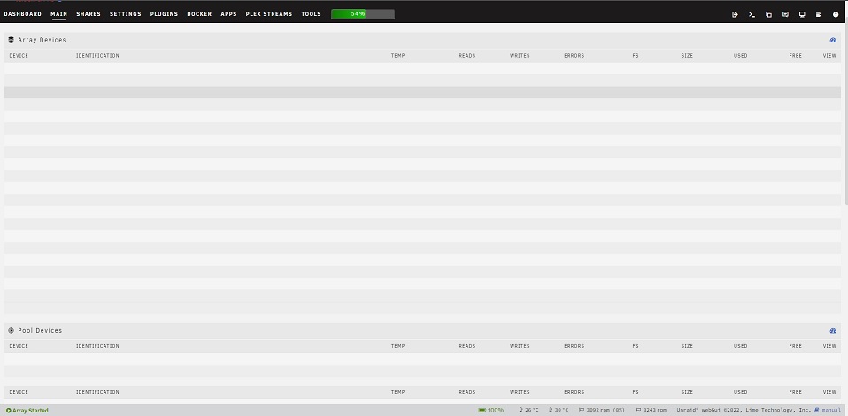

January 11, 20233 yr So this randomly happened yesterday. Poof, dashboard and main no longer populates data. Some of the plugins are showing data (like disk location), but you can't interact with the plugins. I can minimize or open the panes, but that's it. This is specific to Chrome. It works in Edge, Chrome incognito (all on the same machine), Chrome on my phone. No ad blockers running, no weird or malicious extensions in Chrome. I cleaned all of the browsing data for the hour prior to it happening. Rebooted both the server, as well as closed Chrome, restarted my laptop, etc. I'm at a complete loss here. Halp?

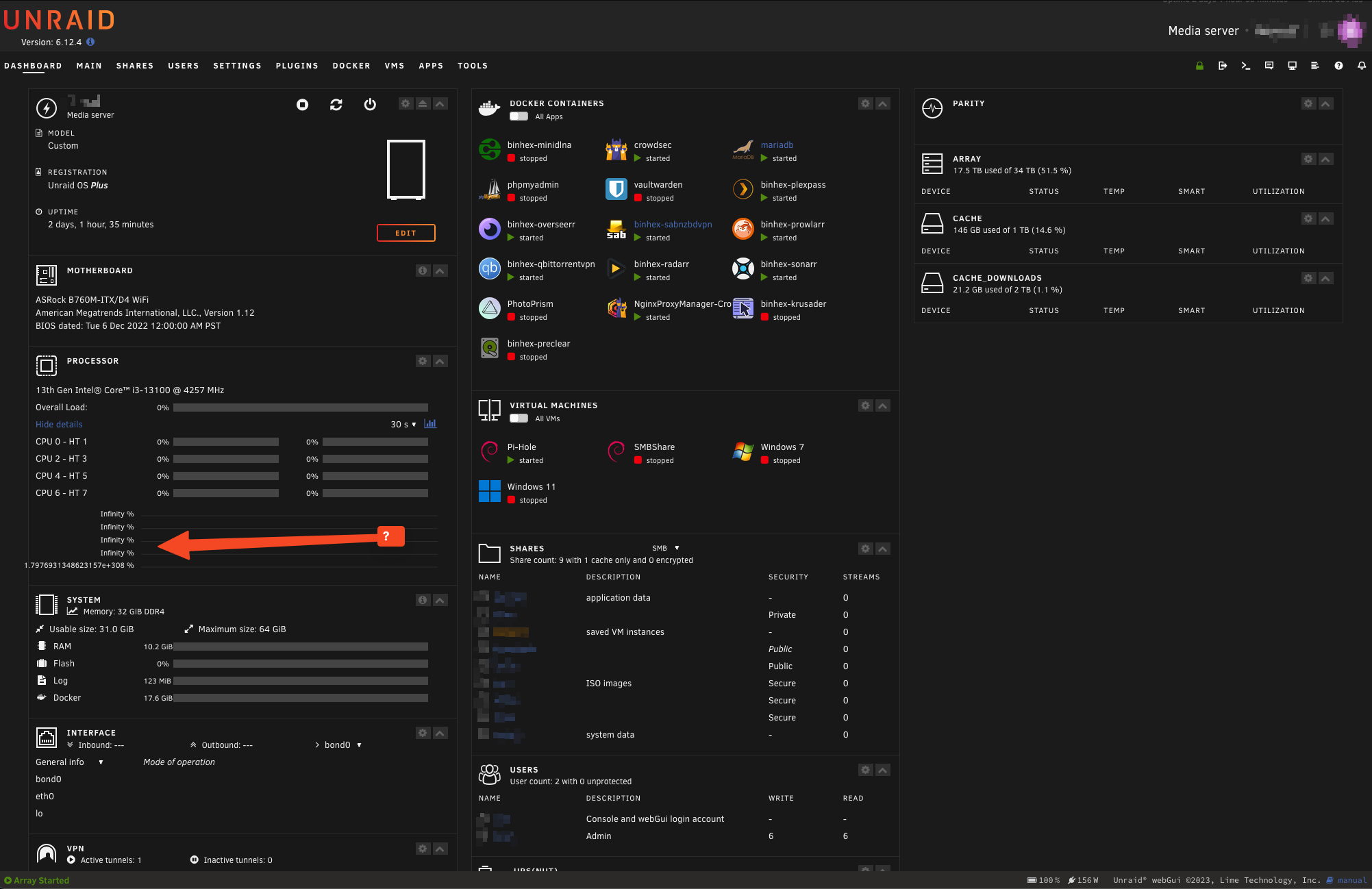

November 1, 20232 yr Same here on 6.12.4. Dashboard Processor bars don't move, and Array is empty. All dockers and VMs are still up and running. I did notice that the Processor section shows a strange "Infinity %" label. Clearing browser cache and changing browsers don't help.

February 25, 20242 yr I'm running 6.12.8 and just experienced this on Edge. For me, stopping and starting the Array fixed it.

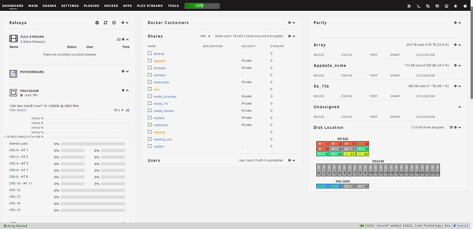

February 29, 20242 yr This issue is so annoying and has been an issue for a while with my setup... anyone now why there's "infinity" below my usage? EDIT Seems it was the graph for but I did what another user suggested and stopped the array and it showed up. One thing I did notice is that when this happens the user defined script from space invader for docker size doesn't work... weird Edited February 29, 20242 yr by likwid
