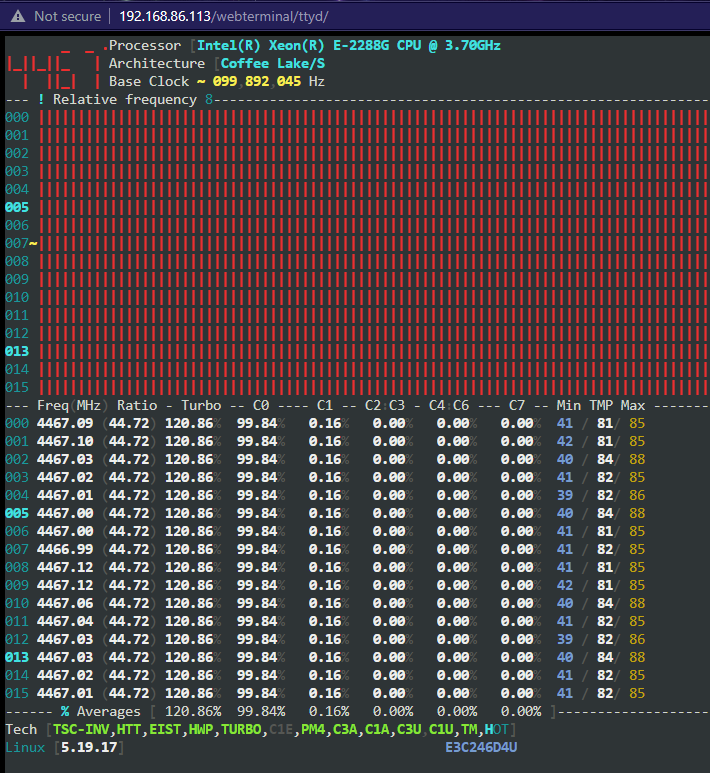

Try the CoreFreq plugin, you can use it to run a benchmark that will stress your CPU.  If it crashes or gets into the high 90's, you'll know.
Can do it from the "tools" menu and use Atomic Burn.
So, running Atomic Burn, I'm seeing temps that are pretty hot. Hitting around 85C even after reapply thermal paste.  Do you think this is a thermal shutdown issue? When I find the computer, the lights are still on and it has multiple disk access lights, but no response either headless with SSL or with directly connect KVM.
