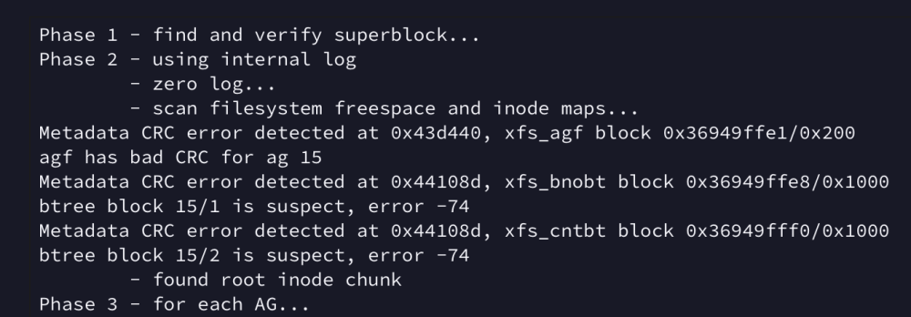

disk 1 showed unmountable...? The odd thing is filesystem check in UD showed no issues after they were formatted.
disk1 is an array disk. If the disk was disabled/emulated/rebuilding and unmountable, that has absolutely nothing to do with the physical disk you pointlessly formatted in UD. Good thing too, since your data is on that emulated/unmountable disk.
Did you do check filesystem from the webUI? Post the complete output from that.
Yes, redundant format was prior to adding to the array. I learned that lesson the hard way a few years back, only ever format in the array when expanding now. Makes sense that the rebuild handles overwriting too.
Ah, so original filesystem is recorded (assuming this is how emulation works?) and if something is off, it will carry over to the new disk?
Assuming the next step is performing a repair?

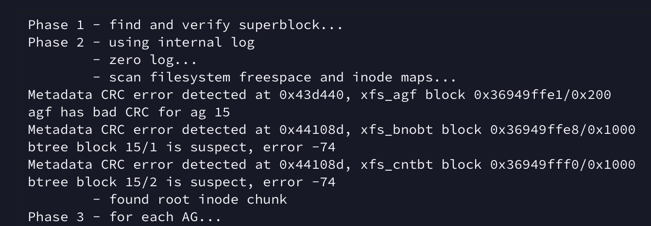

Last check was run from the webUI in maintenance mode (xfs). Here’s the full output from a run with the -nv flags

Do it again without -n. If it asks for it use -L

If the emulated disk is unmountable, the rebuild will be unmountable. We try to repair unmountable before rebuild, especially if rebuilding to the same disk. Not as important if rebuilding to a new disk, since the original disk won't be overwritten.

So running a xfs repair without any flags, appears to have cleared up the filesystem. It didn’t request a run with -L
How do you recommend I proceed? Despite having dual parity, thinking now I might prefer to rebuild one disk at a time if it’s not too late…
Since I canceled the first rebuild attempt, do I need to do the unassign, start array, stop, reassign, and start rebuild dance? Not sure if just exiting maintenance mode and starting the array will trigger a rebuild?

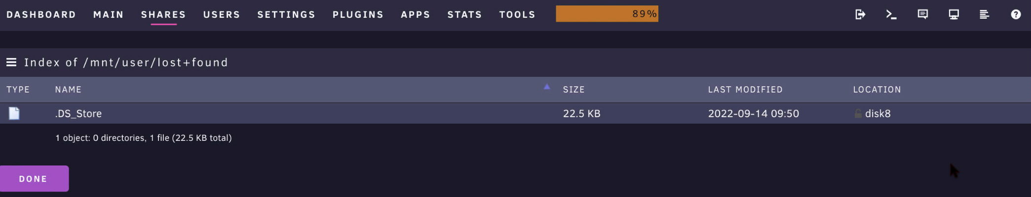

Have you checked your lost+found share? Surprised to see that it is on many different disks. That means you repaired many different disks at some point (or perhaps you redistributed that share to many different disks?).
lost+found is where filesystem repair puts things it couldn't figure out.
Not recently, no. Just looked in the share via the UI and only seeing an osx metadata file on disk8. Must be a bunch of empty folders…
Not sure why it’s showing on all those disks, I definitely haven’t done that many repairs.
