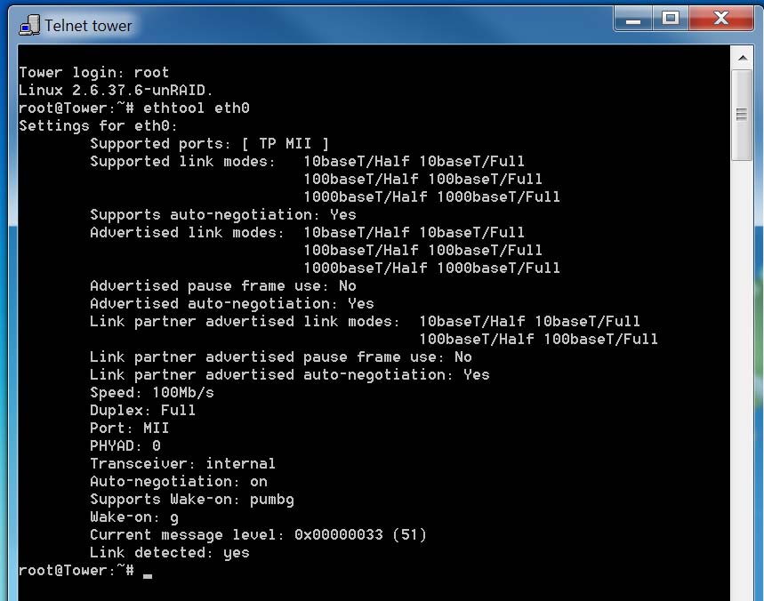

this is what i get when i type ethtool eth0
[/img]

Your network is 100Mbit so the 10MB is normal.

if i add the gigabit switch will it make it faster or do i need a new router?
As long as you make sure all PCs have a Gigabit NIC and are connected to that switch, you should see an improvement in speed (my unraid server does about 25 MB/sec to a parity protected share and 75-85MB/sec to the cache drive)
