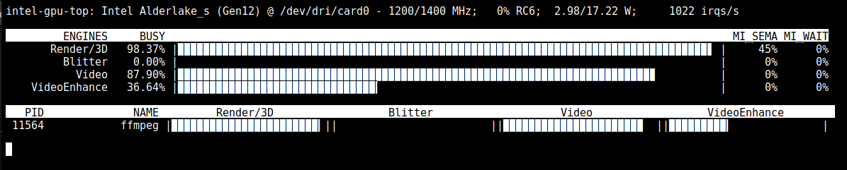

January 12, 20233 yr Hi, Just started using unraid for the first time about a week ago and it has been great. Got the *arr suite of software setup, along with my downloaders, and now trying to configure jellyfin to utilize quiksync within my i5-12600k on my ASUS TUF GAMING Z690-PLUS WIFI D4 motherboard. I am utilizing binhex's jellyfin container. Within the setup of the container in unraid, I have added the following to the extra parameters section: --device /dev/dri/renderD128:/dev/dri/renderD128 --device /dev/dri/card0:/dev/dri/card0 I can obviously see this within the Jellyfin container's shell. I have also installed intel_top_gpu as a means of confirming the transcoding is actually utilizing the iGPU. This is what I see when running that, obviously no load since its not being utilized. intel-gpu-top: Intel Alderlake_s (Gen12) @ /dev/dri/card0 - 0/ 0 MHz; 100% RC6; 0.00/ 6.66 W; 0 irqs/s ENGINES BUSY MI_SEMA MI_WAIT Render/3D 0.00% | | 0% 0% Blitter 0.00% | | 0% 0% Video 0.00% | | 0% 0% VideoEnhance 0.00% | | 0% 0% PID NAME Render/3D Blitter Video VideoEnhance If I attempt to utilize either VAAPI or Intel Quicksync in the Transcoding settings of Jellyfin, I am met with the following when attempting to play something: Quote Playback Error This client isn't compatible with the media and the server isn't sending a compatible media format. When I select VAAPI, it correctly defaults to /dev/dri/renderD128 Lastly, just for the sake of conforming with all the other instructions I have found. I created /boot/config/modprob.d/i915.conf (because it didnt exist) and added "blacklist i915" to it. Probably pointless, as I believe this only exists to ignore pre-existing drivers in favor of whats in /dev/dri/ ? Anyways, looking for advice on what I am missing. Thanks!

December 18, 20232 yr On 5/3/2023 at 2:29 AM, quietwalker said: @mArBLe It works!!! Thanks you so much How do you get this output?

December 28, 20232 yr On 12/18/2023 at 9:58 PM, LanceM26 said: How do you get this output? using intel-gpu-top
