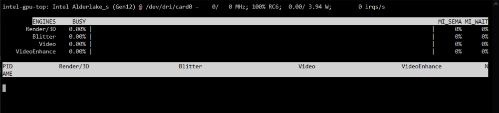

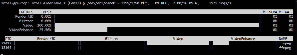

i tried to follow but it didn't work, and intel_gpu_top didn't show anything running on igpu. any idea to fix this ?image.thumb.png.5164d0f9713051dd3aff97f14ee99c00.png

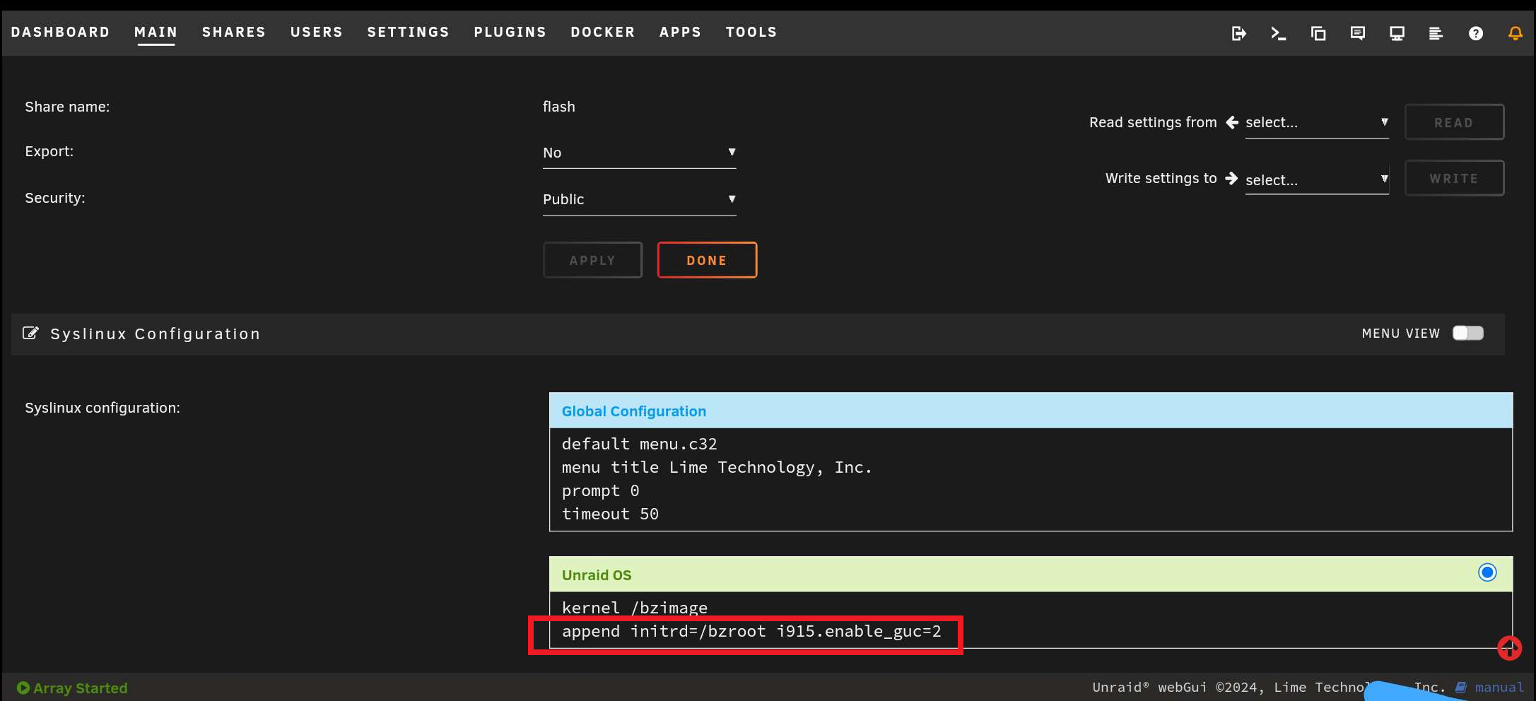

hey, late to reply but i found the way to enable transcode by following MisterMue Guide
i just add these line onto my flash drive it actually work on bbeirge-jellyfin and binhex jellyfin
434678025_1533134487250595_8117909834232008125_n.jpg.e79ce321e49321b6dbcb0353c61f0958.jpg
but Render/3D didn't show any statics like everyone show anything. however, if it work then it's working

You need to add it to each of the boot options you want to use.
22 hours ago, Xormus88 said:
I saw that come back a couple times, but where exactly did you add these, because the flash drive has multiple maps ;)

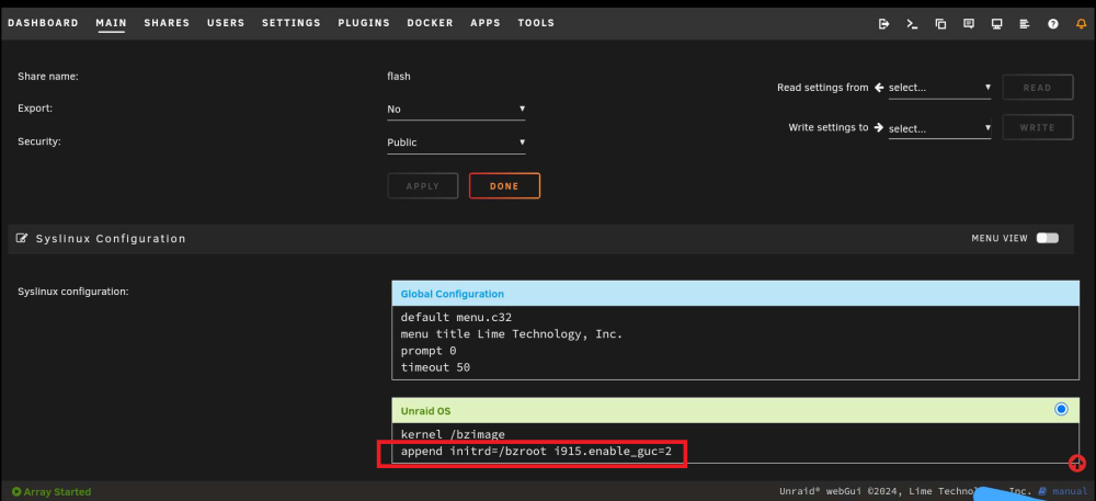

have you read the instruction ? you need to add that line in boot device > and click flash then you need add the line i marked image.thumb.png.7b18f124c81fd2894f4c9b692d8bf657.png
then you can continue follow MisterMue instruction by add GPU stats, jellyfin container and service setup
I did read the instructions, but I was looking on the flash drive itself (browsing the files), not so at home in unraid yet
No one else showed the entire screen, always only the unraid os jellow box
I added the line, rebooted my server and it finally works, thanks to you good sir or madam

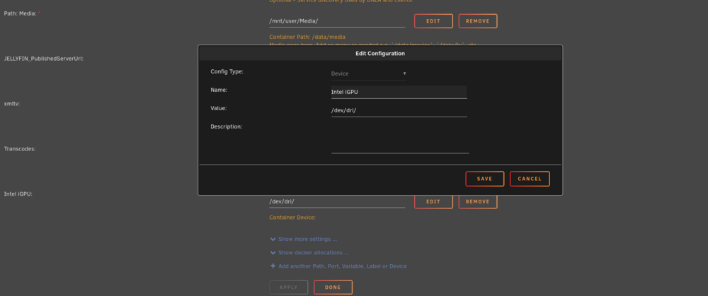

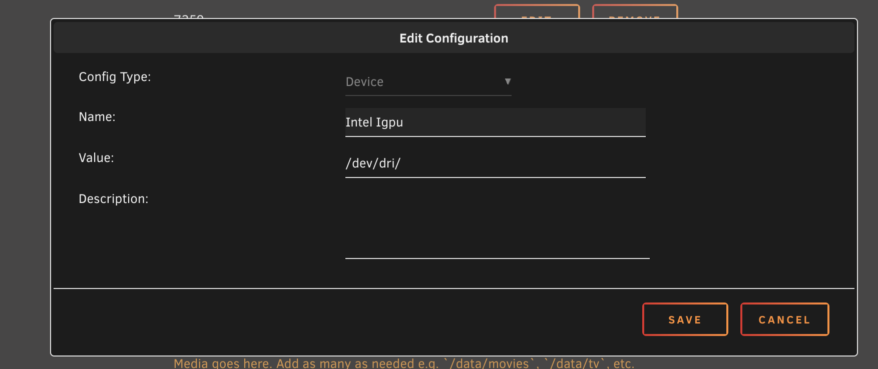

I got mines to work using the official Jellyfin container and adding the iGPU device as a path in the docker container. see screenshot below. Entering this info under extra parameters did not work for me. ich777 helped me with this.

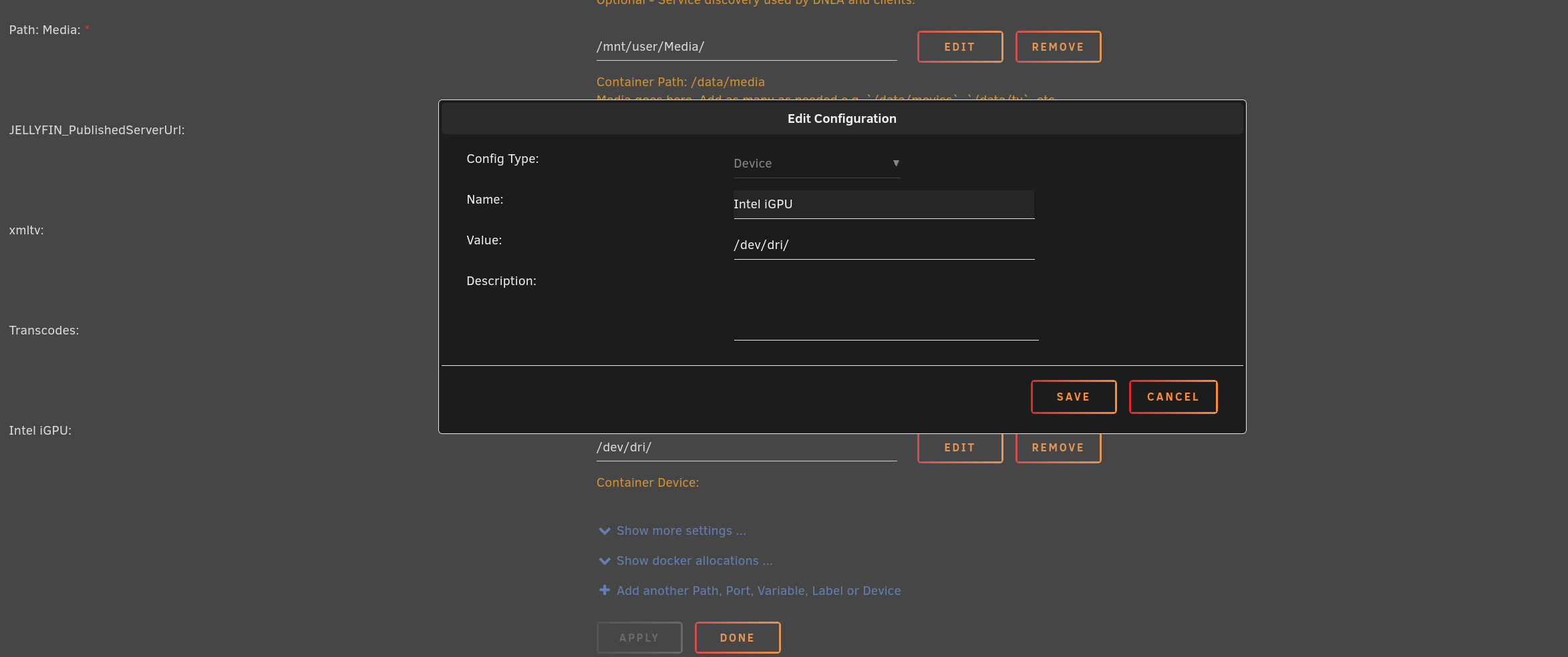

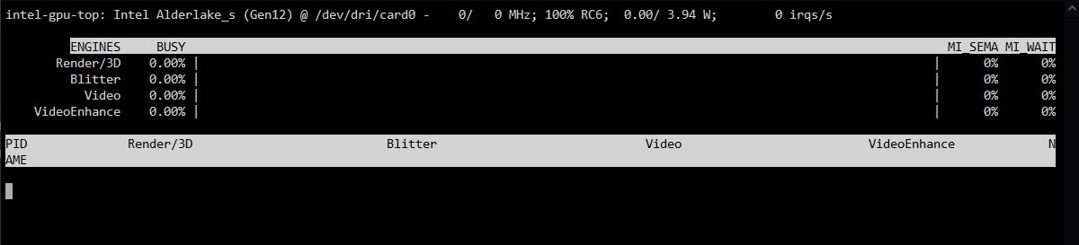

i am now trying for several days. But without luck. What do i wrong...
I switched to the offical Jellyfin-Docker
Intel_GPU_TOP is installed and works on Plex very well.

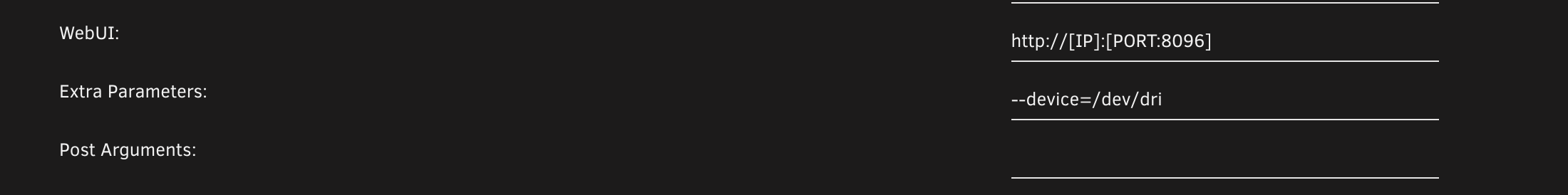

I tried to ad my Igpu as a device (see picture) as described in the former post.
I also tried to ad --device=/dev/dri (did i ad it correctly??? -> see picture)
But nothing works! So i ask friedly for advice...
I have an I5 - 13500 and in Jellyfin i enabled Transcoding Intel Quicksync.
Thank you!
Christian
