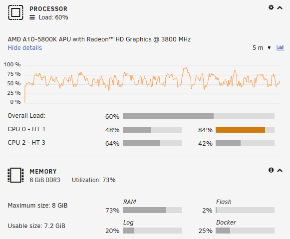

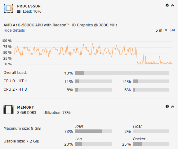

I use Vorta (Borg) so I can't really give you a proper comparison of Duplicacy.  Borg was recommended to me by a Linux friend who uses it at work to back up their servers.  It's free which is nice but I also like paid apps because it guarantees that the app will be supported and updated regularly.
Anyway, I installed Vorta on my test server which is an old machine with an old CPU and old hard drives that I used to use as offline backups (similar to what ConnorVT does today).
The screenshots below were taken during the backup process (back up 212GB from a folder on that machine to another folder on that same machine).  They show that the backup software doesn't really tax the system.  It's been running for about 30 minutes now and it's about 25% done.
If your CPU is about as powerful as mine on this server (my test server - which is using an AMD A10-5800K CPU) then you should be ok.  However, one of the things that I like about unRAID is that you can change the hardware.  For example, I had an old system lying around and I tried to use it but it was too slow (Core2Duo).  The CPU was always at 50% even though nothing was running.  I went out and bought a new mobo, CPU, and memory and installed it all into the old box and hooked up the hard drives.  Turned on the machine and unRAID picked up where it left off (Upgrading hardware in an existing set-up).
So my recommendation here is to build a system with what you already have and then upgrade the different parts as needed once you see it in action.

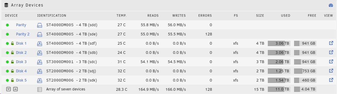

Ignore the errors you see for the Parity 2 drive which is slowly starting to fail but still works ok.

Some results following the completion of the archive process.  Originally 212GB.  Compressed and deduplicated down to 211.4GB
