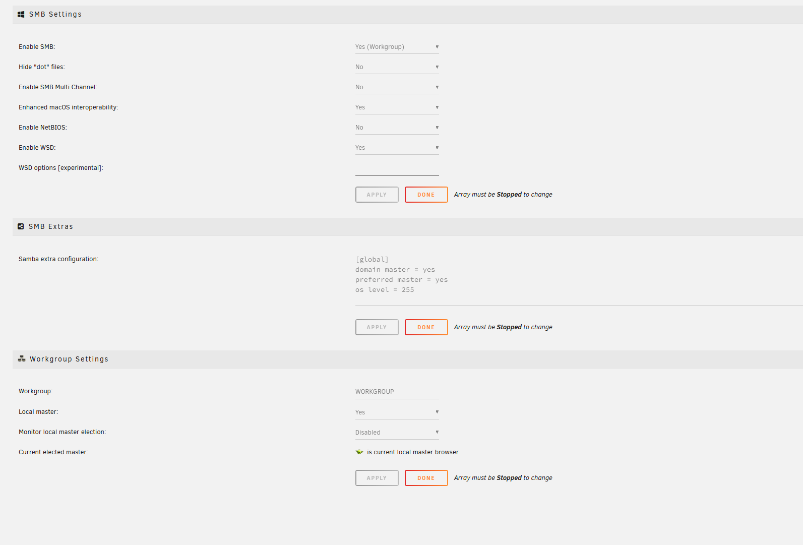

- Installed the "Dynamix Local Master" plugin to see the elected master, it shows the Yoda icon but no name? Not sure if this is correct? See the screenshot below.
- Also shown in the screenshot below, I added the SMB Extras I found in this comment.

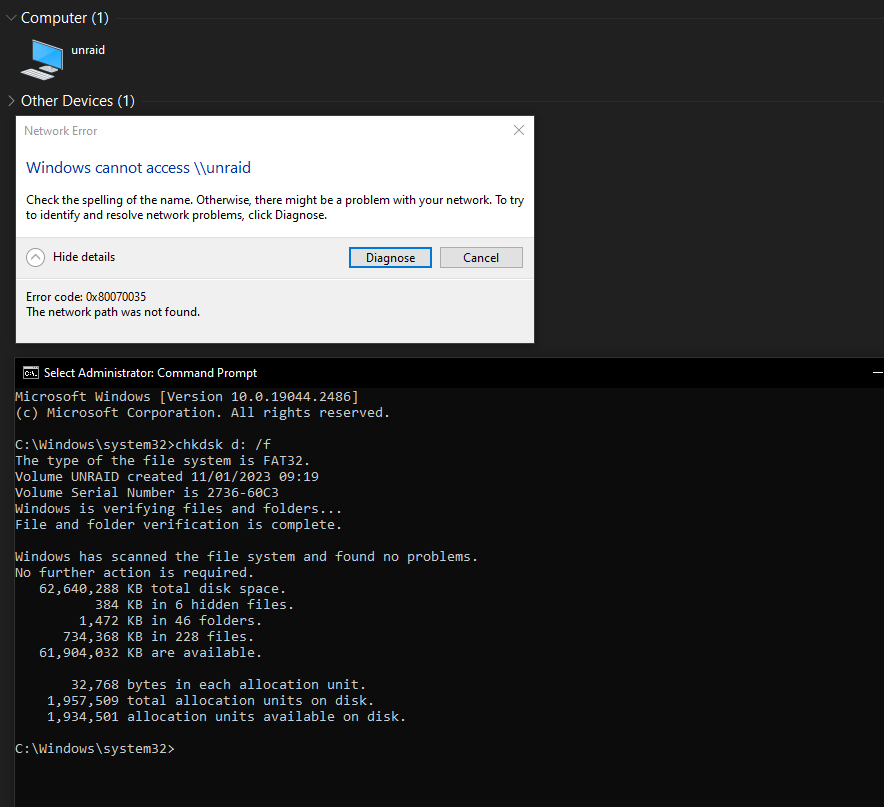

Looking in the attached logs, I can see in the shares folder, the share that should be called "data" is called "d--a", is this on purpose due to the "Anonymize diagnostics" or something else?
In the course of trying to debug this issue, I now have 2 unraid devices showing in my Windows network panel? (See below) I did try renaming the server to see if that resolved it from "unraid" -> "tower" and then back to "unraid". However, when I click on either of these I get the error shown below.
As it stands, the share I have configured doesn't connect on any of the 3 devices listed above.
This  plugin is "semi-broke".  As I recall, it will only be able to identify the name of the Local Master if SMBv1 is running.  (BTW, if you google looking for a way to find the Local Master, you will not find a way to do it--- period.  Not even from Windows.  So don't be surprised when LANscanner did not find the name of the Local Master!)  See below:
Neither of my two Unraid servers are even showing up on this screen shot!  And I can access them both.  (What is showing up are my two PCs that are currently on and two always-on networked printers.

So, I tried pulling the flash drive and running cdkdsk on it as you said and it didn't find any errors. I then put it back in and booted up the server again and still getting the same issue.
Is there a way I can reset the SMB configuration in Unraid? Apologies if that's a stupid question I'm quite new to SMB and Unraid in general.

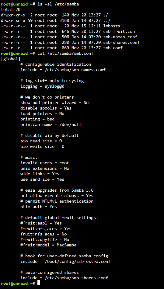

First, Open the    Main     tab of the GUI.  There should be not a red X or any other color then green or light-gray in the left column.  The array should be started.  The reason for this question is that disk2  had a write failure about 15 hours ago.  In my opinion, this failure should have disabled the disk.
================== Other wise proceed here:  ===========
Open open a Terminal Window   (The   >_   icon on the Toolbar of the GUI)  and type the following two commands:
ls -al /etc/samba
and
cat /etc/samba/smb.conf
Do a screen capture of both outputs.

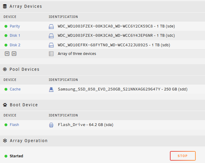

All green for the devices in the array as per below. I did notice some errors for Disk 2 yesterday around the time you mention. Although these errors disappeared in the UI and went to 0 so I wasn't sure if that meant they were resolved or not?
Outputs of the commands below.

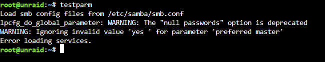

1 hour ago, Frank1940 said:
In the Terminal window, type this:
testparm
I think we've found the issue. Do you know what could be causing the error?
Edited by conermurphy
I suspect you have an extra character (perhaps, a <space>) after the "s" in 'yes '.  NOTE:  This file has a Linux/Unix file format (The EOL-- end of line -- character is a LF only where windows is a CR-LF.) and requires a Unix 'aware'  Editor if you are editing the file on a windows computer.  I use EditPad Lite.  It is free for home use and very friendly for use with Windows, Unix/Linux, and MacOS files which are CR.  It figures out (automatically) what is required regarding the EOL character(s).  I did double-check both of smb-extra.conf file on each of my servers to verify the format.
EDIT:  I suspect that smb.conf is one of those configurations files where syntax errors will cause the using program to crash somewhat ungracefully...
Edited by Frank1940
So I double checked the "Samba extra configuration:" in the Unraid UI and there was an extra space as you said, I've removed it, restarted the array and ran `testparm` again and got the below output. Hope it points to a potential fix as the issue is still present in Windows with this change.

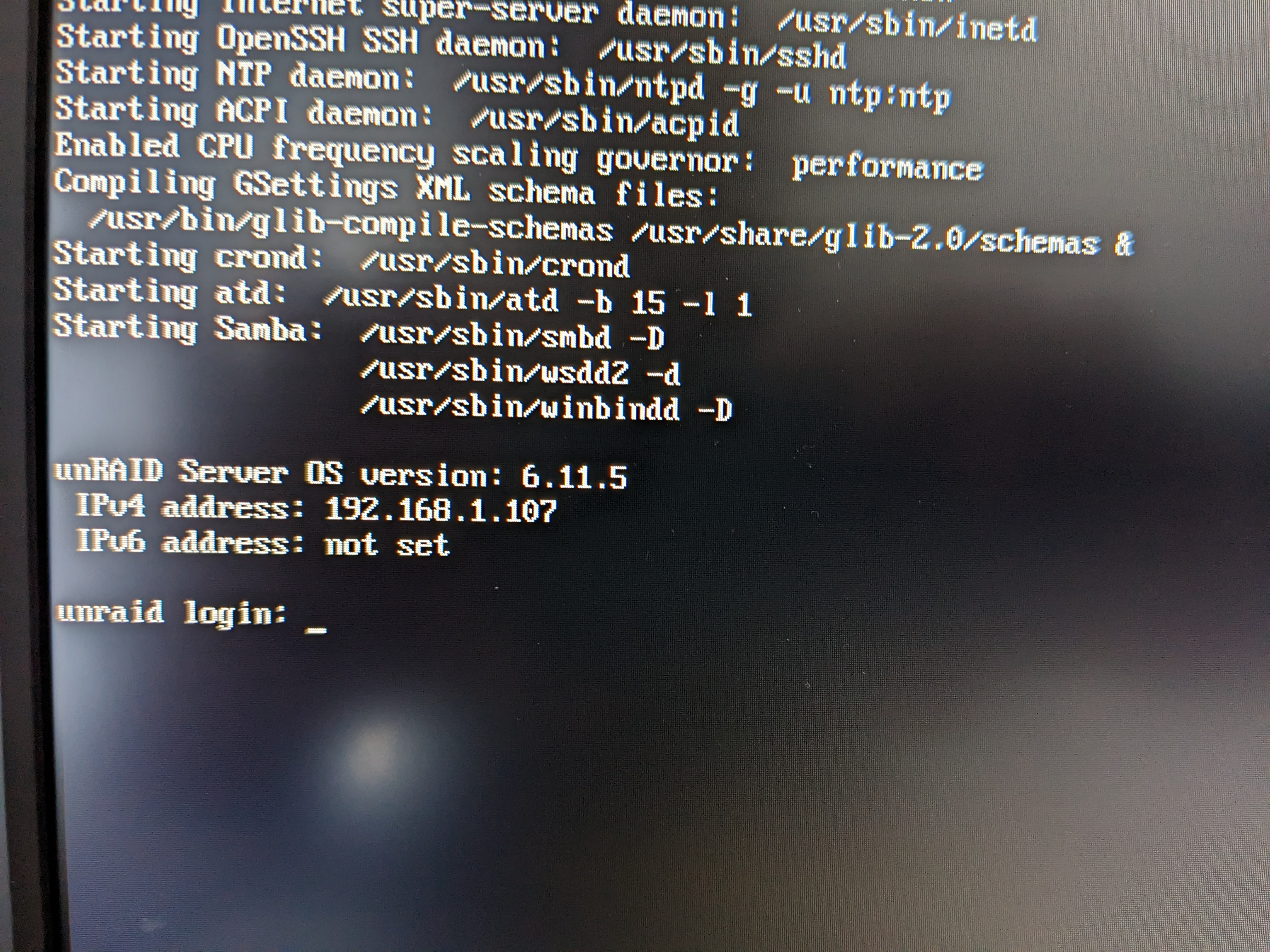

Hook up a monitor to your server.  It should have a login prompt at the bottom of the screen.  A few lines above that you should see a line that says
Starting SMB  /usr/sbin/smbd -D
Then two more indented lines of commands and then
unRAID Server OS version:  6.11.5
Following that will be the IP addresses of the server.
Are you seeing this?  If not, attach a new Diagnostics file in your next post.

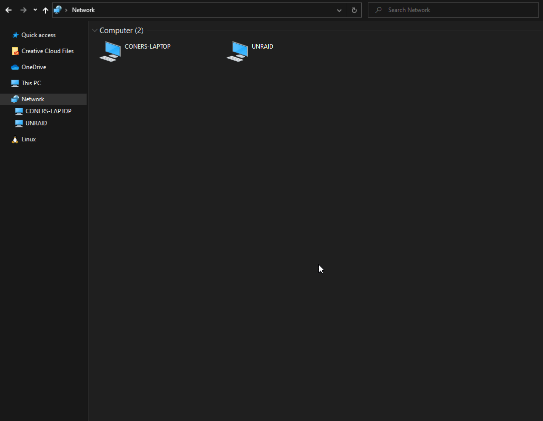

42 minutes ago, conermurphy said:
Something I did notice which I'm not sure is of note or not but my WIndows Explorer matches the "With SMBv1 Turned On" example on Page 5.
This happens if you establish a login/connection to a computer on the network even with SMBv1 turned off.  It is a hit-and-miss situation.  I have noticed that both of my servers are showing up this morning but it is really not a completely dependable situation.  (I have an ad hoc windows peer-to-peer network setup to eliminate sneaker netting but those computers never show up unless I 'hit' them from my Network Neighborhood setup.  Then they are there..)  MS has never (to my knowledge) explained how the 'Network' in Windows Explorer works or fixed it so it is reliable.  As a result, I tend to ignore it.  (Remember, MS considers that the Windows Server Software is the way to deploy networking for Windows computers.  What most folks (including the two of us) is a peer-to-peer networking scheme that goes back to Windows for Workgroups 3.11 introduced back in 1993.)
Not sure why but I had to restart the server to get any video output from it? I tried connecting to the dedicated GPU in it and the iGPU and got no video signal output. Rebooted and got one. Anyway, I can't see that line, I have a starting Samba line. I'll attach a photo of the screen below.
I do have both of these outputs as well.

10 minutes ago, conermurphy said:
Just tried doing this and then accessing the share again but no luck, same error as before.
You said you can see the server name under the 'Network' icon in Windows File Explorer.  What happens when you click on the server name in the left pane of Explorer?   (I would expect the share ("data" in your case) to appear in the right pane...)   If it does, what happens when you click on that share name in the right pane?
Unfortunately not, here is a recording of what happens. Same as if I click on the UNRAID item in the main panel itself.

I would suggest that you shutdown your server and run chkdsk on the flash drive to make sure that there is no obvious problem with those files (passwd, shadow and smbpasswd are the files that I think are involved..).
Is there any particular paramaters I should use with chkdsk, I ran it yesterday with /f and it reported no errors (see post earlier in the thread) but happy to try again with the same or other parameters if you think any are worth a shot in particular?
Although we're not quite there yet with the solution, just wanted to say thank you for all the help, I appreciate it.
That should be fine.  I just want to be sure that the problem is not an obvious file structure problem on the flash drive. (Unraid does not do a lot of reading to the flash drive but S..t does happen occasionally.)
Just ran chkdsk, seems to be all okay, see the output below.
I missed one thing:  The hardware spec states that the boot drive should be 32Gb or smaller.  However, I believe there is small wiggle room on this requirement but I don't recall what conditions have to met.  I am going to ping  @JorgeB to get his input.
