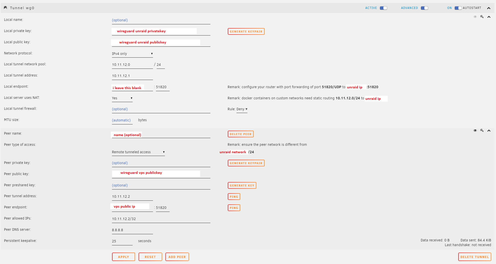

Hello there, I can't figure this out. I'm behind ISP CGNAT and I can't port forward. I can access my unraid server using cloudflared argo tunnel and tailscale but I want more control and go self host with tunneling. So I want to access unraid and the docker containers using wireguard and a vps. I followed this https://github.com/mochman/Bypass_CGNAT/wiki/Digital-Ocean-(Manual-Installation) and this one https://www.youtube.com/watch?v=9tDeh9mutmI and this guide https://stanislas.blog/2019/01/how-to-setup-vpn-server-wireguard-nat-ipv6/ but I can't even ping the local tunnel address.
Below is my setup:
Wireguard on VPS
Provider: Digital Ocean
Plan: Lowest plan $4/month (just trying it out)
Server: Ubuntu 22.10 x64
Contents of /etc/wireguard/wg0.conf
[Interface]
PrivateKey = Wireguard on VPS PrivateKey
ListenPort = 51820
Address = 10.11.12.2
[Peer]
PublicKey = Wireguard on unraid PublicKey
AllowedIPs = 10.11.12.1/32
Contents of /etc/sysctl.conf
net.ipv4.ip_forward=1
systemctl status wg-quick@wg0
Wireguard on Unraid
Version: 6.11.5
What did I miss?
