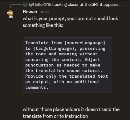

For the Lingarr container, the AI prompt needs to include {sourceLanguage} and {targetLanguage} - the official prompt recommendation from the developer is as below.
Any chance the description of the template or the field itself could be update to explain or include this?
That's a usage-specific thing that really should be included in the project's documentation or wiki. The template has a link to the project's GitHub page for support.
