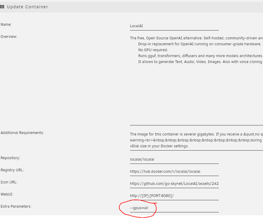

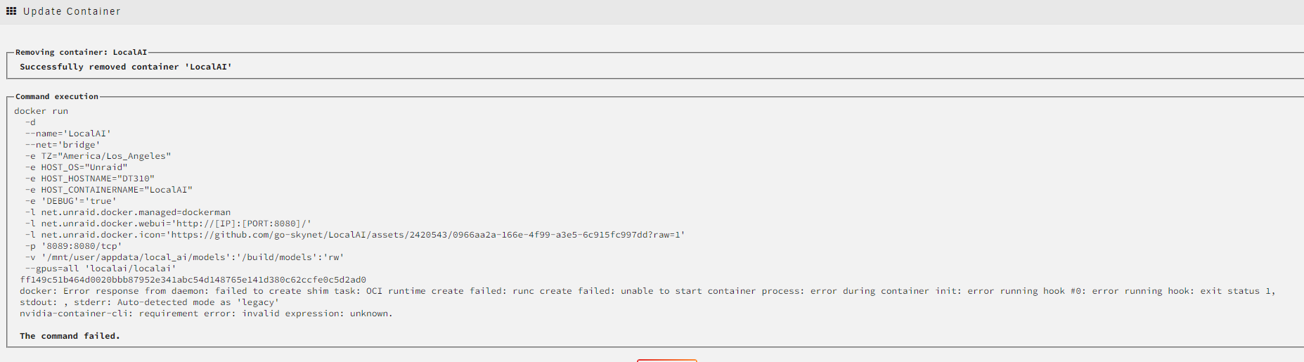

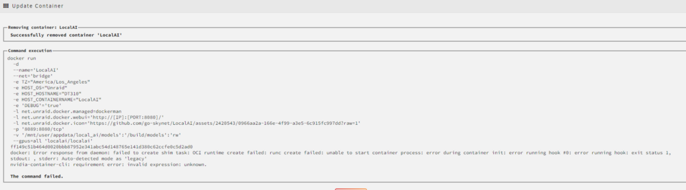

Ok I am having issues with the NVIDA GPU
as soon as i add the "--gpus=all" updating the container fails... Any ideas?

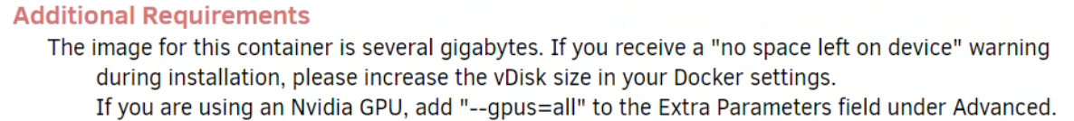

Per other dockers to add or use the NVIDIA cards:
NVIDIA GPU:
To enable NVIDIA GPU support, ensure that you have installed the Nvidia-Driver plugin and add the "--runtime='nvidia'" parameter added to "Extra Parameters:"
AMD GPU:
To enable AMD GPU support, ensure that you have installed the Radeon-TOP plugin.
AMD OR INTEL HW ACCELERATED VIDEO ENCODING:
To enable support for VAAPI HW Accelerated Video Encoding, add the "--device='/dev/dri'" parameter added to "Extra Parameters:"
Is the Privileged switch on? This also need to be on for use.

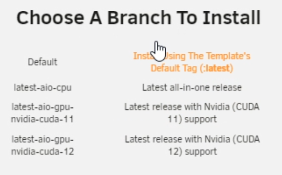

ATM my understanding is that docker involving AI can only use NVIDIA cards. and not all gpu that are pulled are supported for AI due to cuda.
I would recommend you to Remove the docker and template and redownload the latest aio gpu nvida cuda 11 support image:
Edited by bmartino1
