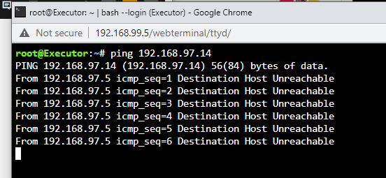

The second connection is between 2 Unraid boxes and it is not working.  Unraid1 is connected via 97.5 and the Unraid 2 is connected via 97.11.  Ping from Unraid1 to 2 I get ' Destination Host Unreachable'.  Ping from Unraid 2 to 1 It just stalls and doesnt ping.  I checked the routes on both and they look fine.  Attaching the diags for both.  Unraid1 is Executor and Unraid2 is Venator.

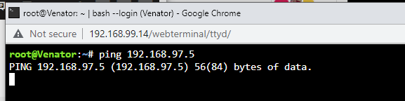

When I try to ping unraid to unraid it just hangs, not errors:  image.png.9486b1b04ff08641c29995e35cfc1367.png
But on unraid1 I do get an error:
NIC is reporting no link, it will never work without a link detected.
