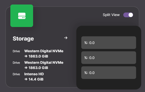

Hi, how can i show the correct Storage Size, it showes me 0
There is an answer on Discord:
Well you need to mount the host into the container, you are only mounting some path in your user directory. That mount is not optional. https://getdashdot.com/docs/install/docker-compose
but i don't understand how i have to do it.
Thx 4 helping me out

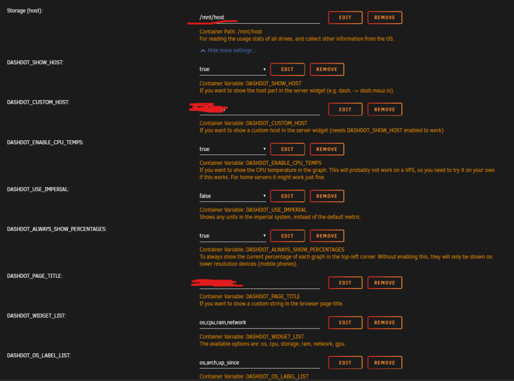

Hi, thanks for the question.
The current version of the template has this mounting point: https://github.com/manuel-rw/unraid-templates/blob/8dbfed6e4d30850456da3ec31f8d9f9cb0d32b5e/templates/dashdot/dashdot.xml#L37
Do you maybe run an older version of the template?
If you don't mind, can you post a screenshot of your mount points here?
i just installed it from the Appstore in Unraid but i guess it should be the latest

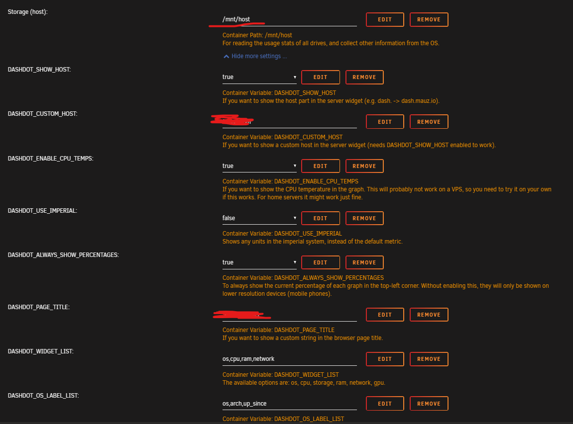

Sure, its just /mnt/host i guess
But i canceld the Sorage in DASHDOT_WIDGET_LIST, because the HDD's won't go into spindown.
Is it possible that it need to run a while ? i got planty Storage Space 4x 16TB 1x3TB and 3x1TB Plates
Thanks for helping me out
Edited by eLpresidente
Thanks for posting it. I updated the template and I think this should fix the issue you're having.
Unraid Apps refreshes each few hours to the new templates - so please wait a few hours until it updated.
To update please remove the entire container and create it again using the "Apps".
