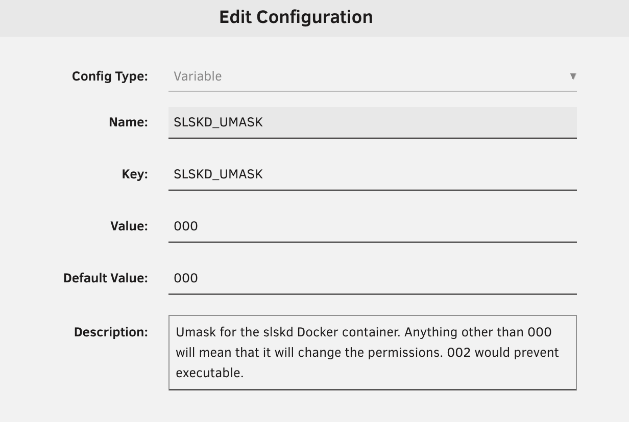

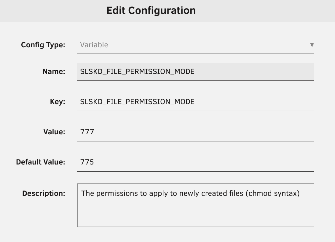

On 3/13/2025 at 4:21 PM, jademonkee said:
As per the documentation, I also had to create two variables in the Docker UI:
SLSKD_UMASK with value 000
SLSKD_FILE_PERMISSION_MODE with value 777 (to match Unraid's default perms)
Did you also add these? It's hard for me to diagnose your problem when I don't have a clear understanding of what your settings are.

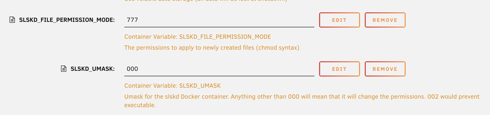

Sorry last one, just because im stil fairly new at tinkering like this, do i add these values like below?
I have mine set up like this: (note that those are my own notes under "Description." Though it wouldn't hurt for you to add them, too.
