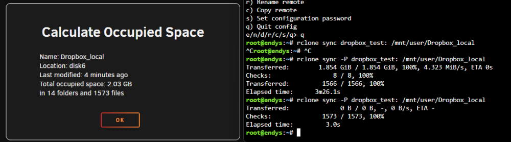

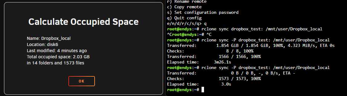

I tested mine one at the moment in the meanwhile with another account where there's no important data and it seems it works without any issue!
image.thumb.png.928ae9d3dd527d6f6d4d7c852b5bd074.pngimage.png.93541dcda29e65f44bdda1da6f1c501f.png
