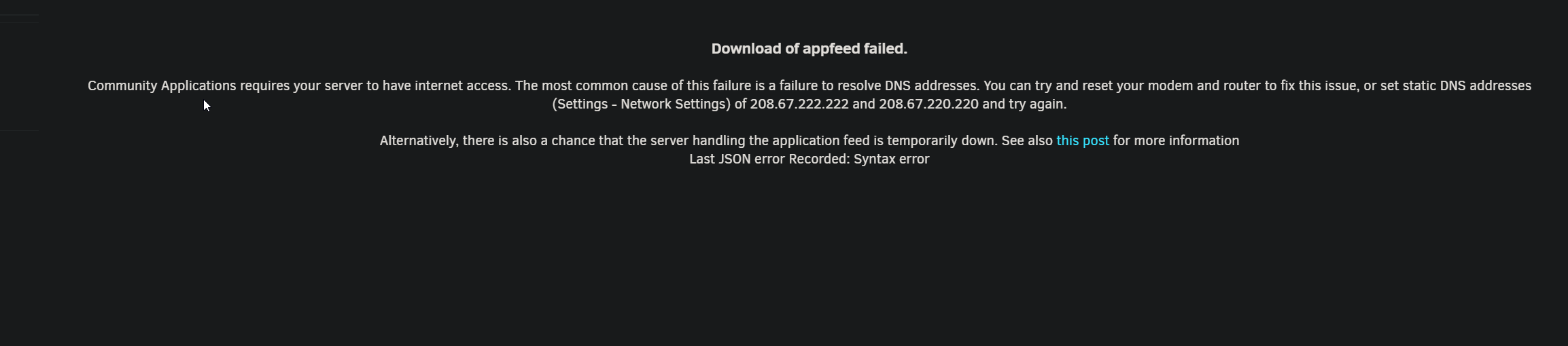

I upgraded my server yesterday with a new motherboard and CPU and now it can't resolve DNS anymore. All my docker containers and VM's work fine but I can't access things like the apps tab.
I've tried chancing the DNS in the web UI a couple times but that didn't help and I couldn't find any other options that seemed relevant

curl ifconfig.io
curl: (6) Could not resolve host: ifconfig.io
