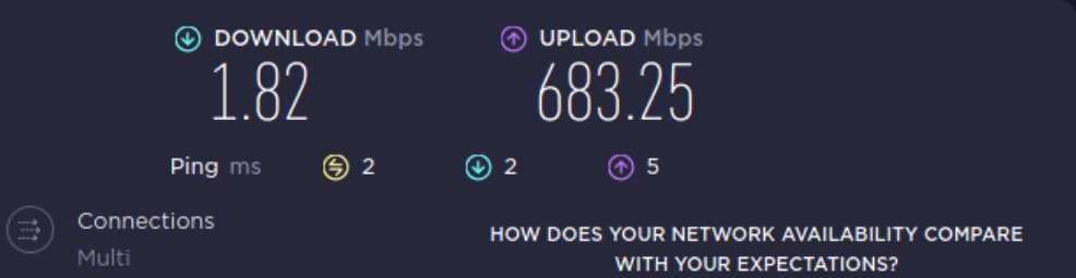

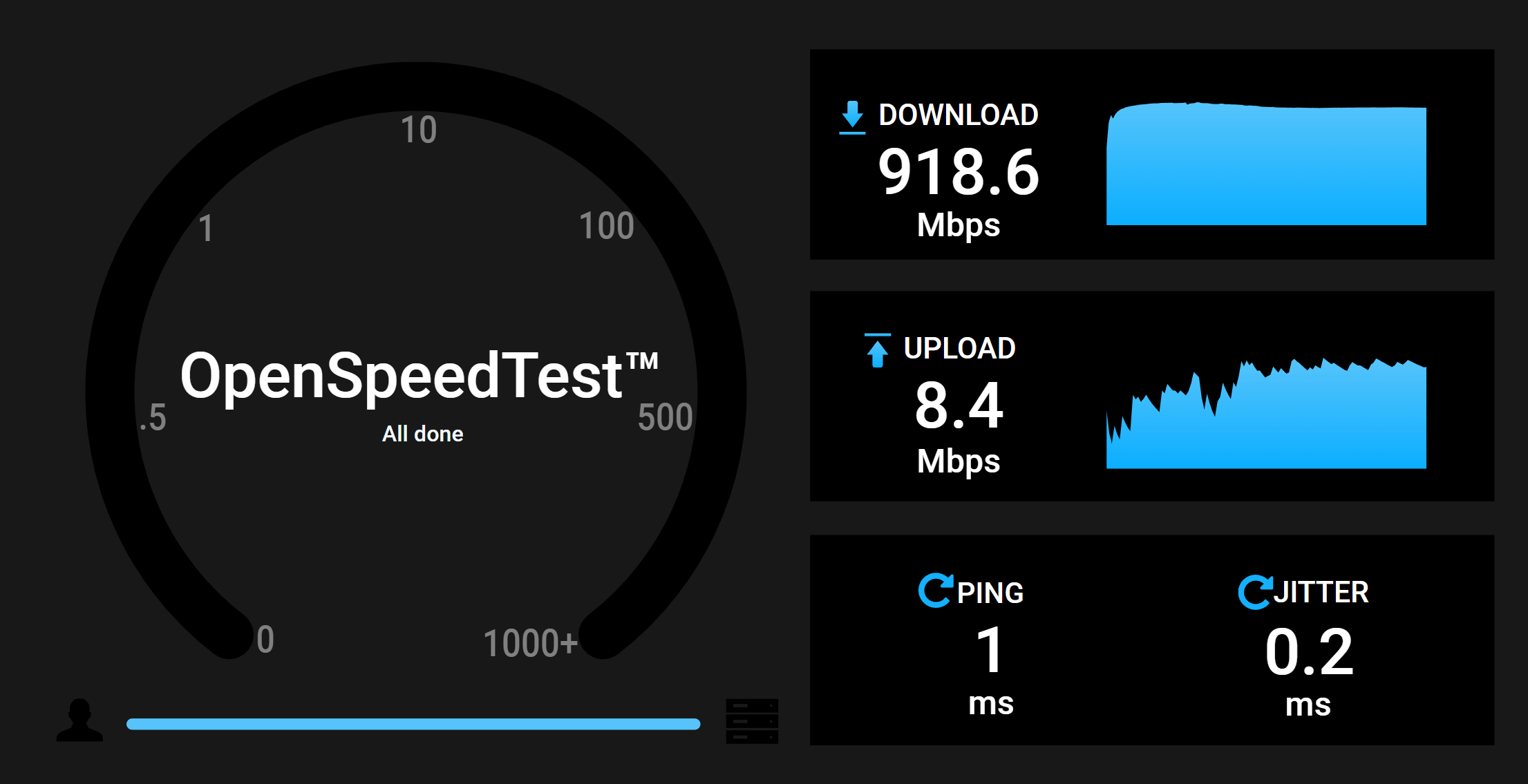

Lately I've been experiencing frustratingly slow (5-15mbps) network connection over ethernet. However what's strange is that only the inbound connection is slow, and outbound traffic is not affected. This has been reproducible using many different devices to connect to Unraid as well as a speedtest.net result from a VM running on the server. I'd also like to clarify that the server used to run at full speed in both directions, but the file transfers became slow more recently, though I can't pinpoint it to a specific release due to my set and forget tendencies.

OpenSpeedTest result from another PC over LAN:
Speed test from VM running on this server:
