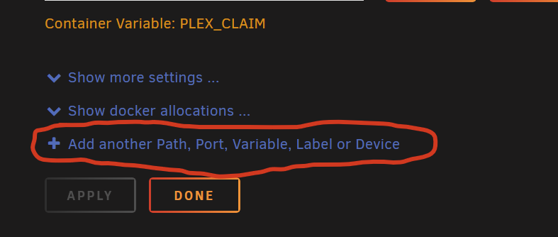

1 hour ago, MarkMcG said:
I do not have an option of, 'Nvidia Visible Devices' to add the GPU id, my question is how do I add this?
Edit Plex docker container, then add another variable:
Edited by Hoopster
Many thanks, I originally added a 'Device' - it crashed!!  Will try adding as a variable and respond how it went. 🙂
