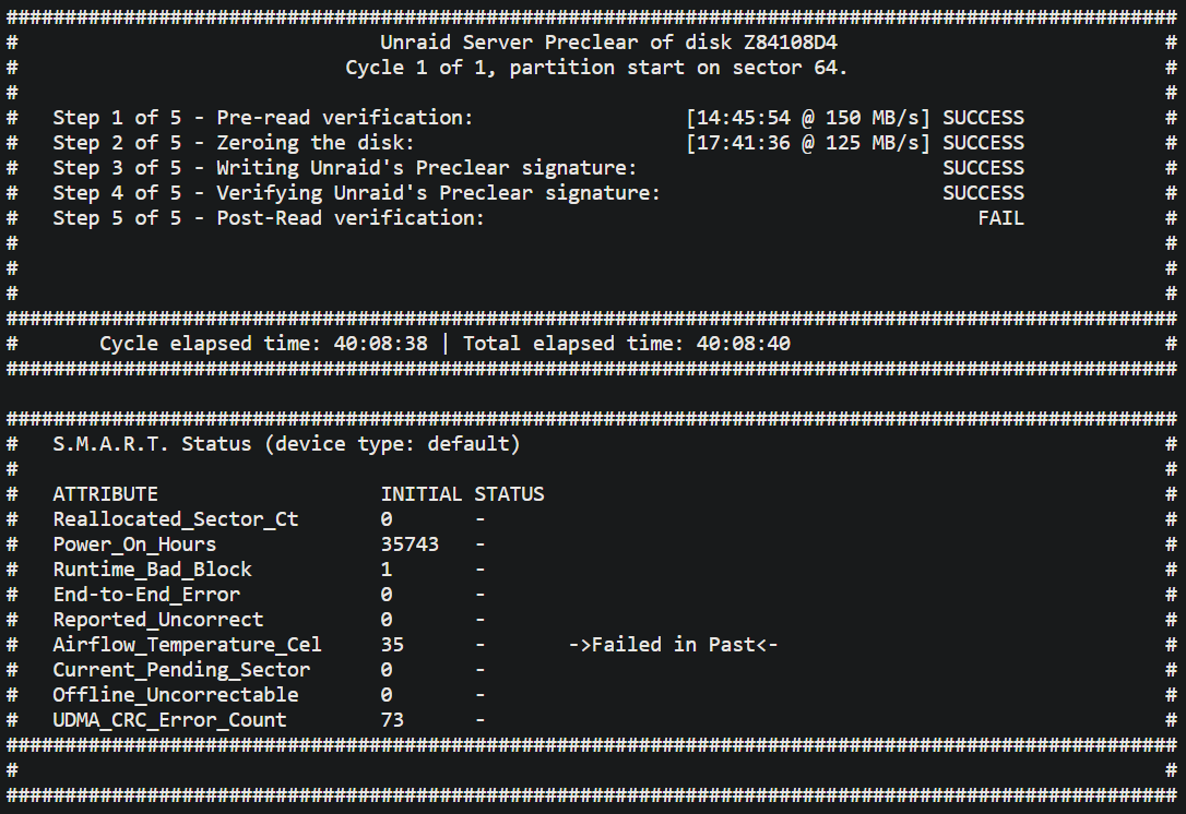

Moved an 8TB disk from my main server to new HP Gen10 Plus Microserver to Preclear to re-use. The disk has been working fine in my main server for years. It had 73 historic UDMA CRC error count already, but as far as I'm aware that's more a cable issue and not anything to get too worried about.

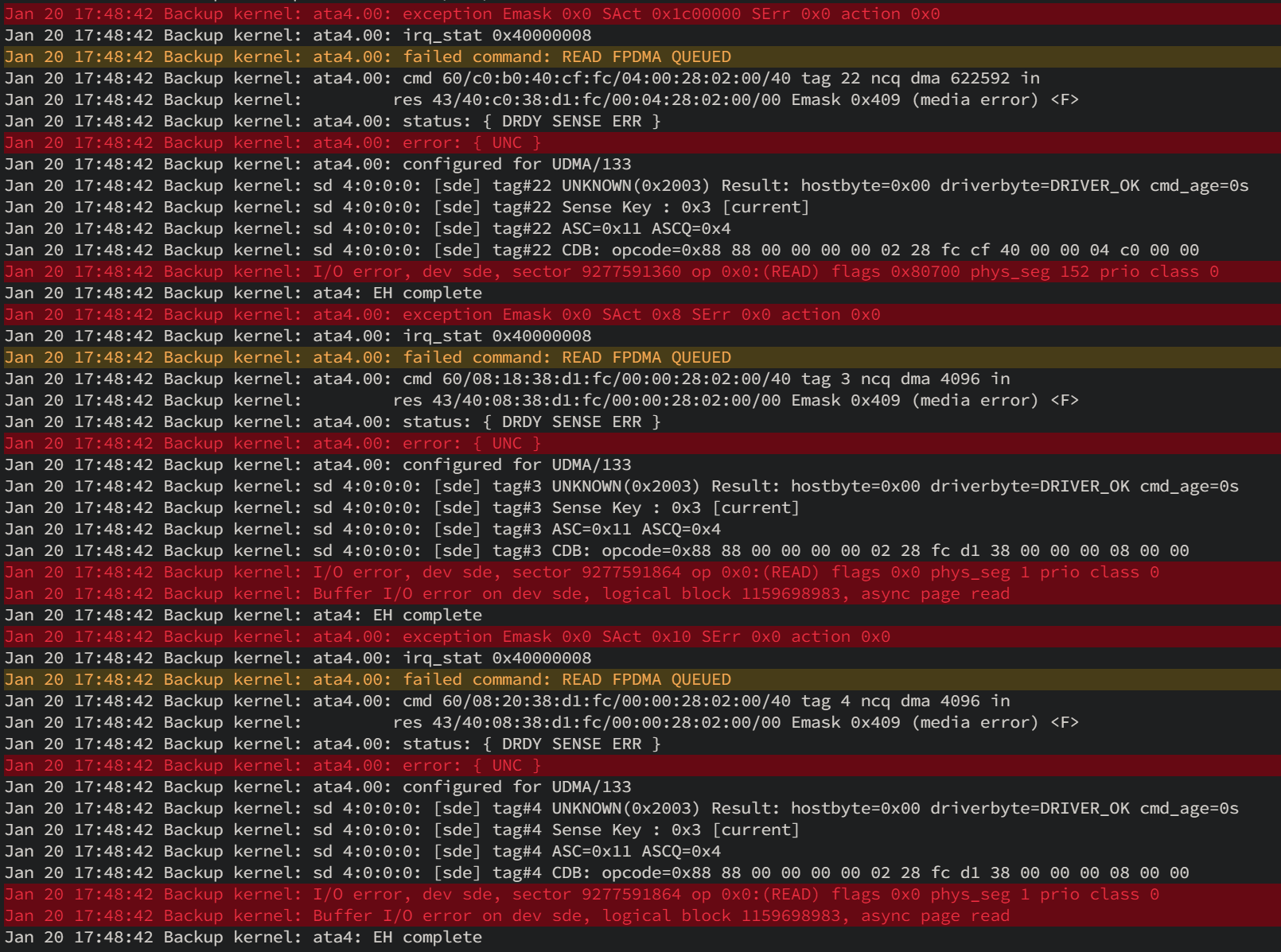

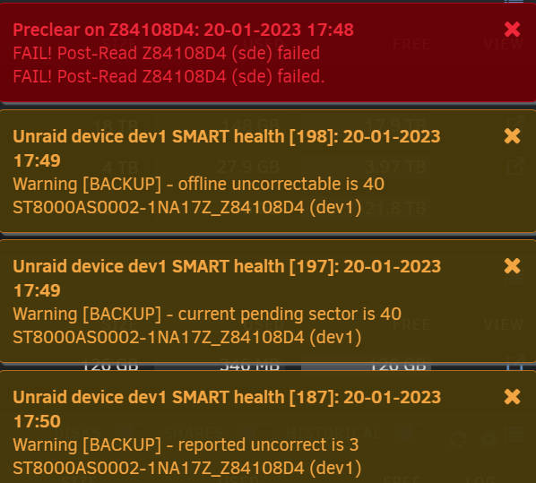

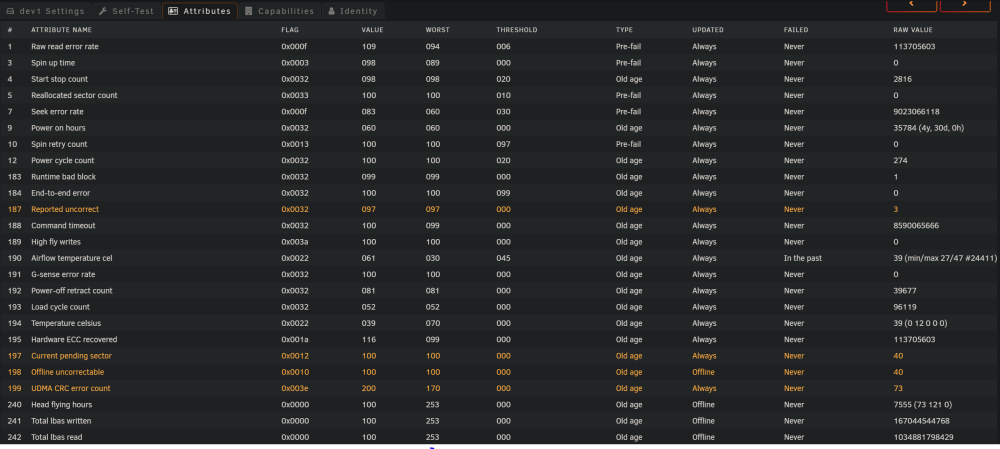

Preclear was going fine until about 60% into the post-read when it failed due to reported uncorrect, current pending sector and offline uncorrectable SMART errors.

Based on SMART replace it.
