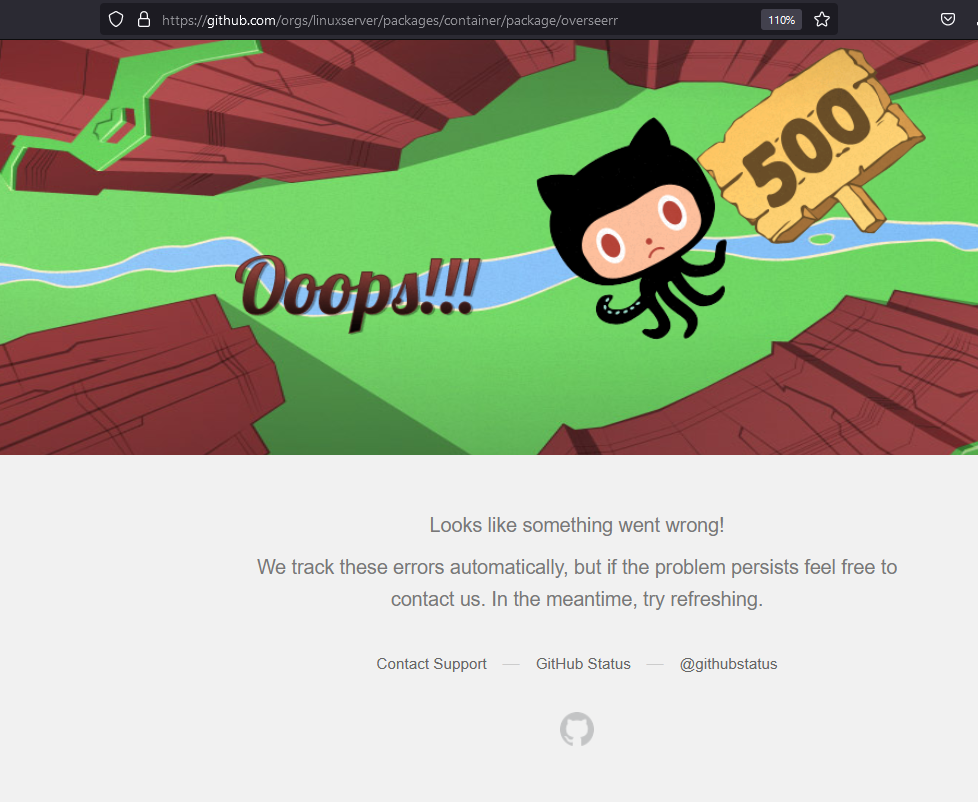

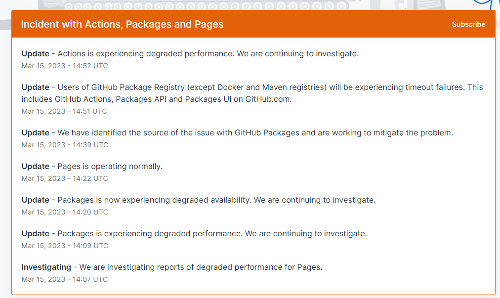

I have 7 that are showing "not available" but they're all github and it looks like github is having issues right now:
Edited by neodata686
