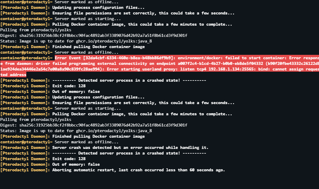

So everything works fine BUT Pterodactyl run docker containers for the servers and it need to asign an ip to it. The problem is Pterodactyl cannot give the docker container an ip and gives this error image.thumb.png.094a8fc7dcd5ff0764c3759be9c53091.png
here is the text : Error Event [32da4cbf-6334-460e-b8ea-b48bb86df9b9]: environment/docker: failed to start container: Error response from daemon: driver failed programming external connectivity on endpoint a007f2c4-b1cd-4b27-b0b0-eb8de5f04332 (b90f20fbe43332c26122d81ae924dea34446e2a54c7e00a8a90c839fc28ae994): Error starting userland proxy: listen tcp4 192.168.1.134:25565: bind: cannot assign requested address
Usually this means one of your running docker services allready uses the 25565 port. It can be another minecraft server or any app you run on the same vm
nothing else is using the port 25565

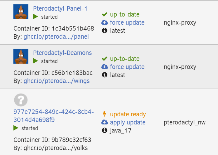

Mine is running perfectly directly on unraid image.png.19f8c66dc312227bee6eafc9cffcde8f.png
If you're interesed there is a great post to guide you: https://docs.ibracorp.io/pterodactyl-docker-1/ (but I do sugest to follow the written version and not the video)

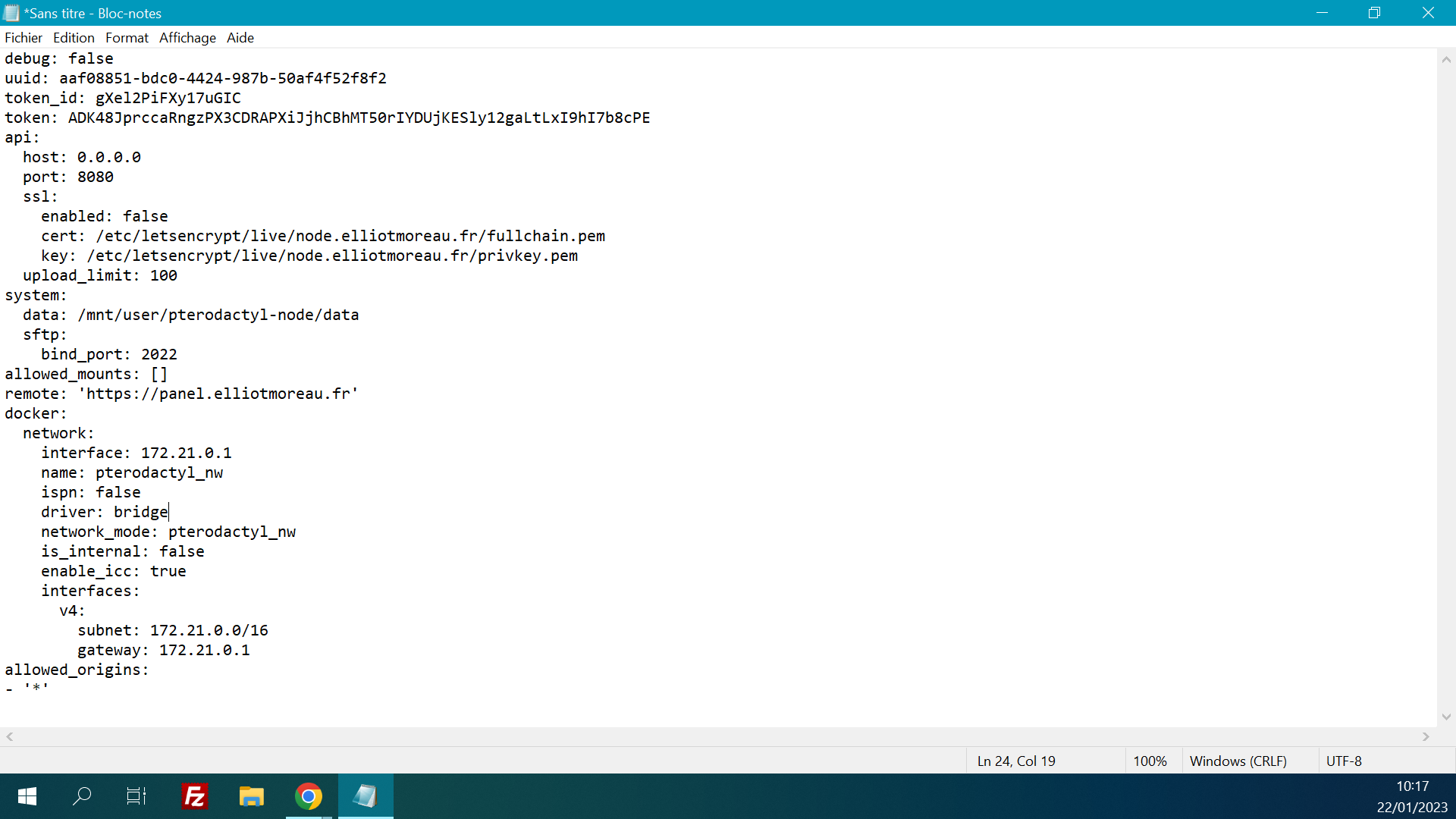

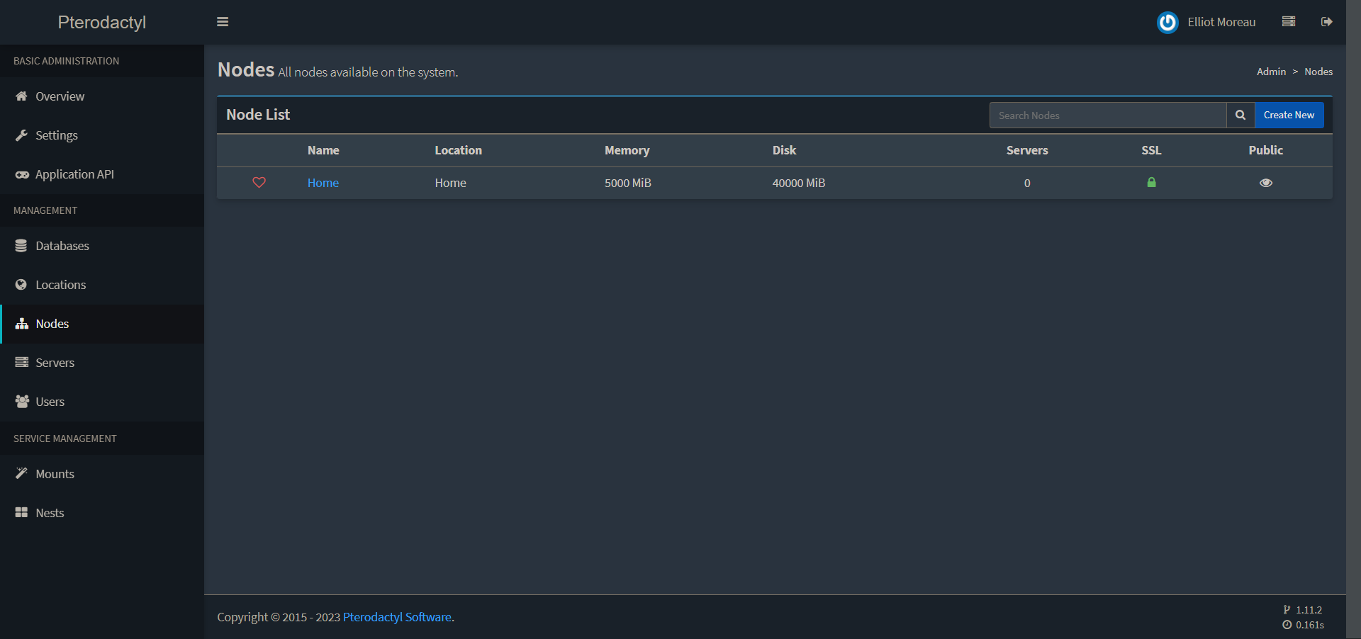

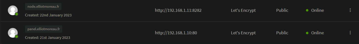

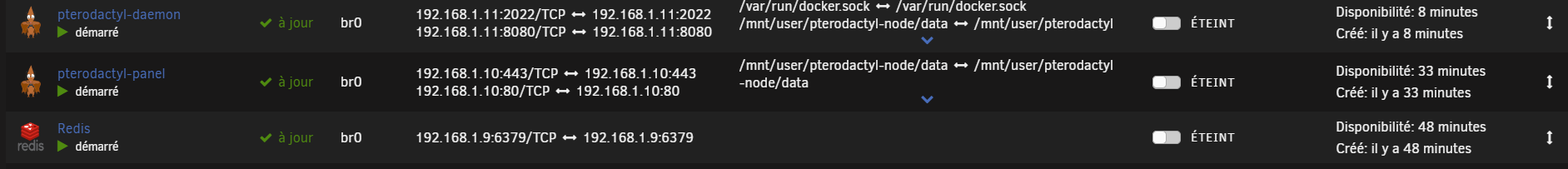

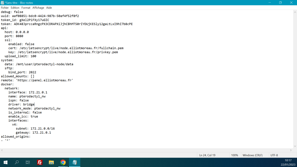

It's not working for me
image.thumb.png.0279e13396ac08a4fcb2272783714e77.pngimage.thumb.png.1bc8002c7d5811e07610fd9d4e604592.pngimage.thumb.png.cab5a24634f39c6f98c60802431363d2.pngimage.thumb.png.cd40f284cb6b0ec29ee4529fa5cfa91f.pngimage.thumb.png.132305d4a49d91bc6510705a588305d8.png
I see some mistakes, you've indicated a network that you're not using. I've send you a dm to give you further help.
