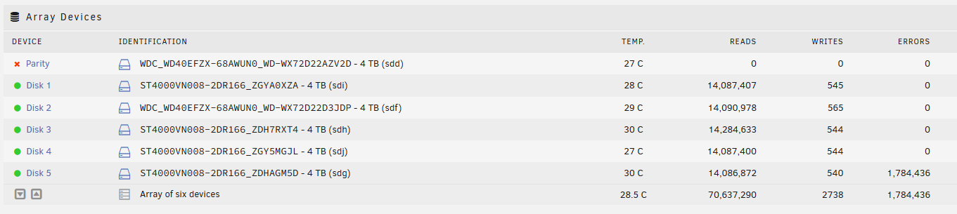

Running a "read-check" and now I'm chasing errors on another disk. I guess the next step is switching cables around, but it's so odd that it's been multiple disks in the system, and as of now, I haven't changed any of the cables, just reseated them.
No point in letting that continue. Fix the problems so you can rebuild parity

Well, I thought I was in the clear, but I have errors on two disks again. One is brand new, and the other is a bit older. I'm thinking the first step may be to replace the SATA breakout cable. I haven't used any SATA connections on my motherboard however, so maybe I switch them to there to make sure it's the cable?
Thoughts?

I'm not sure what they are either... I did power off the server and put the two disks experiencing errors on SATA cables attached to the mobo, instead of the SATA card, and it's running a parity check. The interesting thing is it's running WAY faster. It's been running a half an hour, and it's already 10% complete, with 5 or so hours left... The last one that ended up erroring out, was estimated to take almost 2 days. My gut is thinking one of my breakout cables may be going bad.
4TB should only take 8-12 hours if things are working right.
