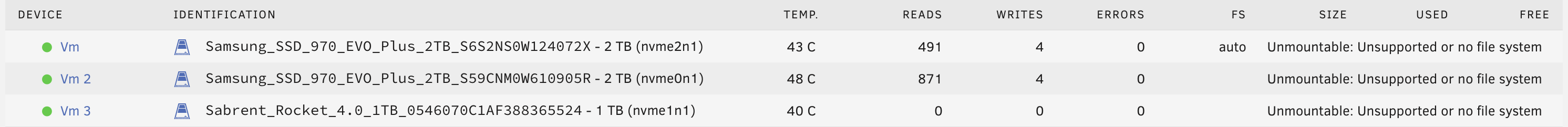

28 minutes ago, MenacingMight said:
Ok I did that, but I don't think it worked.
That's only for a pool reset, your pool has one or more missing devices, do you have it/them?
I dont know what drive it is talking about. All 3 drives are added. This problem started off similar to MatSalamon. I removed a drive from my pool and later tried to add it, but the pool wasn't working. Is there a data corruption?
Edited by MenacingMight

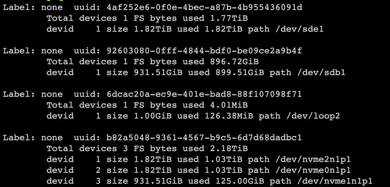

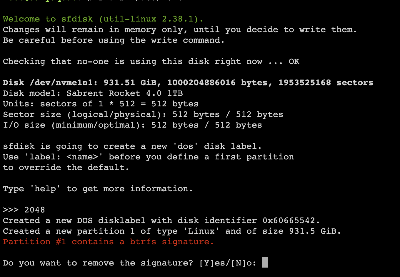

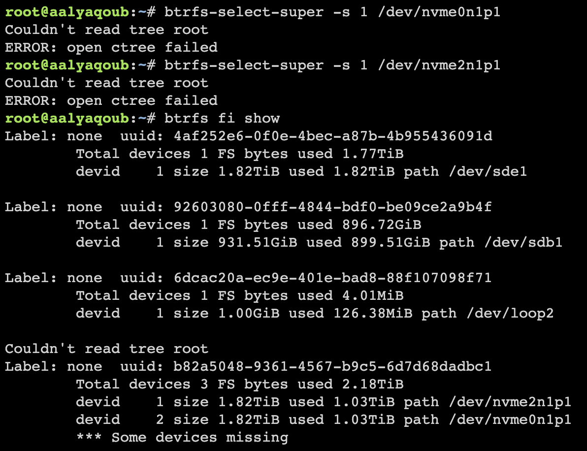

I assume this was a non-redundant pool? Post the output of:
btrfs-select-super -s 1 /dev/nvme1n1p1
root@menacingmight:~# btrfs-select-super -s 1 /dev/nvme1n1p1

The partition is gone, type
sfdisk /dev/nvme1n1
then type
2048
and hit enter, post a screenshot of the result.
