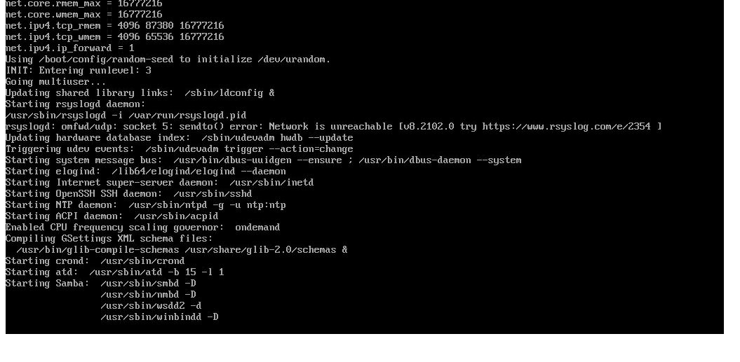

After a successful boot at the end you are prompt to login. For a year or so this has disappeared for me.
The server boots just fine but why I do not see the login prompt. Anyone knows why?

This started back in the day when I had an Nvidia GPU, it started doing that when we used to have those Unraid-Nvidia versions... I do not know if that helps.
