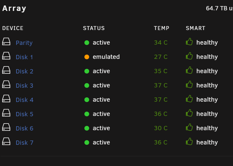

Do any of your disks have SMART warnings on the Dashboard page? (save me the trouble of examining every SMART report).

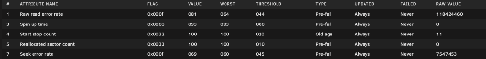

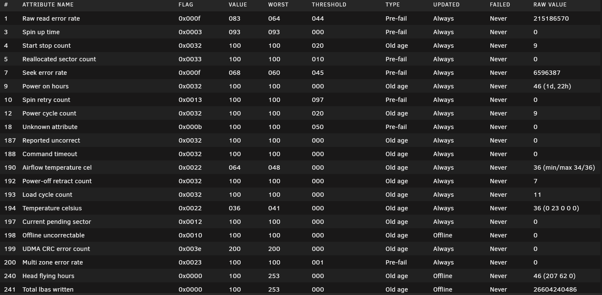

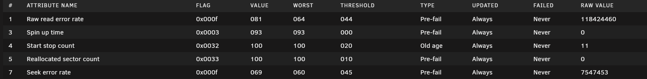

I have the original disk. I just mounted it, and it's replacement outside the array to SMART test it and it's erroring pretty badly. It's running an extended SMART now.
I ran an extend SMART on all drive yesterday to trouble shoot and no issues. Including the new disk.

One more thing worth mentioning is that both of these drives, the failed one and it's replacement, are Renewaed drives from Amazon. https://www.amazon.com/gp/product/B0BLJVKQKJ/ref=ppx_yo_dt_b_asin_title_o00_s00?ie=UTF8&psc=1 The first one failed Smart the second I installed it but i foolishly continued with it and within a month, the system got completely unstable with it just being present. It';s the one with the SMART errors i posted.
The replacement is the warranty replacement, still renewed, but it's passing SMART. It is throwing some errors though.

Yeah sorry. I hadn't seen these errors and the dashboard shows it as passed smart. It doesn't show the drive as healthy because it shows it as emulated. Are you also thinking it's also just a bad drive?
Suggest trying with a different Unraid release, like v6.10.3, current kernel might not like your hardware, if the same happens with v6.10.3 then it would suggest a hardware problem.
Are you sure you're talking about the Dashboard page? You might have to spinup drives to see the thumbs-up thumbs down indicator.
SMART report for all array disks looks fine.
@trurl - correct. All green checks. I was confusing the Emulated orange dot with the green check, but it doesn't report as failed and when i ran the smart test it was, and is still saying passed. Despite that, the drive is getting a lot of Raw read error rates and seek error rates. The other drives all show zero while the number on this drive is climbing.
