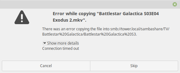

When moving files from my Linux 19 pc to teh samba share on my server I randomly get a timeout error.

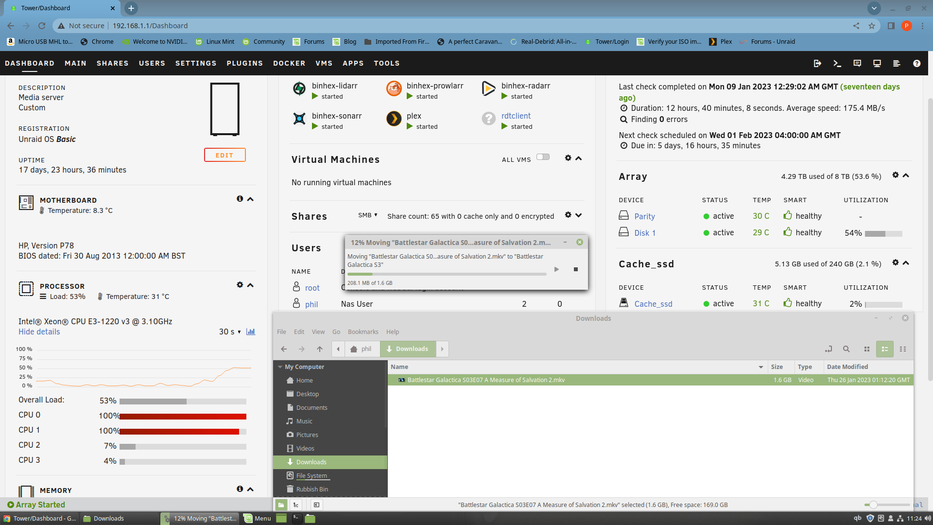

The PC is part of my network which runs on Unraid (screenshot attached)
I am in the process of putting my DVD collection on my server to be able to watch anything anywhere using Plex. However, I do this on the PC and then have to transfer the files to the samba share. Randomly it will error during the transfer and as of yet I have not been able to determine what exactly causes the time-out.
The strange thing is if I try the same file transfer again it sometimes times out again or it might go uninterrupted.

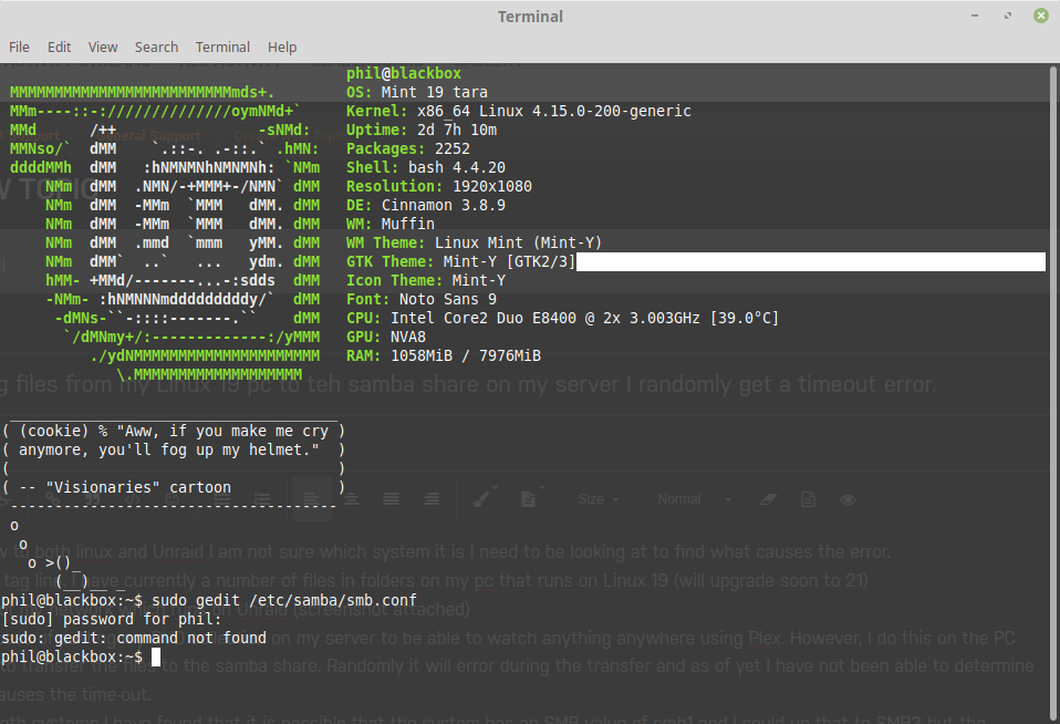

Being new to both systems I have found that it is possible that the system has an SMB value of smb1 and I could up that to SMB3 but the command that I have found that should enable me to change the smb.conf file gives a command not found in my terminal
Any help (in layman's terms) would be greatly appreciated.

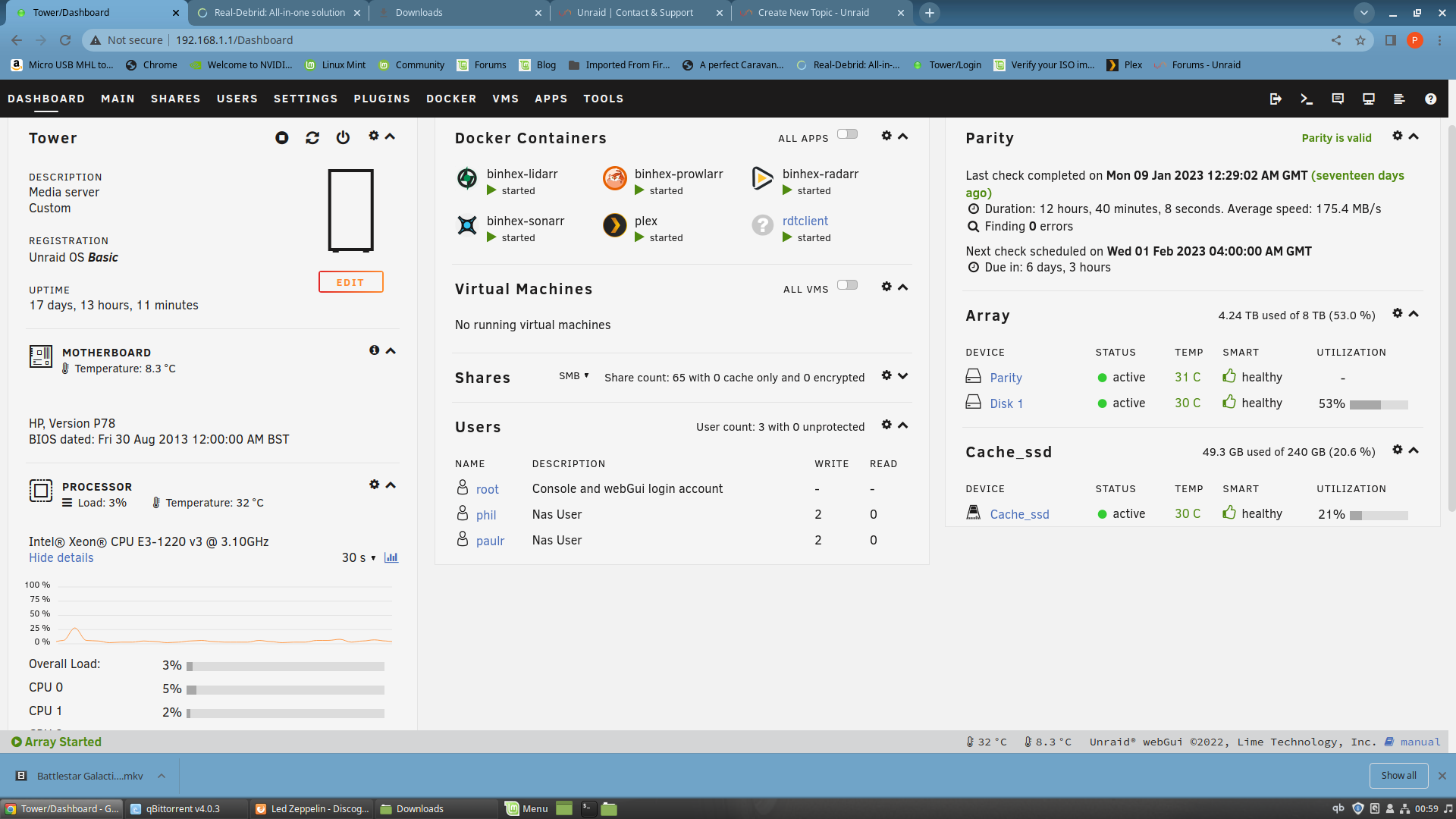

tower-diagnostics-20230126-1126.zip
Not seeing anything relevant logged, suggesting the problem might no be on the Unraid side, do you have another client you could test with, like a Windows desktop or laptop?
