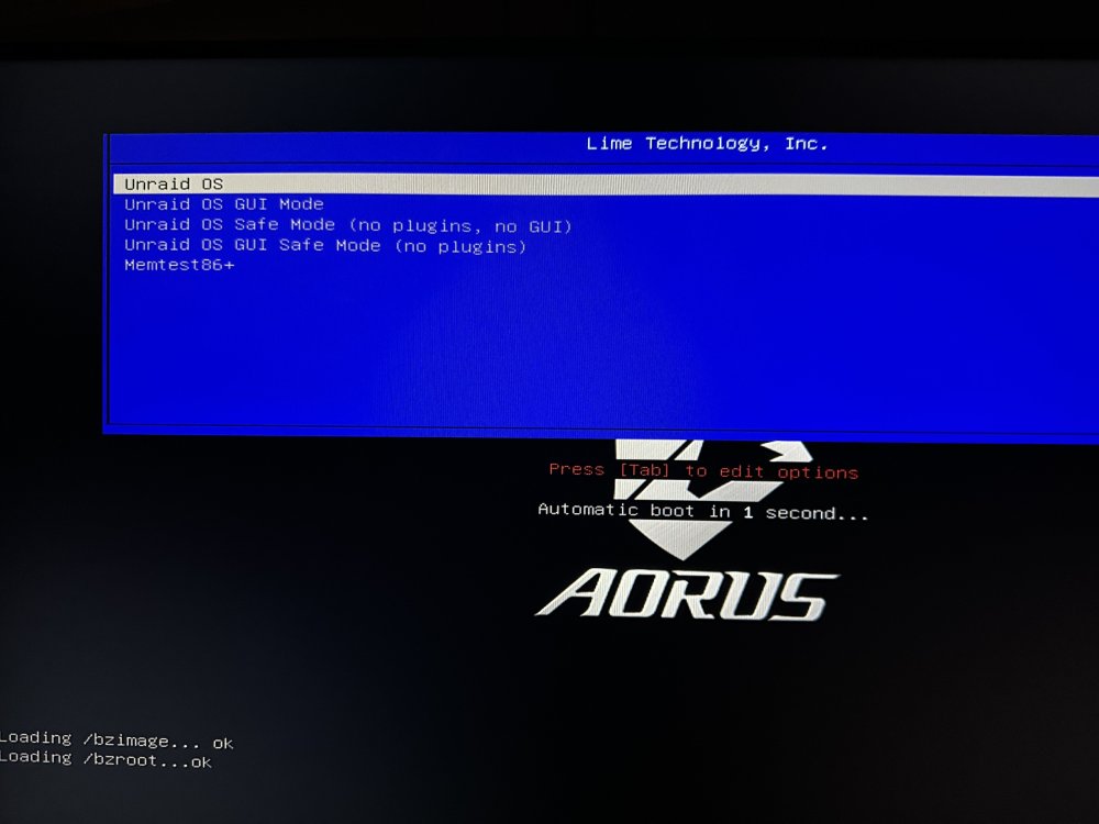

I was having tons of issues getting the OS to load, tried with a fresh setup on the same flash drive but just sits here and gets nowhere. Memtest all day yesterday tells me all the RAM is fine, not sure if all the data on my array is lost but I can’t even get the OS to load at this point.
Solved by trurl
Every array drive in an Unraid system is a self-contained file system that can be independently read on any Linux system.
Well that’s good at least
Try a different flash drive with a fresh install.
Okay. If that works I need to transfer my key, right?
Ideally, you need to transfer your whole config (config folder from flash), which is all settings from the webUI including disk assignments.
Do you have a current backup of flash?
I grabbed the config folder before I overwrote my current flash but I’m not sure if it’s something in there causing issues.
You can edit config/docker.cfg and config/domains.cfg to disable Docker and VM Manager, then boot in SAFE mode so no plugins will load and see how it goes.
Please don't mind me, everyone. I'm just a f***ing idiot. After I ran memtest I also updated my BIOS and that reset the clock. I corrected the time and everything is working. I'm going to go die of embarrassment now.
