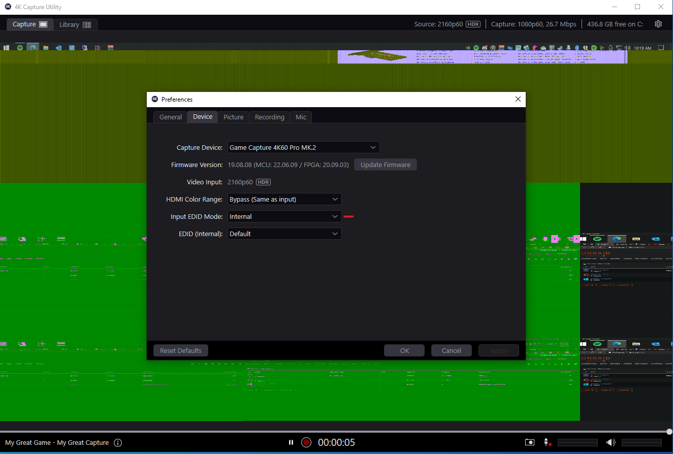

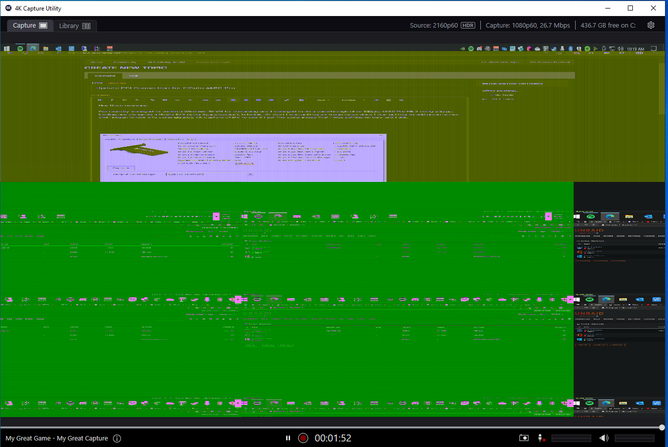

I've recently managed to create a Windows 10 VM for streaming and I managed to do a passthrough of an ElGato 4K60 Pro Mk.2 using vfio-pci binding and alongside a Nvidia 970. At start I was getting an image issue since I was getting an odd green screen and I began to look into using ElGato's 4K Capture Utility to see if I got the same image that I was getting on OBS and I did...

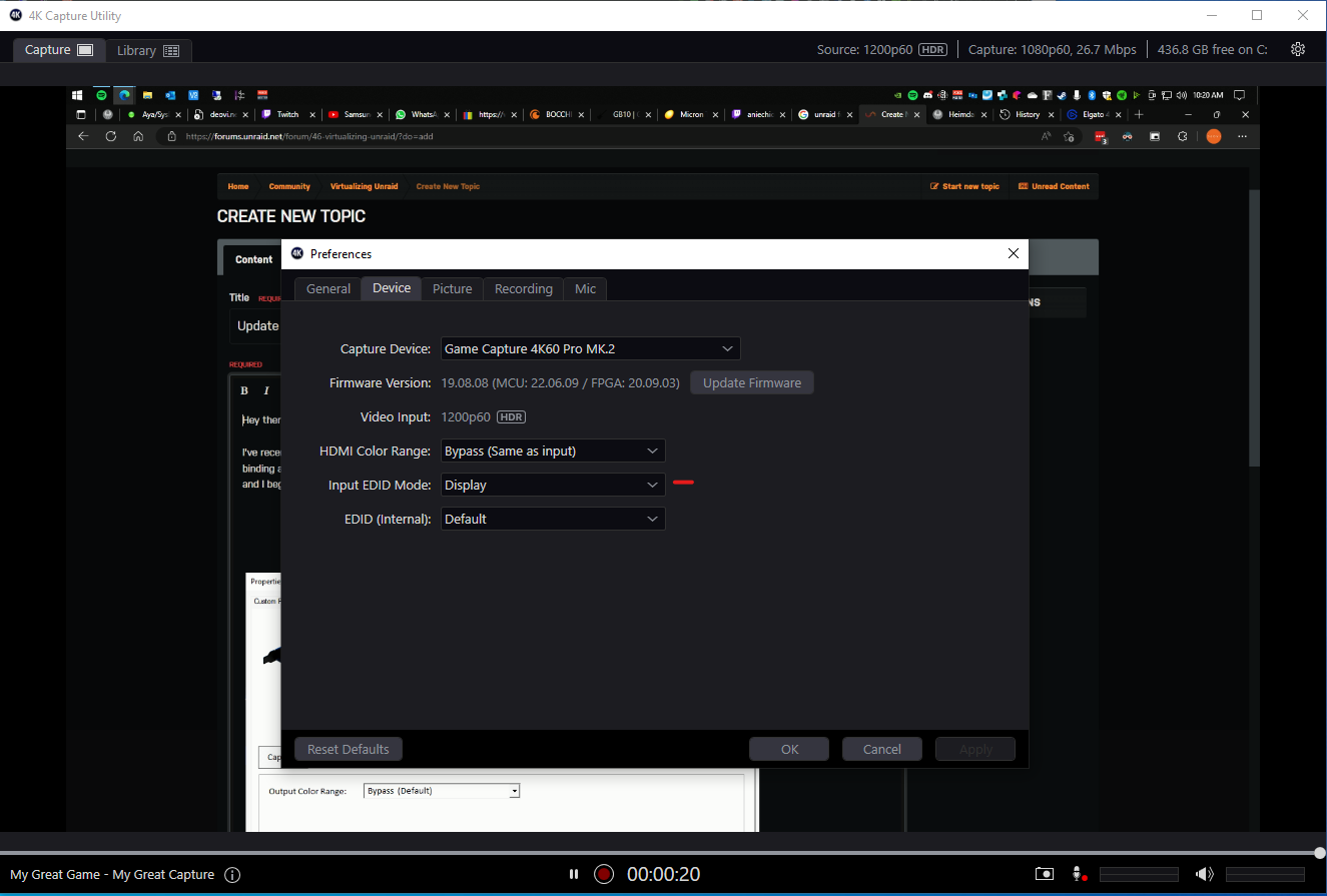

I started looking into the setting I noticed that if I changed the EDID mode to 'Display' the error would be fixed.
Now, here's what I found so far and where I'm asking help. After looking into the matter, I realized that if you go to higher resolutions, the capture card will not work correctly. That EDID mode pretty much states the resolution of the capture, and the 'internal' capture is 4K. When it goes that high, it doesn't work giving the green bars from the image above. I tested this by trying to capture a high-resolution display and it gave the same issue.

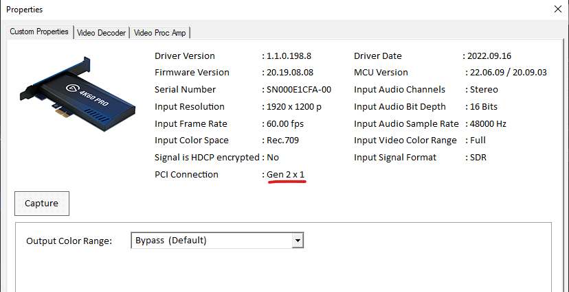

I looked up this error, and lucky enough I think I found the problem. It seems that the VM that was created is not passing in the Capture card with the correct PCI-e Bus. I checked the motherboard specs, and it says that that all PCI-e slot is a Gen 3, it shouldn't be a problem (Asus ROG STRIX B550-F GAMING second PCI-e slot).
Here's the discrepancy I'm trying to resolve. The ElGato Documentation states that the card should sit on a Gen2x4 connection. But mine is registered as Gen2x1.
Is there a way I can change the specs on how the card should be passed through and force it to be the correct PCI GEN?

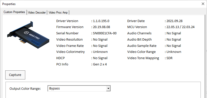

You can find the link in the original post, what it says is
Check PCIe lane Speed
How to check which PCIe speed 4K60 Pro MK.2 is using in software.
1) Download and install OBS Studio.
2) Open OBS Studio
3) In the sources box, click the + button or right-click
4) Select Video Capture Device and give the source a name
5) From the dropdown menu, select Elgato Game Capture 4K60 Pro MK.2
6) In the properties area, click on Configure. The 4K60 Pro MK.2 driver panel will open.
7) Look for the PCI Info and ensure it reads as Gen 2 x4
