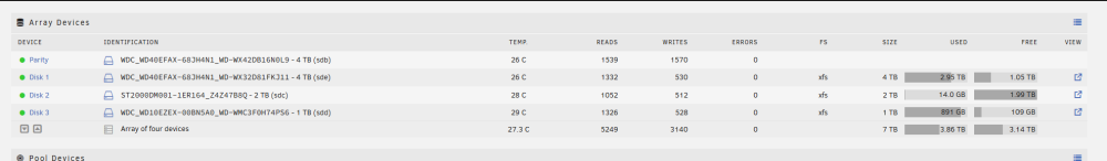

My 4TB drive that has the majority of my data right now is showing a ton of errors, but I just checked and it now is showing as an unassigned device even though the array is running. My docker containers also refuse to start. Can anybody help?
https://imgur.com/a/9n2jcyZ
No point in continuing with parity build with that many disk1 errors
attach diagnostics to your NEXT post in this thread
You have completely filled log space with entries about the bad connection on disk1.
Check connections, all disks, both ends, SATA and power, including splitters.
Try again to build parity. You should see lots of reads of all array data disks, lots of writes to parity, zero errors on all disks.

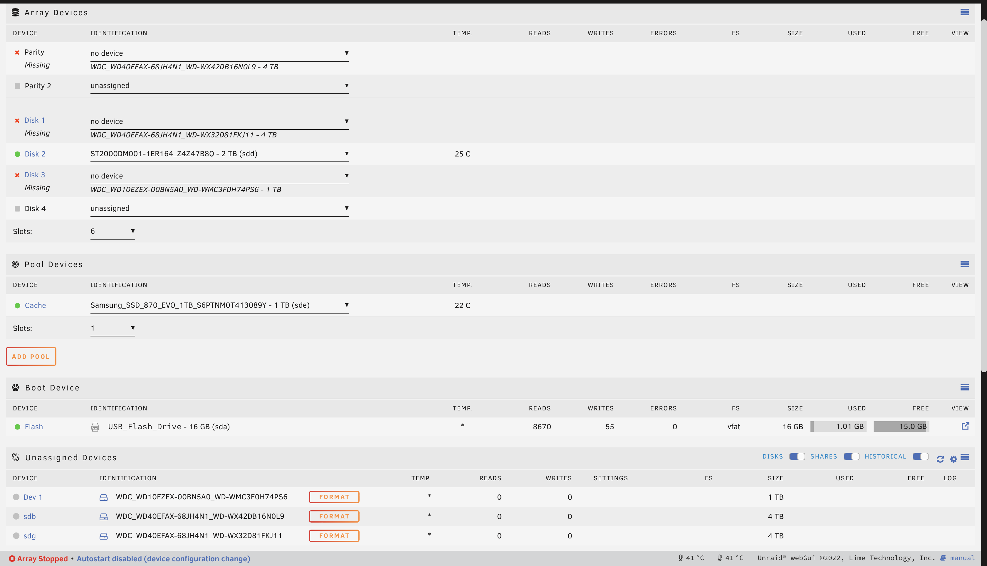

I got it to boot but the drives are not appearing again and I'm not sure why. If I go into BIOS I can see them all there.

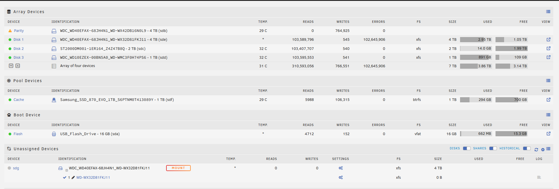

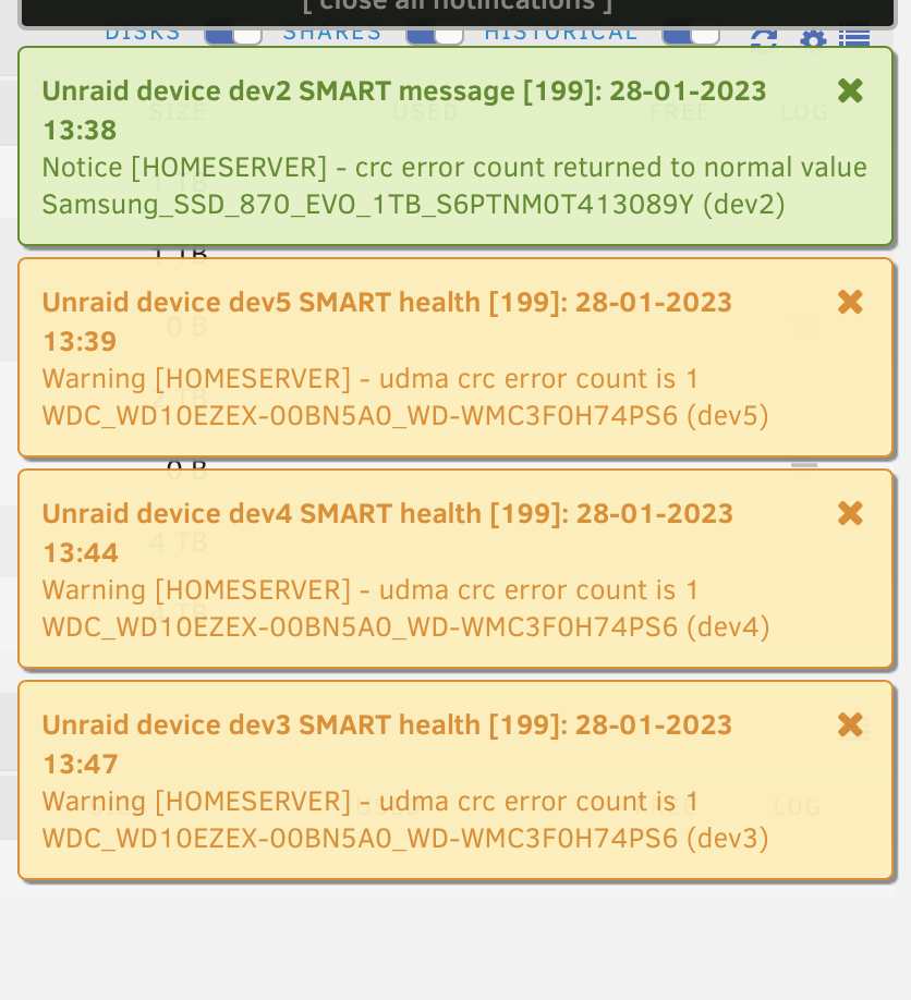

If I do a new config, every drive shows up as an option but then slowly become unavailable and return to unassigned devices. Diags coming in next post.
222084472_Screenshot2023-01-28at1_47_35PM.thumb.png.fb6a6f4aec7828ce8389a3fee87afd39.png
Looks like problems communicating with all disks. Are you sure you don't have a power problem?

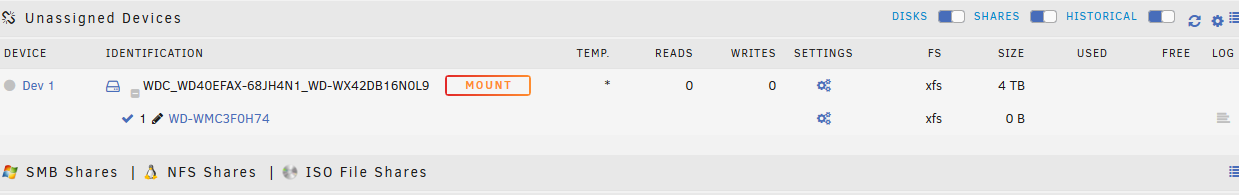

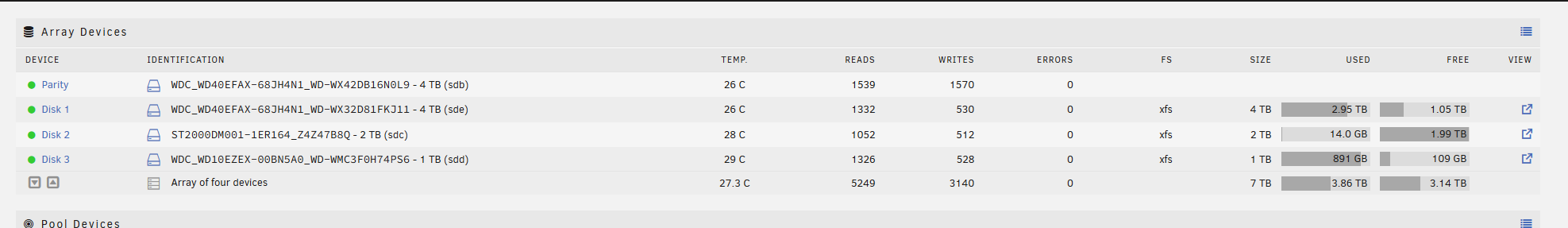

Tried to rebuild and now its in unassigned devices again image.thumb.png.6f3b0677249bee07e55d62c75c07d4f3.png
Ok so I've tried a few things and the drive is just stuck in a "format" state in unassigned devices. Formatting it fails. I can reboot the server and get it to show back in as an assignable device but when I try to assign it, it goes back to an unassigned device. Im now starting to think that this drive is dead? image.thumb.png.f0f97259f3e14ec2c52331f23c9ea9ab.png
