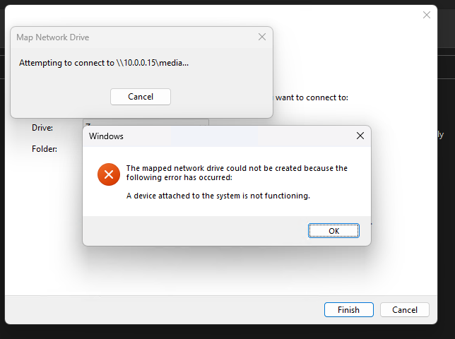

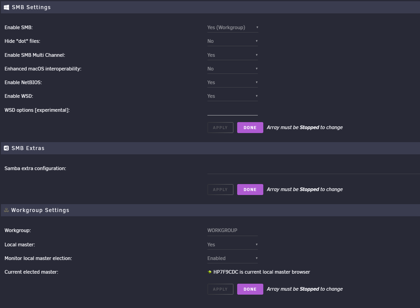

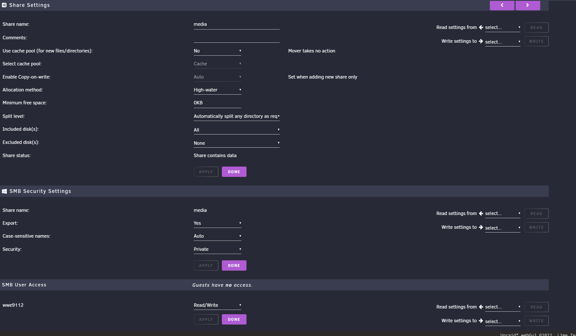

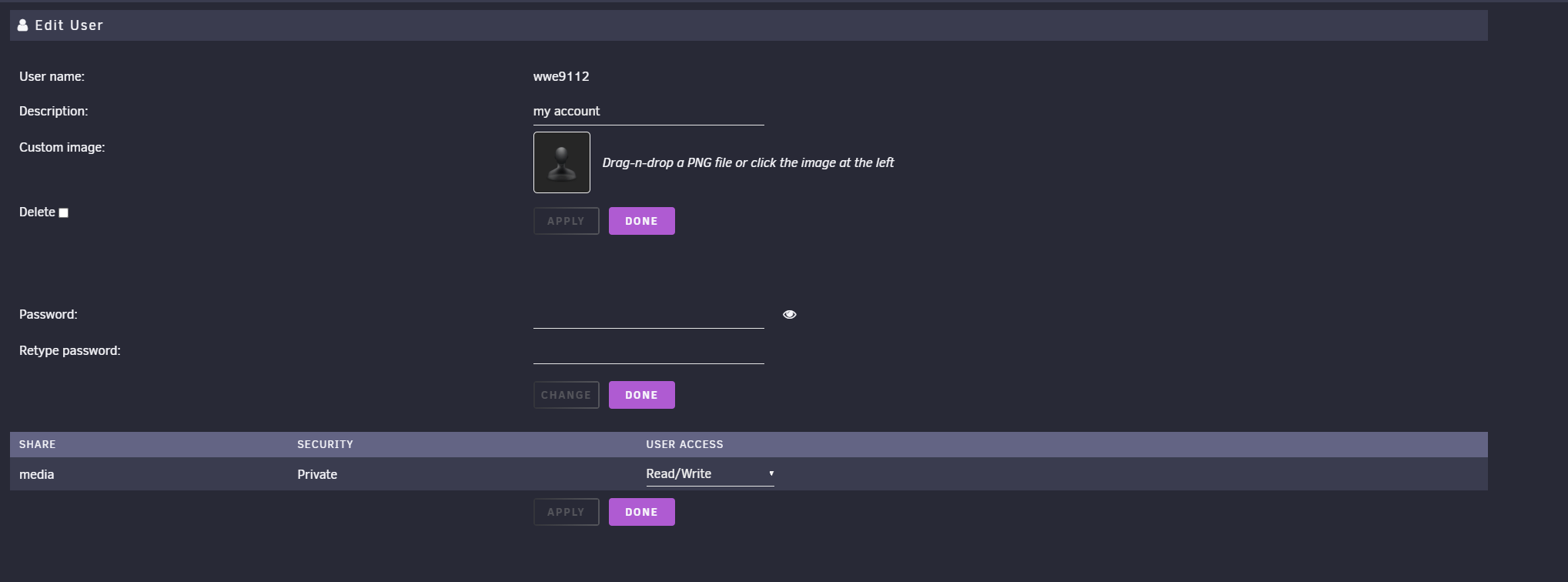

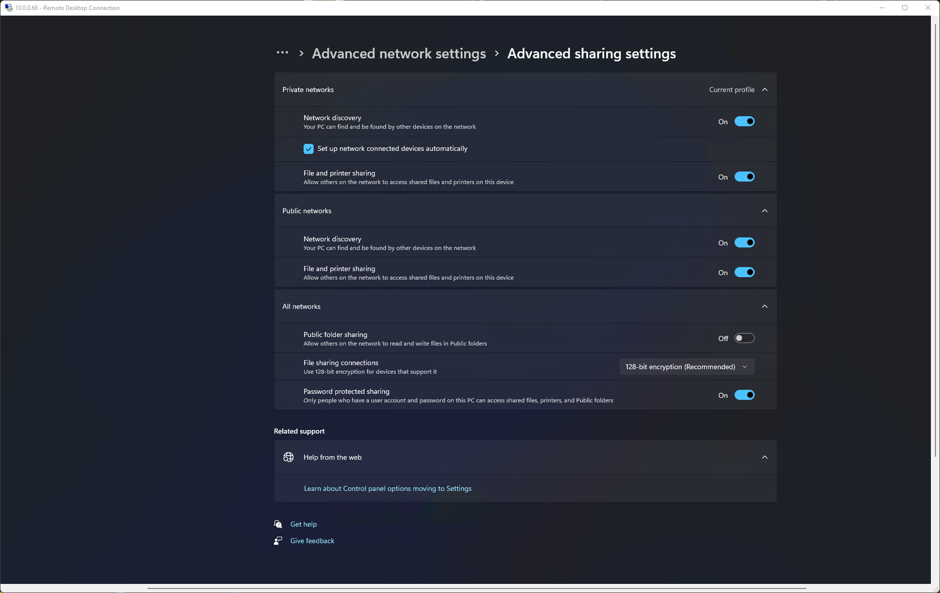

I'm still on my trial I think I have like 24 days left or something.  Literally the entire time I've had unRaid, I've ben fighting trying to get SMB to work. See screenshots:
In addition to the attachment settings I've tried the following:

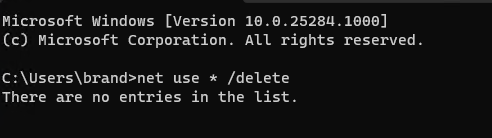

6. net * /delete (which didn't matter obviously lol)

5 minutes ago, wwe9112 said:
accessing it via root
root does not have any special permissions for network file access. rpot is treated just like any other anonymous user. Should be able to work with public shares though.
resetting the directory permissions
How? Tools - New Permissions on the share in question is the only way you should do this.
Your screenshot showed a private share. Set a share to public, clear credential manager, then try to access the share.

here is another screenshot I just grabbed after getting frustrated and typing the login 4 or so times
Forget about mapping a drive for now. Can you see the shares on the network using the server name or IP address?

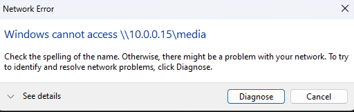

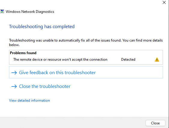

4 minutes ago, trurl said:
Forget about mapping a drive for now. Can you see the shares in using the server name or IP address?
I cannot. I get the attached error and when I run the troubleshooter, i get the other error.

I did, I get the same loop i spoke about earlier. After a few tries, it throws an error stating the device isn't working, other times it throws an error stating that the network login attempt failed.

SMB is tricky once you get an error message. One thing to do is to open a Windows 'Command prompt' Terminal and type the following command
net use * /delete
This will knock all current server connections.
net use * /delete
I just did it again and it didn't help.  I tried it as admin too.
Another thing I just tried was to set all the shares to private. I also created a test share set to private. Assigned the user wwe9112 to it, the share still fails to be accessed. I even tried to change the password to something more complex. Moreover, I updated the Windows credentials to reflect the change. It is still failing, well, both shares are still failing.
