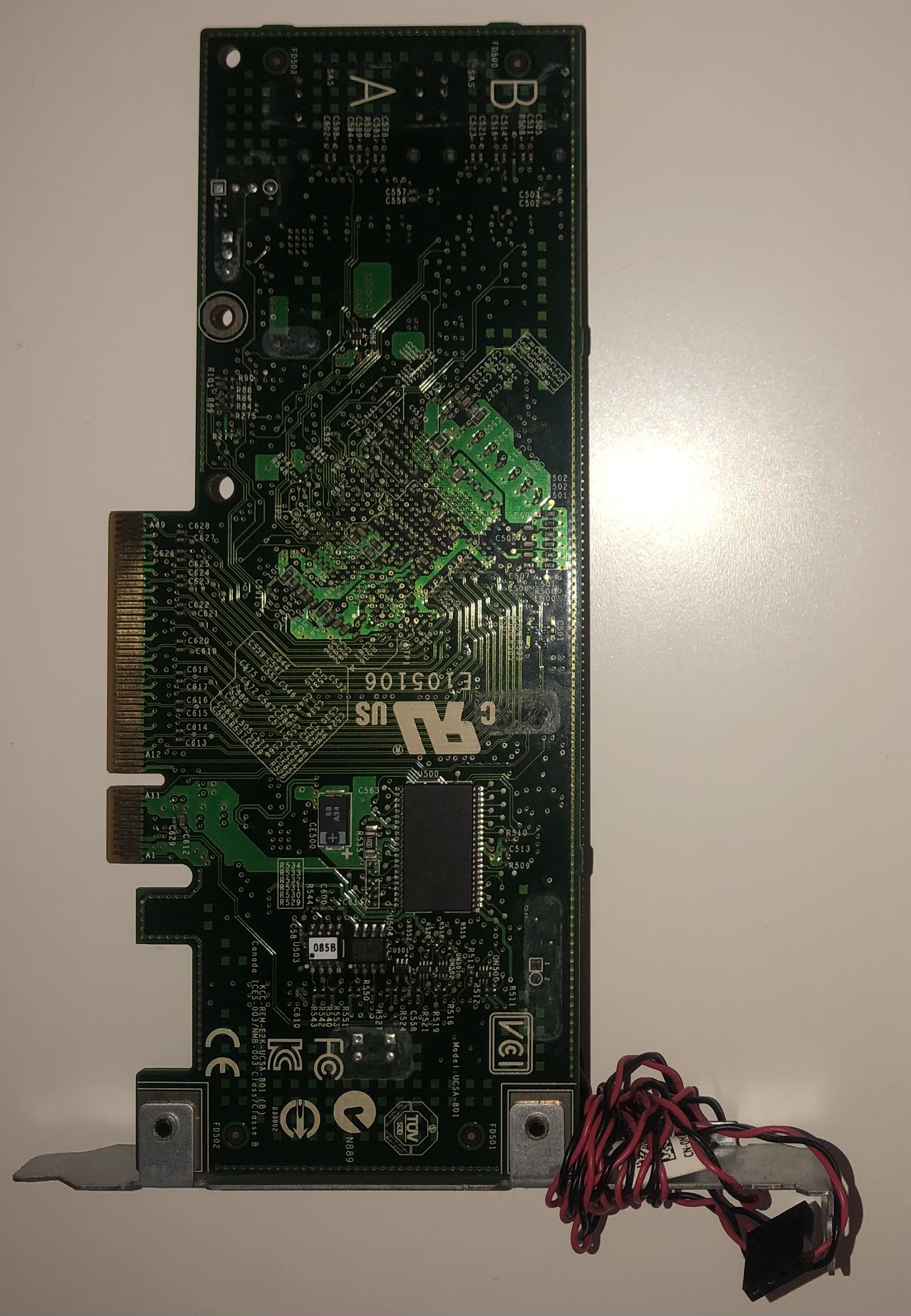

Hi, I bought an old Fujitsu Primergy TX200 S6, in the server there was 3 PCIe card.
One of the 3 is this PCIe SAS controller, but I don’t know anything about it. (on the back it’s visible a model: UCSA-801)
Anyone know this card or know how to flash to it the firmware (IT Mode) for make it a HBA?
Thank you

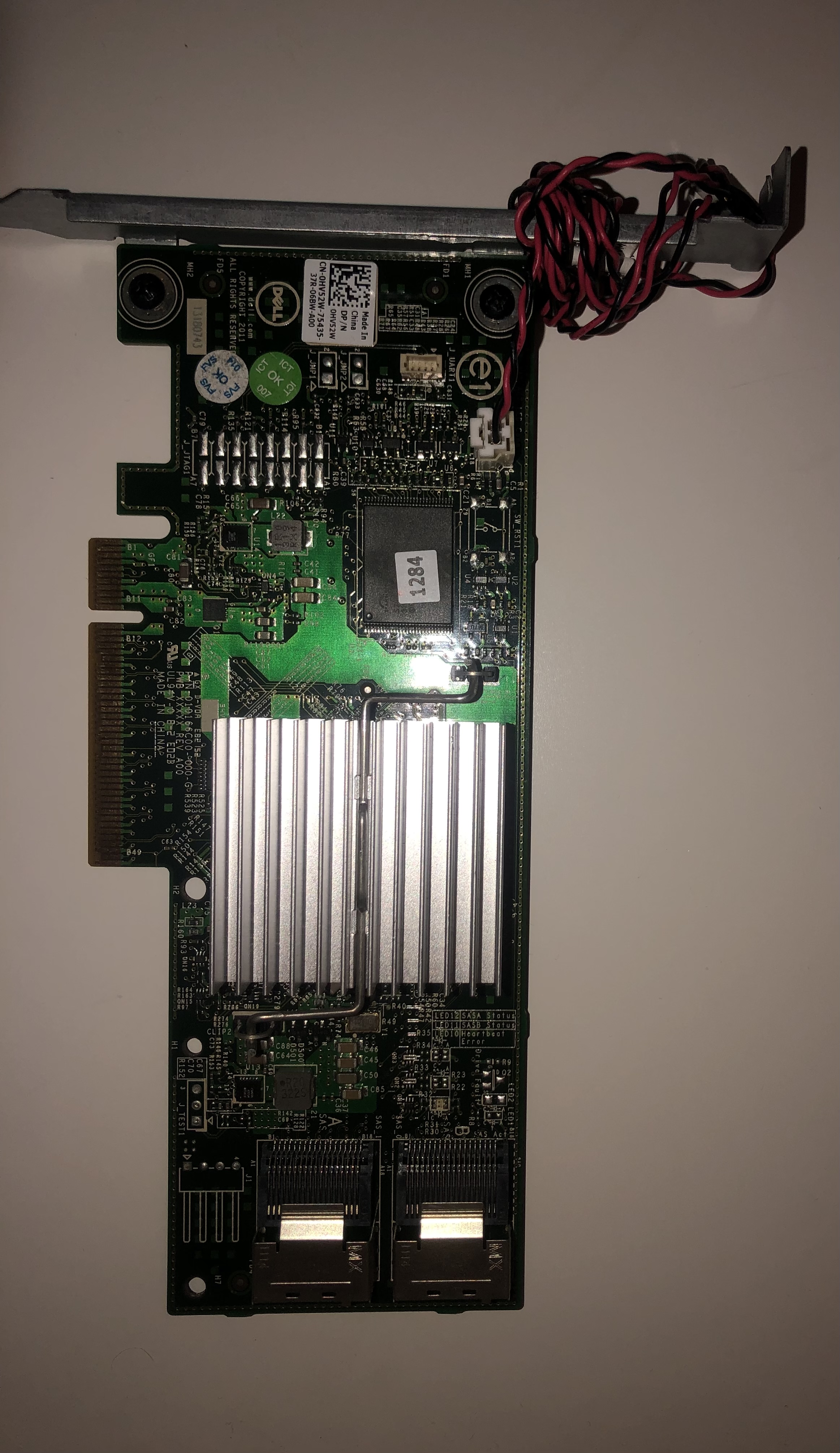

I believe its Dell Perc 310 should be able to flash to it mode if not already https://www.sanderh.dev/flashing-your-Dell-Perc-to-IT-firmware/
Really thank you, you know what is the red and black cable?
From what I can find it is to connect the Card to the motherboard so the HDD LED shows activity, but I think it is for specifc dell motherboards
Ok, thanks
So no hdd light, but it’s not my priority
