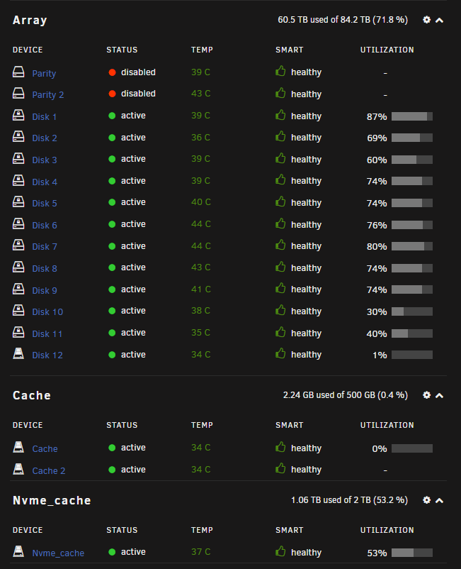

- All the disks have green thumbs up on the dashboard (see screenshot)
- I shut down the server, opened it, checked all the connections, moved the harddrives away from the motherboard SATA connection onto a PCi card (no room to move cache drives too), rebooted and started the array.
The cache drives have fixed themselves, the parity drives seem to still have the same issue.
No, they are not disconnected, just disabled, and will be until rebuilt.

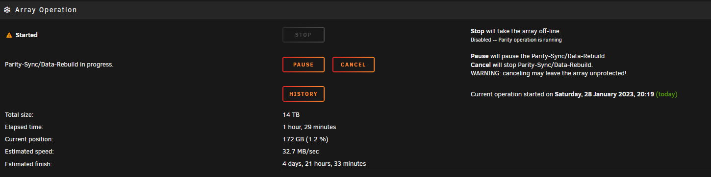

The parity is being rebuilt at roughly 32MB/sec and is expected to last another 4 days and 20 hours.
I will then start a manual parity check, which also lasts 3-4 days.
That's about 1/4 the speed I get and I know many others get as much or better. Probably these controllers are to blame:

Looks like both parity are on that first Marvell, so also possibly the reason those disks are getting dropped.
