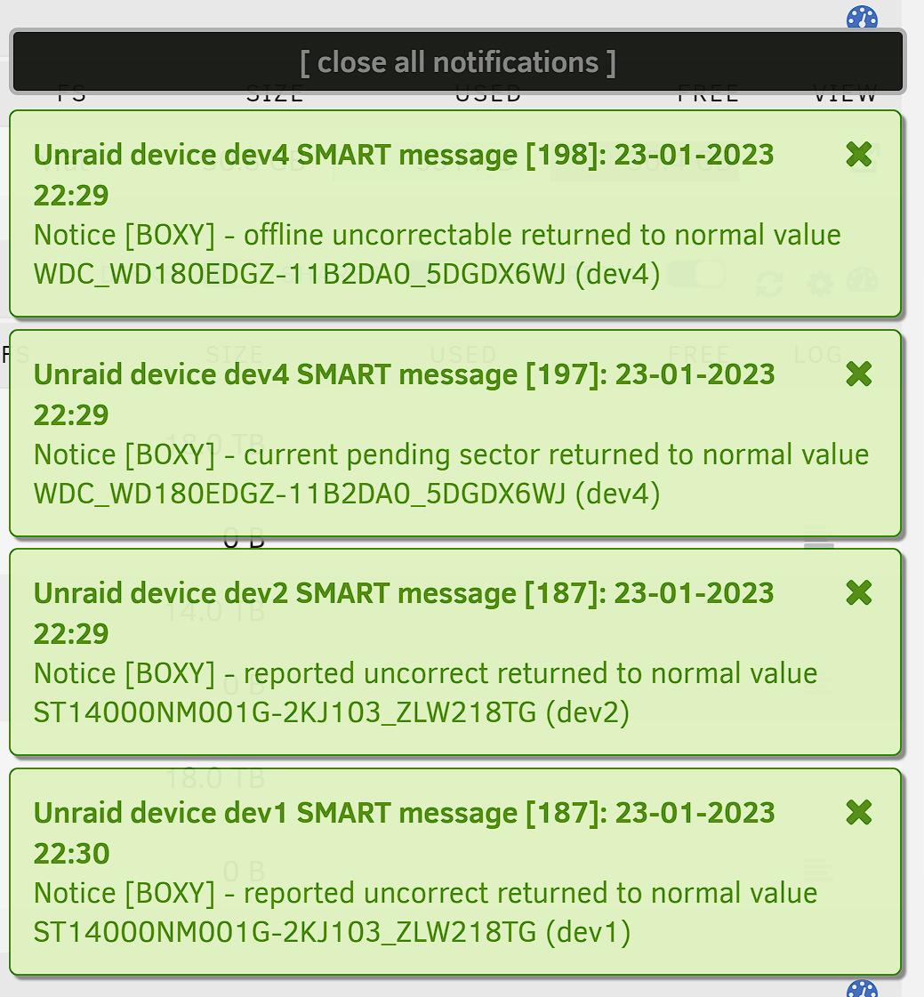

Hey! This (or something very similar) just happened to me a few days ago!
Initially I had:
Parity Drive - Seagate 14TB
Data Drive 1 - Western Digital 8TB
Data Drive 2 - Western Digital 8TB
I bought 3 x Western Digital 18TB, my idea was to replace the 14TB drive with one Western Digital 18TB drive, then add the 2 remaining Western Digital 18TB and the old Seagate 14TB drive to the array. It's not related to this but my next planned step was to move all data from the 8TB drives to the new free space in the drive, then replace them with 2 Western Digital 12TB drives I have around, but that's another story for another topic I was planning to create.
With all disks in the system, I precleared all three Western Digital 18TB as usual. Then I stopped the array, removed the 14TB from it (not physically from the machine), added one of the Western Digital 18TB drives as the new Parity Drive, then started the array.
My heart skipped a beat when I suddenly was notified of this:
Those two disks were perfect, I checked the SMART logs to see if anything had changed but no errors there. I even did a short and long SMART tests on both drives (after parity was rebuilt) and no error was found.
Not sure why this happened, it seems to be an error due to "hot swapping" devices, the system might have been confused with old/trash/"dirty" SMART data lying around for those devices. I'm including diagnostics just in case it helps.
boxy-diagnostics-20230130-2308.zip
