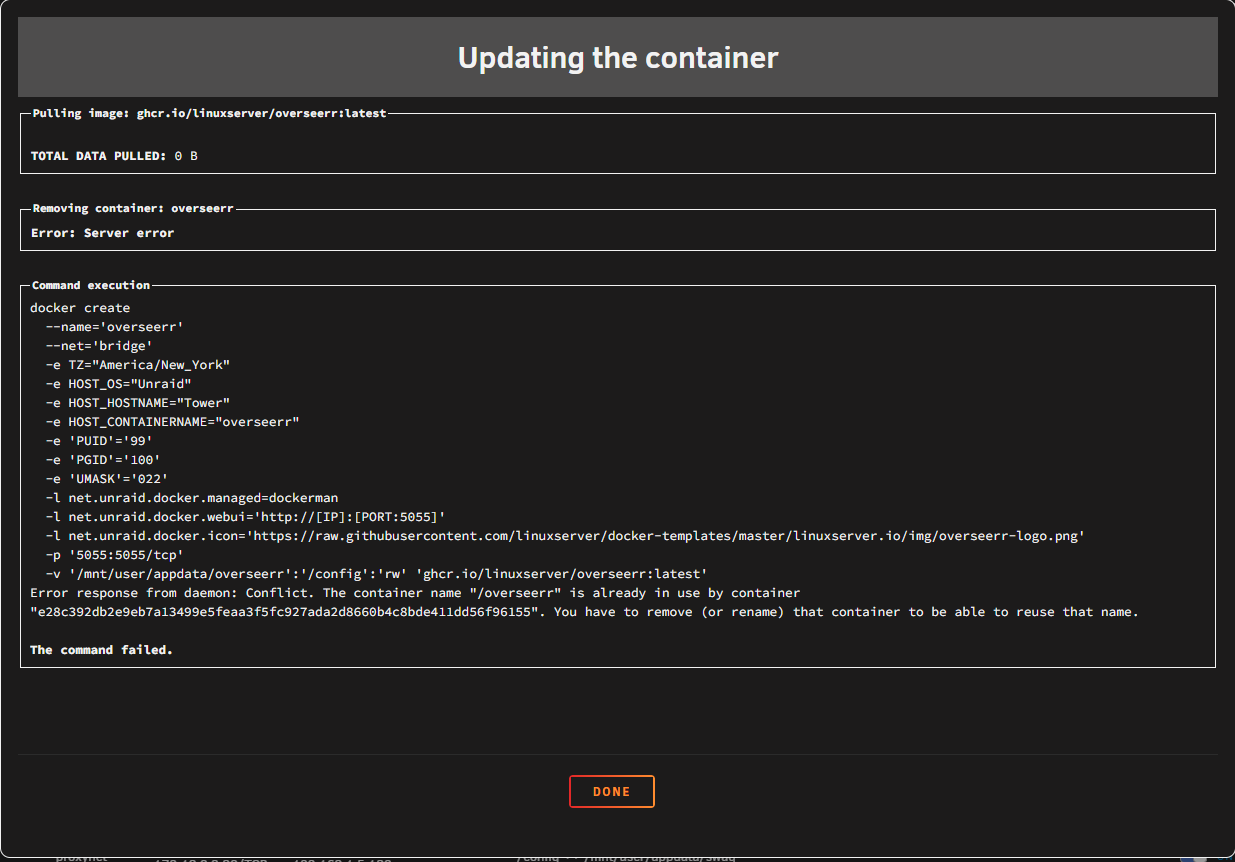

Could not update Docker. Error message Conflict the container name is already in use by container
I was doing some regular updating this morning and I stumbled upon this error this morning. Normally I check to see what needed to be updated and then take care of it.
I was trying to get a docker updated when I got this message.
Diags also included.
Thanks in advance.

I suddenly am unable to Unable to Update, Modify, or Delete Docker containers.
No recent system updates/changes to correlate it with.
"Error response from daemon: Conflict. The container name "movies" is already in use by container "7b9c21616f4b5619fdb54690c9ae378067f7d6e2815e0a0e71123d2bc6ab38b2". You have to remove (or rename) that container to be able to reuse that name."
The container ID correlates with the existing container that I am trying to update.  I see no orphaned containers.
I have found other threads suggesting to delete the docker.img and recreate all containers.  Before doing so, I was hoping you brilliant ladies and gentlemen could look at my diagnostics to see if there is another route to take.
Diagnostics attached.
tower-diagnostics-20240502-2218.zip
