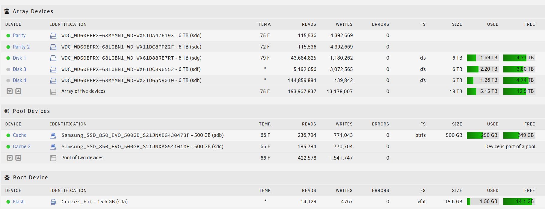

I am in the process of tidying things up on my server and this is one of the last things I am considering harmonizing. My array is pretty old (some disks 7 years) and some of these settings were done when I first started. I have 3 data disks (2 old, one fairly new), 2 parity (1 old, 1 new) and two cache drives (both old). See attached.

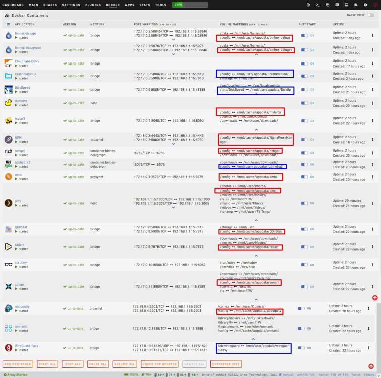

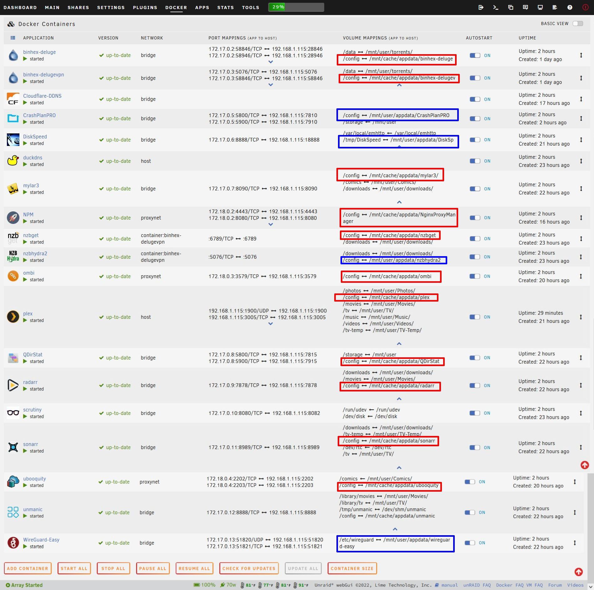

I run 19 dockers (screenshot attached):
  • 12 are using /mnt/cache/appdate
  • 4 are using /mnt/user/appdata
  • 3 do not have a config file

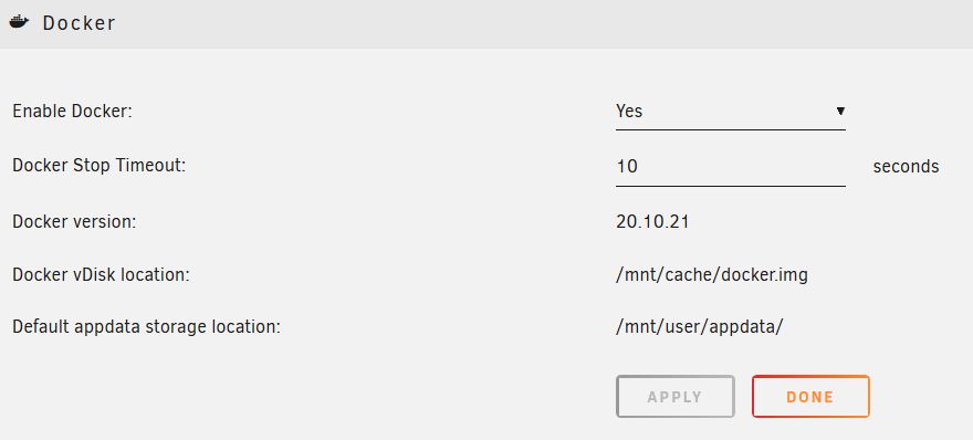

My docker setup defaults to /mnt/user/appdata (see atatched)

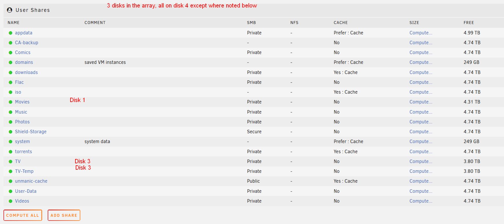

My shares are attached. Appdata is set to "Prefer : Cache". All shares are on DIsk 4 except for TV+TV_Share (Disk 3) and Movies (Disk 1).  (see attached)

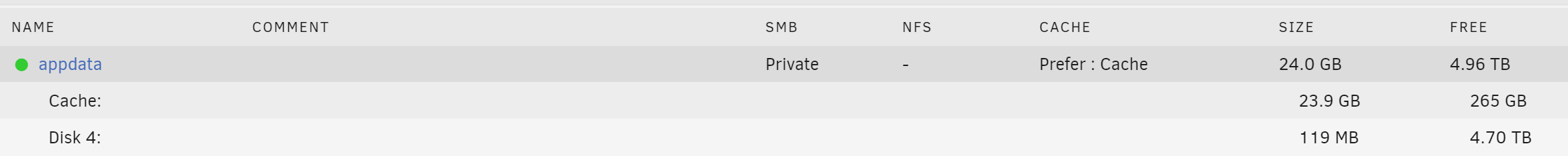

Go to shares and click compute for appdata, if all of it is on cache you can change everything to /mnt/cache, there won't be any disadvantages and with some containers can perform better.

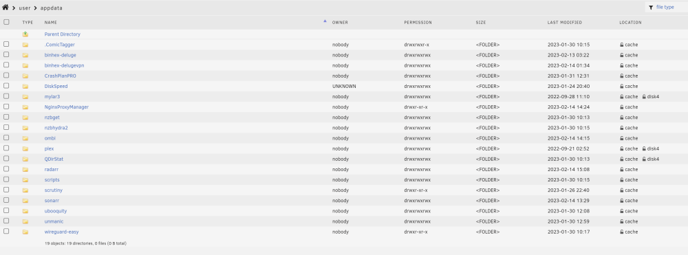

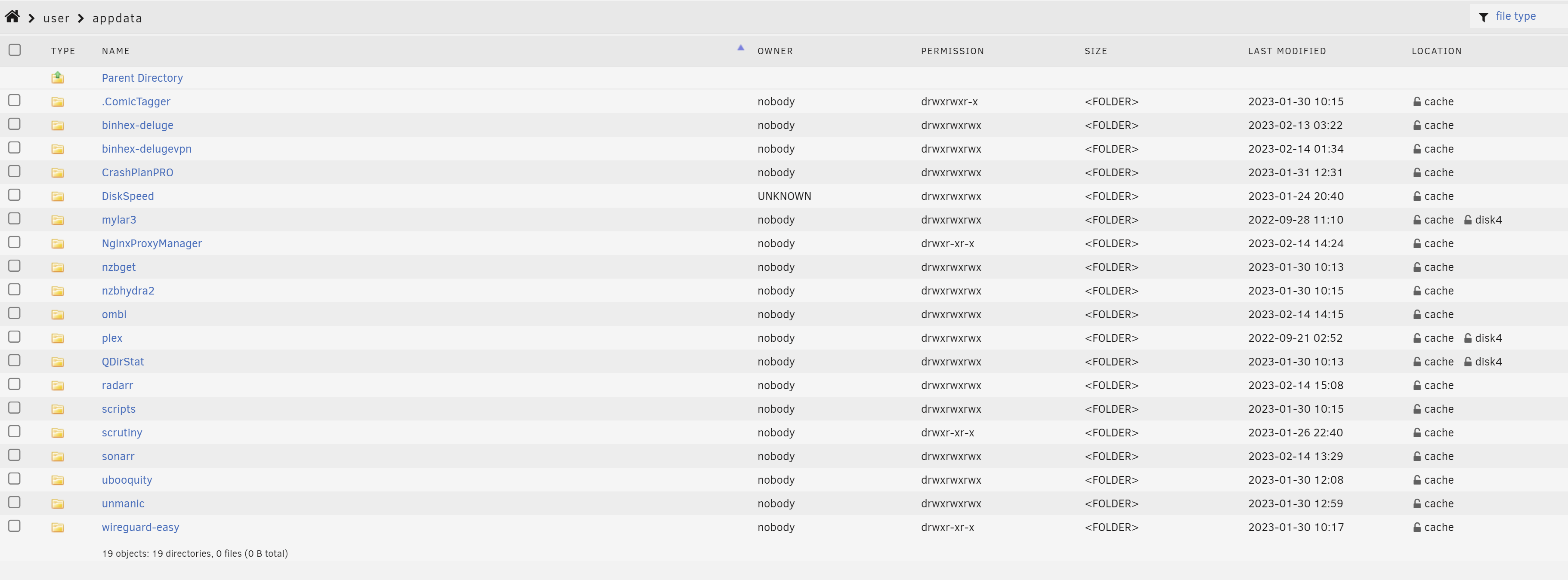

Thank you! There is a tiny bit on Disk 4...
Can I do the following:
1) Stop the three dockers
2) Move the appdata from disk4 to cache
3) Edit three dockers, change them to use cache.
4) Start dockers?
Or is there a better way?
It is weird as the three dockers (mylar3, plex and QDirSTat) should be using cache? Maybe that is old stuff?

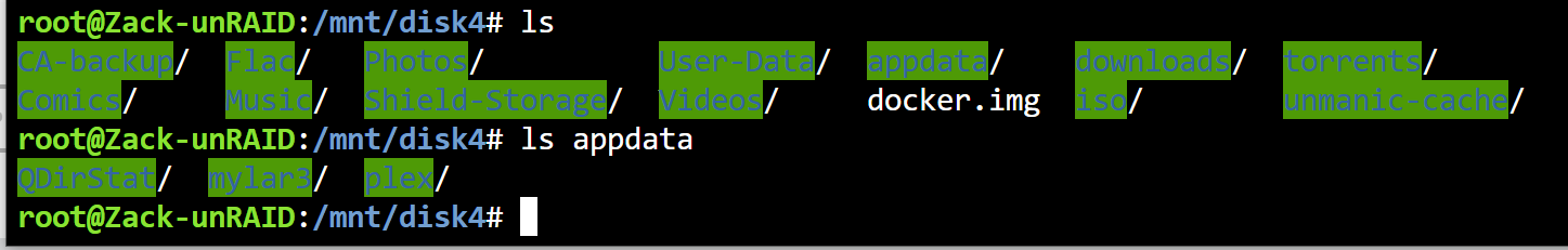

Another option, and since appdata is already set to cache=prefer, you just need to stop those containers and run the mover.
All the stuff on disk 4 was old. I just backed it up (actually renamed it OLD) just in case. Turned off dockers, updated config info, and all seems to be working.
