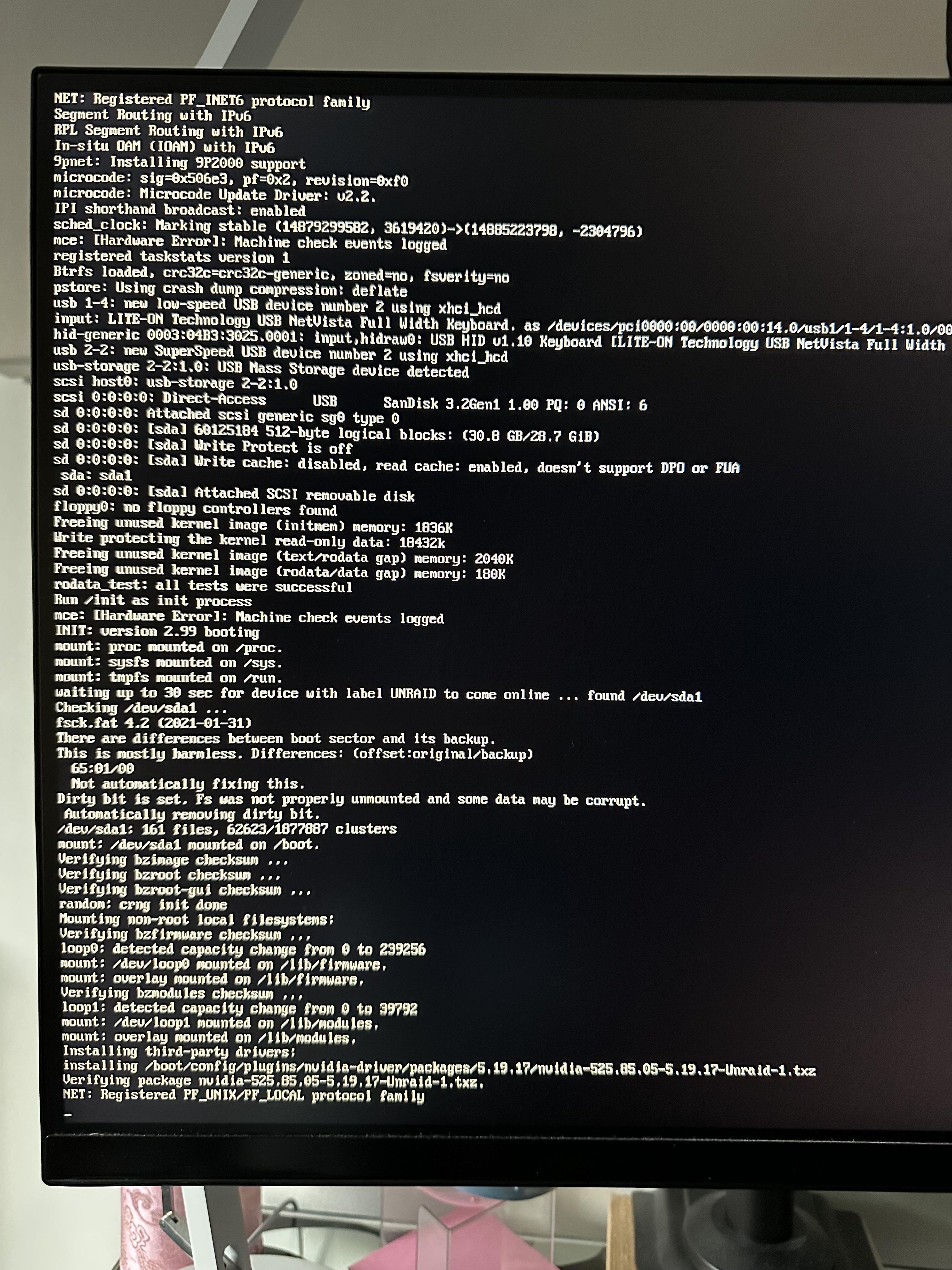

But 2 days ago I noticed that the array was not started for some reason. I started it manually. Next day the server was offline. I tried to restart it manually with the press of the button on the pc case and when it did nothing i unplug it from wall and replug it. But still it was offline. Than i connected the display to see what is going on and realized that it was stuck in a boot loop.
It gives me this message (sorry for picture but i dont know where to find logs or how to find them)

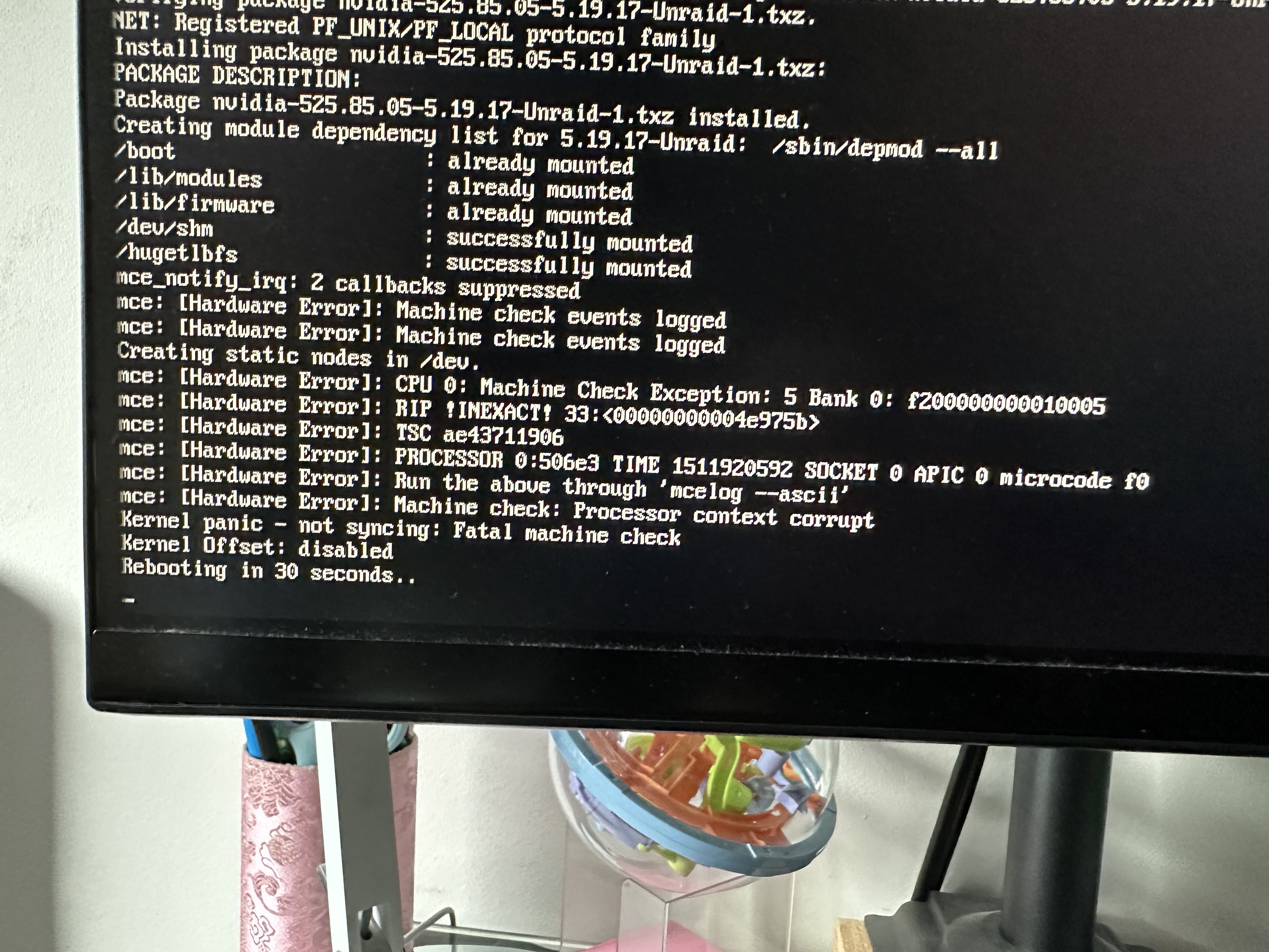

I also took picture with more of the lines of text.

Solved by JorgeB
That looks like a hardware problem, possibly the CPU.
I am no expert but how can be CPU problem if it is working in windows?
Will try to get another i5 6500 and test it.

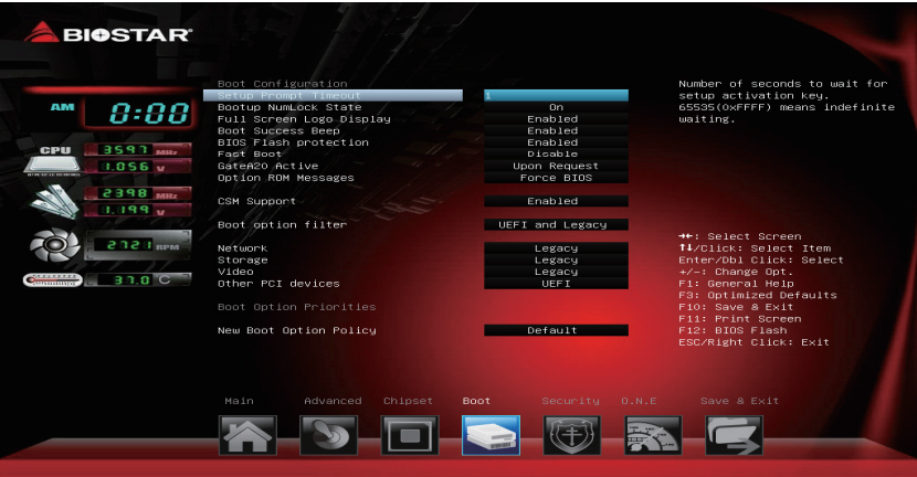

I do not know how i was able to boot w/o monitor before. I am looking in bios but i do not find anything. (keep in mind that i perform cmos clear)
If you have any experience regarding this topic to would really appreciate the help.

One more question, is there a special settings in Unraid for running in headless mode that i need to turn on?
Does UEFI have an impact for this? I know that i rename  efi~ to efi on usb stick.
Do i need to change some settings here? or how to set up settings.
