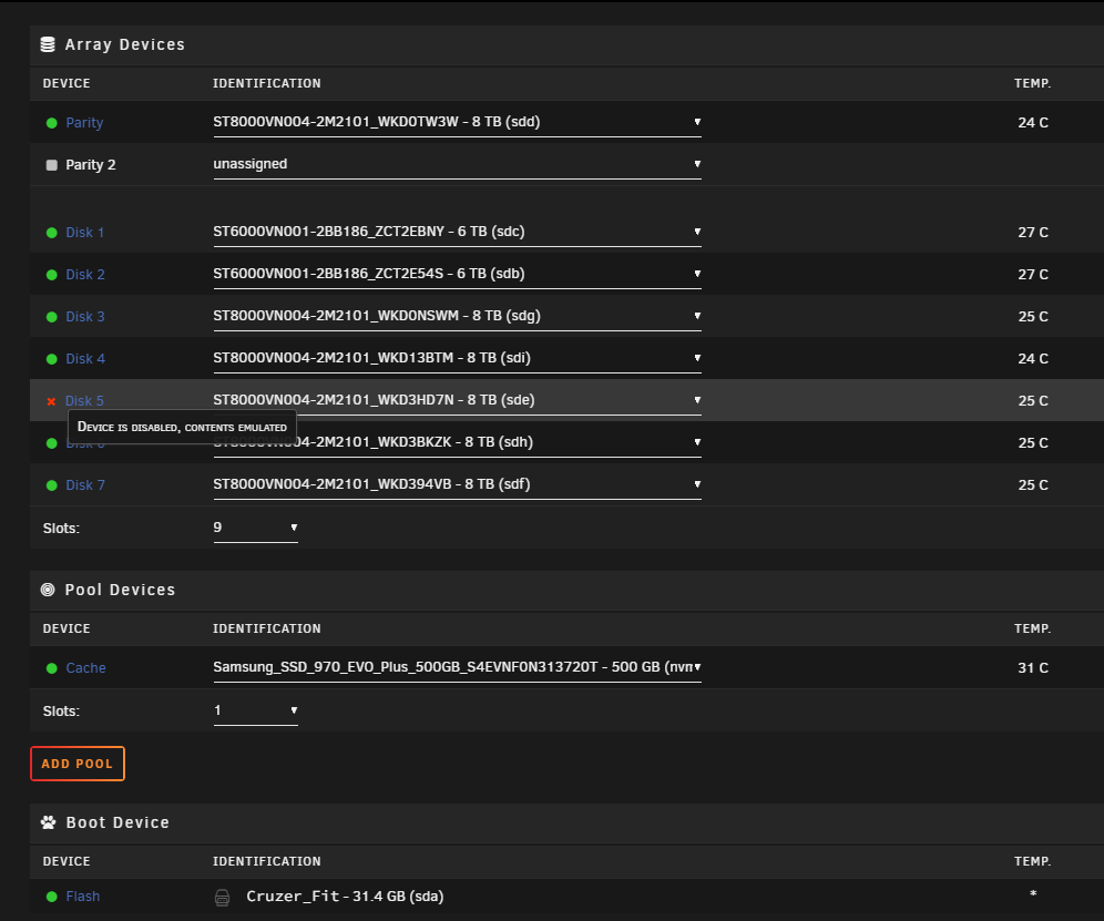

Hello,

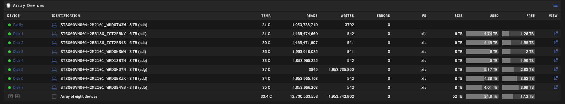

Got a couple of emails this morning from my server to say a Disk had errors. It's been quite a while since the last time I had any errors so I was a little unsure what to do and am looking for some guidance.
Here is the first email around 5:30am (Mover starts at 5am)
Event: Unraid array errors
Subject: Warning [TOWER] - array has errors
Description: Array has 1 disk with read errors
Importance: warning
Disk 5 - ST8000VN004-2M2101_WKD3HD7N (sde) (errors 2048)
Then here is the second email around 10:00am
Event: Unraid Disk 5 SMART health [5]
Subject: Warning [TOWER] - reallocated sector ct is 8
Description: ST8000VN004-2M2101_WKD3HD7N (sde)
Importance: warning
I had downloaded a couple hundred GB of stuff yesterday and when the mover ran overnight, only this specific drive had any writes to it from mover, so I think the error count came from mover.
Now this is where I potentially made a mistake that I will regret. I had noticed a whole bunch of my stuff I downloaded had not been properly moved across folders by Lidarr and were "stuck" in a completed downloads folder. I knew a bunch of the files were not very important to me and so I stupidly went into Windows explorer to my network share of unRAID and simply deleted the files from this completed downloads folder that were not being moved. It was probably around 300GB of files.
I realised as soon as it started deleting the files that I probably should not have touched any data...but what's done is done I suppose.
I have taken a diagnostics snapshot from before I restarted the server, then after. And also ran a SMART short test before and after, and also took SMART downloads. (I'm still not actually sure how I check a SMART short test. I run it and it says some % progress and then says done, but where do I find the test?)
I turned the server off, changed the SATA cable over on the drive from my motherboard to my LSI SAS card, and when I turned the server back on the disk was disabled still but this time it now says udma CRC Error count 70. (which it also emailed me about)
Should not be a problem.
Disk is probably fine for now, you might run an extended SMART self-test on it.
Emulated disk5 was mounted in those first diagnostics so that should be OK too after you rebuild. Array not started in the later diagnostics so can't see anything about your filesystems or shares in those.
Your configuration looks good.
Syslog looks like it was just a bad connection on disk5

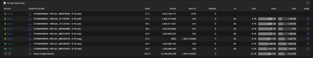

Okay thanks. So I should run that before trying to start the array? Or would it be better to start the Array and then run the Extended test?
And then after I run the extended test I should run a rebuild? how do I do that exactly? Do I start the array in maintenance mode or something
If you don't mind having your array down you could do the test first.
It will take many hours
That's fine, as long as it's not going to be more beneficial to run with the array off or on. I'll just do it with it off.
I'll report back once it's complete.

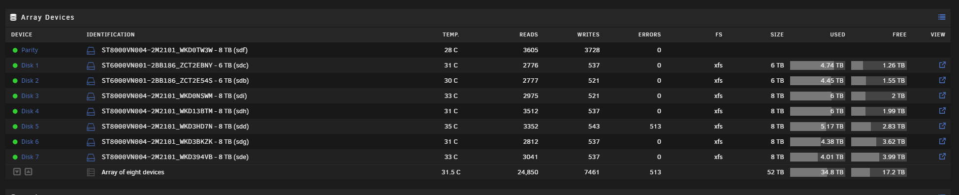

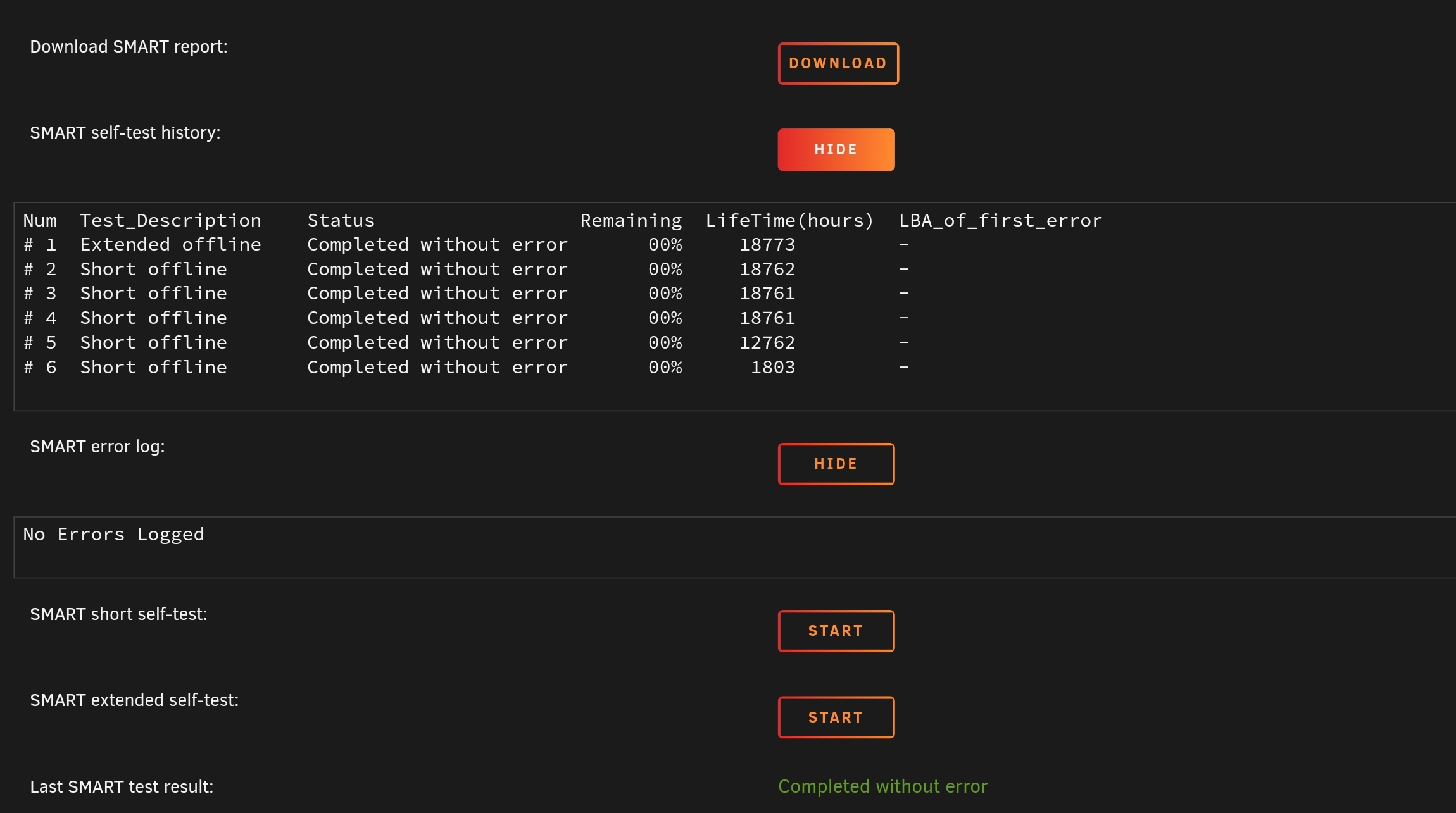

Well you were definitely right about that. It just finished without error. I don't know if I'm supposed to upload the smart report too or diagnostics log but I guess I'll do it just in case.
Been a long while since I had to rebuild a drive. I think I put it in maintenance mode to do it. I'll figure it out.
Will update thread tomorrow with results.
tower-smart-20230202-0007.zip tower-diagnostics-20230202-0013.zip

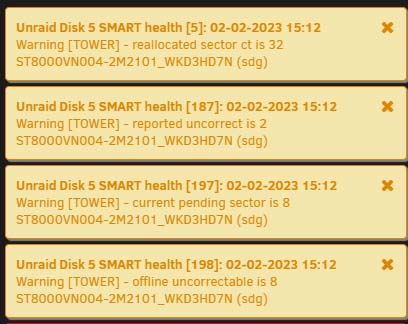

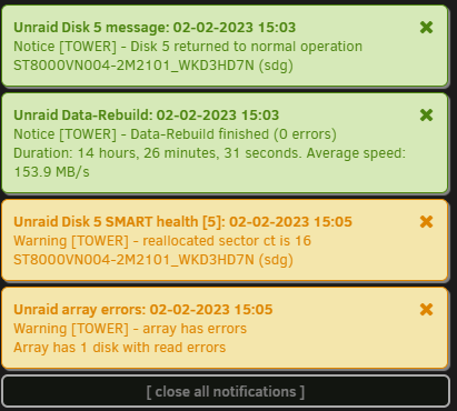

14 hours ago, trurl said:
Rebuild finally finished. However the reallocated sector ct has seemingly gone up from 8 to 16.
Attached latest diagnostics.
Thoughts on what to do? Is this just the system "catching up" on errors after doing the rebuild or am I likely to see these errors continue to increase?
Thanks
tower-diagnostics-20230202-1507.zip
Edited by Neejrow
Errors seem to be increasing.
Also here is the latest smart report.
Number of Reallocated Logical Sectors = 40
So gone from 8, to 16, to 32, to 40.
Am I likely to be needing to replace this drive? I'll power off and try another SATA cable.
tower-smart-20230202-1521.zip

Fix Common Problems plugin also said | If the disk has not been disabled, then Unraid has successfully rewritten the contents of the offending sectors back to the hard drive.
I'm about to try skimming through a bunch of media files on Disk 5 to see if any more errors happen.
If it keeps going up yes, you can run an extended SMART test for now.
The errors have not increased in unRAID main tab, and no further warnings. I also done a comparison between a new SMART report and one from hours ago and the uncorrectable errors and reallocated sectors have not increased either. I am now running the Extended smart self-test again. And have re-enabled Mover to run again overnight, and it should write data to that drive at some point so will see if the errors increase and will report back tomorrow.
Thanks for all the help so far, I appreciate it!
Unraid reported the extended self test failed and to read smart report. I have attached it.
Said something in the report about failed read at 30%
So does this mean I should replace the drive? It's under warranty still.
tower-smart-20230203-0654.zip
Num  Test_Description    Status                  Remaining  LifeTime(hours)  LBA_of_first_error
# 1  Extended offline    Completed: read failure       30%     18804         13059870608
Replace

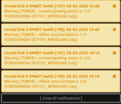

@trurl I just put in a new replacement drive and I am getting this.
It's only 12% of the way through the parity rebuild.
Any thoughts? Could this be a faulty drive or could this be related to the SATA data cable or something.
SMART report attached of the new drive
tower-smart-20230205-1611.zip
Offline Uncorrectable errors went up to 136 by 19% of the rebuild. I decided it was best to cancel the rebuild and power down. Change over to another SATA data cable and different sata port on my motherboard and see what happens when I try again. When I powered the system on again it said the errors were actually 225. I'll post the latest SMART report from after I powered down and changed cable. I'm kind of hoping that maybe it was just faulty cables after all and the original drive might be fine? I don't know how to read SMART reports properly though so I could be wrong on that!
I have ordered some new SATA data cables to come tomorrow, but fingers crossed on this 3rd cable being okay?
Rebuild is currently beginning again.
tower-smart-20230205-1736.zip
Cancelled the rebuild for 2nd time as it had errors again.
Swapped to a 4th SATA data cable, and then swapped the cable with a different drive from my LSI SAS card which I know has been running fine.
Tried to run an Extended self-test on the new drive and it failed within 10 minutes.
