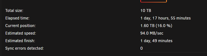

EDIT -> This is a little weird.  It's been stuck in it's parity check for over a day with no movement.  I can't cancel it or pause it.  It's also weird that it shows 0 sync errors.  All the drives are still showing as spun up but the parity check is stuck.
