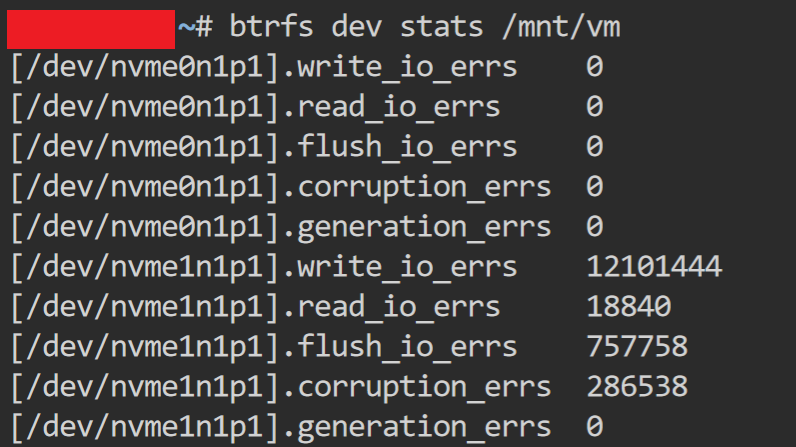

To preface this I am fairly new to Unraid, so apologies if my explanation is not super clear. A few months ago, I logged into the web GUI to see thousands of messages saying "BTRFS missing devices /dev/nvme0n1". I ran 'btrfs dev stats' on /dev/nvme0n1p1 to get the following:

Pool devices are not in the parity array so you can't rebuild from parity..
I assume they are unmountable because you haven't formatted them yet, but of course they will be empty then.
Do you still have the original disks? Were they mountable before you removed them?
Here is the wiki related to replacing pool disks.
https://wiki.unraid.net/Manual/Storage_Management#Replace_a_disk_in_a_pool
Probably what we will need to see is the diagnostics with the original disks assigned and the array started.
Don't do anything without further advice.
